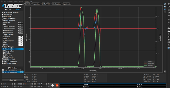

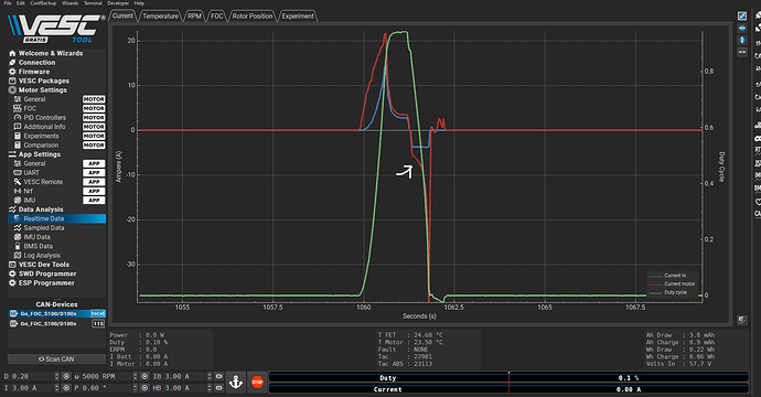

Still trying to get my SKP motors set up and running into another new problem this time with braking.
Was testing them out today and found that when I am moving at high speed and try to brake, I only get about -20A no matter how far I hold my throttle wheel back until I hit roughly ~15mph and then the negative amps will start to correctly scale to how far my potentiometer is held back.
This makes for very soft braking when I am at high speed so I hold the wheel back more, then when I get down to 15mph the wheels essentially lock up, throwing me off.
Here are my Vesc tool settings for current and throttle curve. Anyone run into this problem? Any settings I am missing here?
I caught this happening in some RT data logs.
I throttled up to max speed and pulled back all the way on the throttle wheel. Where the white arrow is pointing you can see it stays at very low braking amps for a bit before it fully brakes.
the batt current max regen of -5A looks suspect but i could be mistaken. glad you didnt get hurt with little brakes :sweat_smile:

Damn dude I think you got it, just changed it to -15amps and the braking amps look nice and linear now. My only thing is I really don’t want to be sending 15+ amps back into my battery as to not decrease its overall life. Am I being paranoid? or is there a way to have normal braking and also not send tons of amps into my pack?
Short answer: probably yeah, a bit. (Battery dependent)
Long answer: charge limits for cells are set under the expectation of sitting at that current for much longer durations of time compared to the Regen braking we get on an esk8. While a molicel P42A can be charged at 4.2a for an hour straight without substantially damaging the cells according to their data sheet, they are likely to take substantially more during short bursts.
As far as I know we don’t necessarily have a great deal of data for just HOW much damage we do during short bursts of high Regen, but I’m under the impression it’s a substantially higher threshold for damage during 3-10 seconds of hard breaking than it is for an hour of charging.
I appreciate the explanation I didn’t know all that. I’m using a p45b 16S4P pack, on Molicel’s site it lists its max charge current at 13.5amps but I guess that’s continuous.
Do you have a recommendation for the current regen setting I choose here? What do you use if you don’t mind me asking?
Kinda yeah, however molicel’s max charge ratings are generally determined using a temperature limit and having that monitored and current being throttled back when the cell reaches that temp. Still for a longer period of time than Regen braking but not a ā€œtrue continuousā€ rating.
There’s also some math you gotta do here to get a good idea of limits, since we know that 13.5a is safe for the cells over a much longer duration than 10 seconds we can use that as a surefire safe limit per cell. And since whatever current you put into the battery will be distributed over each group of 4 cells in parallel you can multiply that current by 4. But still have to divide it by 2 again when considering you have 1 battery powering 2 motors/speed controllers.
13.5a x 4p =54a
54a / 2 motors = 27a per motor,
If braking power is still lacking I suspect you can bump those up a bit more but I would recommend talking to somebody who knows more than me before doing that.
I have a 12s7p and I think I’m running 30a/side, admittedly I can’t confidently remember, but I believe it’s between 4-10a/cell in parallel
Went ahead and set it to -25 a/side and it works well. Thanks for the help!
