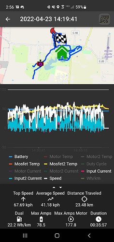

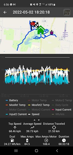

What sorts of comfortable cruising speeds are you guys averaging on pavement vs a crushed limestone bike path?
Pavement usually in the high 30s low 40s
Loose surface under 25 usually
Gang gang.
I hate and love that crushed limestone stuff. It’s fun to slide around a bit and keeps you on your toes but can get squirrely so I keep it lower on that stuff.

I go 25kph avg, max 30ish kph and it feels like a lot. Idk how y’all go 30mph+ (50kph) :exploding_head: I’m a noob :joy:
Yeahhh I thought it would wear off faster but I’m still spending most of my time around 25-30 as well. I have gone faster but I’m topping out at 40 at a stretch and that is absolutely not comfortable. Coming to accept it to be honest, it’s a bit like having a low alcohol tolerance because it just means I’m a cheap date (or to bring the questionable metaphor back to earth; I’m happy on a cheaper board)
One thing I can say is I’ve never fallen :grin::raised_hands:
Ey, i go 22 kmph max. (Norway laws). I once went 45 kmph uphill, and it was FUN. Can understand why people like more speed. But i’m not gonna risk getting my board confiskated.

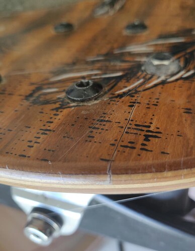

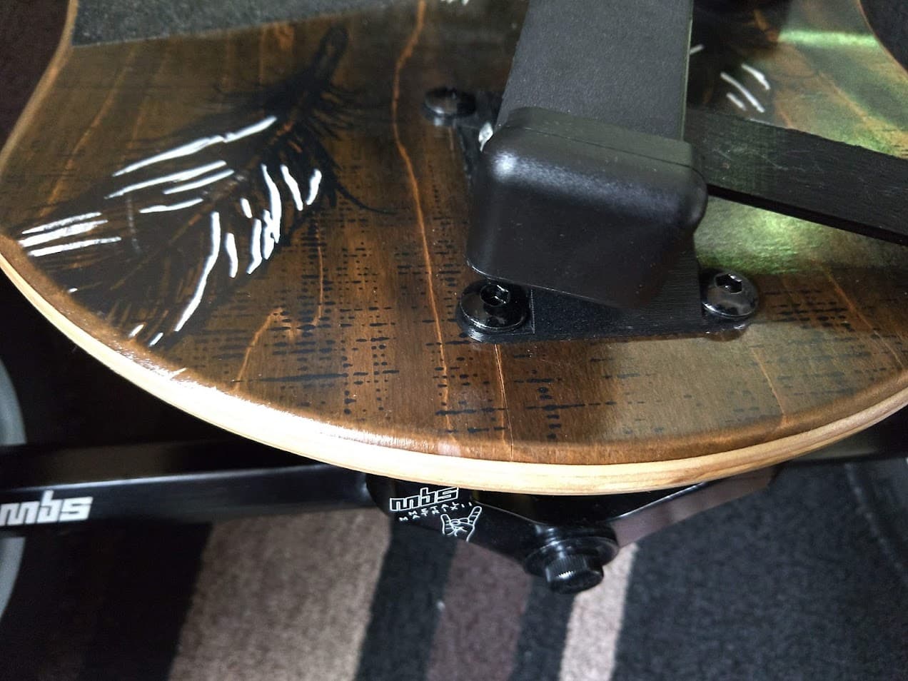

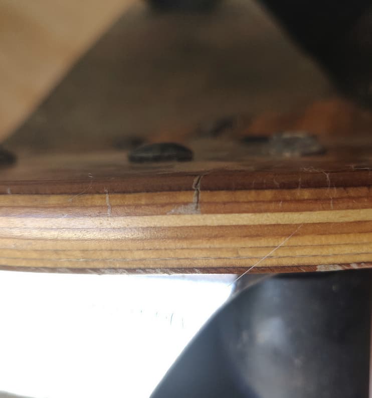

Noticed some hairline cracks starting to form on two of the bolt holes on my board. They only look like they’re on the first ply so I’m not too worried about them, but what could have caused them? Too tight/loose hardware? They’ve got something to spread out the load on both the top and bottom, and the deck hasn’t hit anything. It’s also only on the right side too, the holes on the left are fine.
:fist_right::wood:
welcome to the club
What trucks are those? I’m kind of confused why there would be stress there in the first place, since aren’t those where the preload adjustment screws are?
