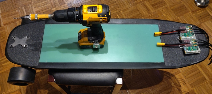

alrighty, got the lid “mated” to the deck… let’s just say the cutout ain’t a rectangle so my rectangle lid needed some shaving😐
inserts, inserted (only had 4 left of the size I need😕)
Game-on Max, that’s coming together nice.
I have the single stack and regret is real spacewise, wanna use it if I get a shot at a stormcore. Thinking of printing 3D riser with slanted sides and rounded corners just enough to double down on
I’ll get the ESCapes installed tomorrow, it’s ready enough for a ride

MR60 installed, once the epoxy sets will install ESCapes and solder phase leads
Those connectors are great for phases

FET side is silicone potted
no escape for the ESCapes now
