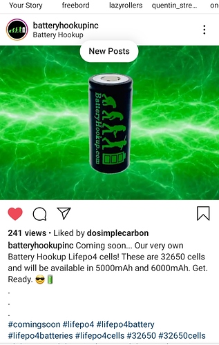

Thoughts?

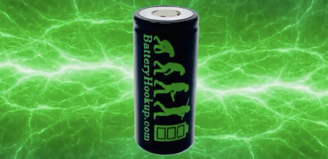

It’s like the lifepo4 version of the QB26800. Should fit in a hummie w/ a dbl stack encl, 14S2P w/ any reasonable room for other electronics. I’ll bet the discharge is not great, but you’d need 4 or 5p m1a/b cells to get this capacity.
Yikes that is huge, I dont think these could ever be double stacked lol
32mm, that’s a soda can of a battery :sweat_smile:
Almost as tall as a rectangular double stack of 18650 and 50% more volume than a 26650
That said, a good bit more power dense than the ANR26650M1B’s 2500mAh. Wonder if there’s a significant hit to discharge in the balance.
$4 A CELL WHATCHA THINK AB0YT 9THAT
They are soooooo big :flushed::flushed: I wish they were closer to the QB26800 size. I dont think this us usable in esk8. But if space is not a restriction, dang it’s a great cell!
BRUG IMAGINE A 22S1p WIT A STOMCORE OH FUCK THEY ARE 18a CELLS NVM
18a at 22s lifepo4 is still quite a bit of power! Plus looks like they can handle 60A for 10 seconds that’s really good
NOMINAL VOLTAGE: 3.2V
CAPACITY: 6000MAH
WATT HOURS: 19.2WH
FULLY CHARGED VOLTAGE: 3.65V
FULLY DISCHARGED VOLTAGE: 2.5V
MAX CONTINUOUS CHARGE: 6A (1C)
MAX CONTINUOUS DISCHARGE: 18A (3C)
MAX PULSE DISCHARGE (10 SECONDS): 60A (10C)
OH 60A PULSE DOE

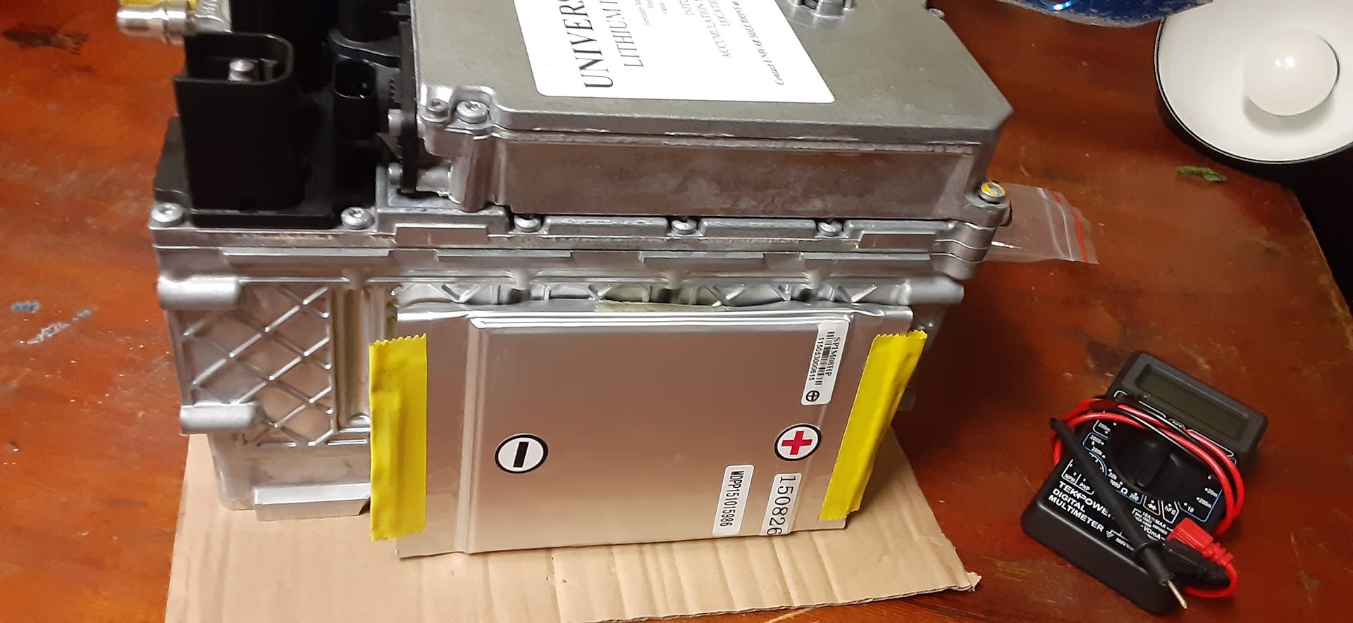

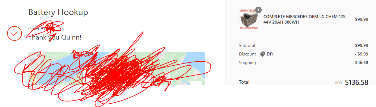

@Davewesh my only smart BMS is going in that thing ^^^ it’s also my replacement for the spim08hp pack while I’m not sure whether I want to make more 12S1P’s or whatever due to the issues.
Really excited to try out the bluetooth BMS and this battery is going to be pretty sick :sunglasses:
