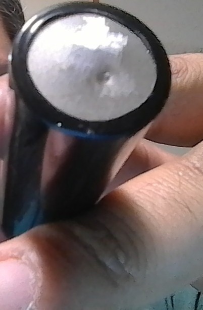

I smell gas, the CID button popped, and there’s discharged material around the positive side. My shrink‑wrap is clear, so I can see the cells without opening anything—that’s how I know. Since it’s a 12s pack, Series Group 6 is the one that got messed up. I didn’t know about this at first, but after doing some research I found out the CID actually disconnected inside the cell. It wouldn’t charge with my charger—I even tried forcing it, and nothing happened. That’s how I knew the cell was done. I’m starting to wonder if the gas had been building up from charging at 9 amps before I ride.
Alright, I’ll keep the config the same. I guess I’ll just wait until the battery starts dying or the performance drops. I only wanted to change it because I’m trying to get close to a 60‑mile range. Right now I get 54 miles, which isn’t bad. I just want the best setup. I also wanted to keep up with my friend’s bike since he’s got crazy range. Besides that, is this cell still good even with the dent?

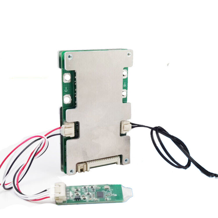

I had to remove everything because my BMS wouldn’t let me charge from 2.6 V. On top of that, the BMS was still linked to my old phone, so I couldn’t change any of the settings. I was told to disconnect it for a while so it would reset and let me pair it with my new phone. I haven’t tried it yet. I should’ve set that up properly on the BMS from the start.
Update: I think my Bluetooth module is mess up too.lol Maybe that’s why I couldn’t connect it. Oh well.
Im using this.
I would say don’t use dented cells, look up some cell xray pics and you’ll see why - there is a lot going on inside a cell and there isn’t any way to dent a cell without doing some kind of damage. Especially in a high draw pack.
