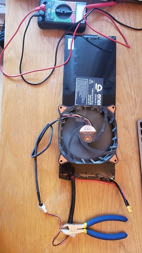

Trying to discharge packs individually to get 3.6V on each pack. I got a thinner BMS on charge only (like the old BMS on the raptor). GOnna plug everything after to see if it charge more than 55%.

Using the fan like that should discharge the P groups, but maybe connecting a BMS would be a safer way to do it. I don’t know how much current that fan is drawing.

Well, thanks for your answers guys. My last hope is to discharge this battery with the fan but it’s freaking long. Otherwise, I will rebuild a new battery. Gonna put that operation on the balcony just in case but on 4 month, it never get hot so… I suppose I’m lucky.

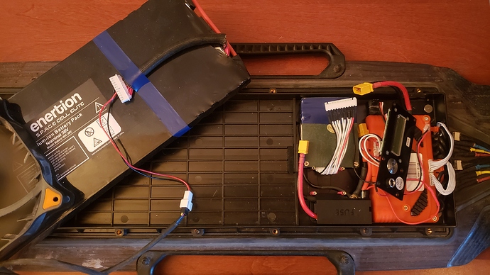

Somebody know how my battery could be at 42V (10S4P) but the screen indicate 55% of battery?
Wrong battery gauge. You probably have a 12s meter measuring your 10s fully charged voltage

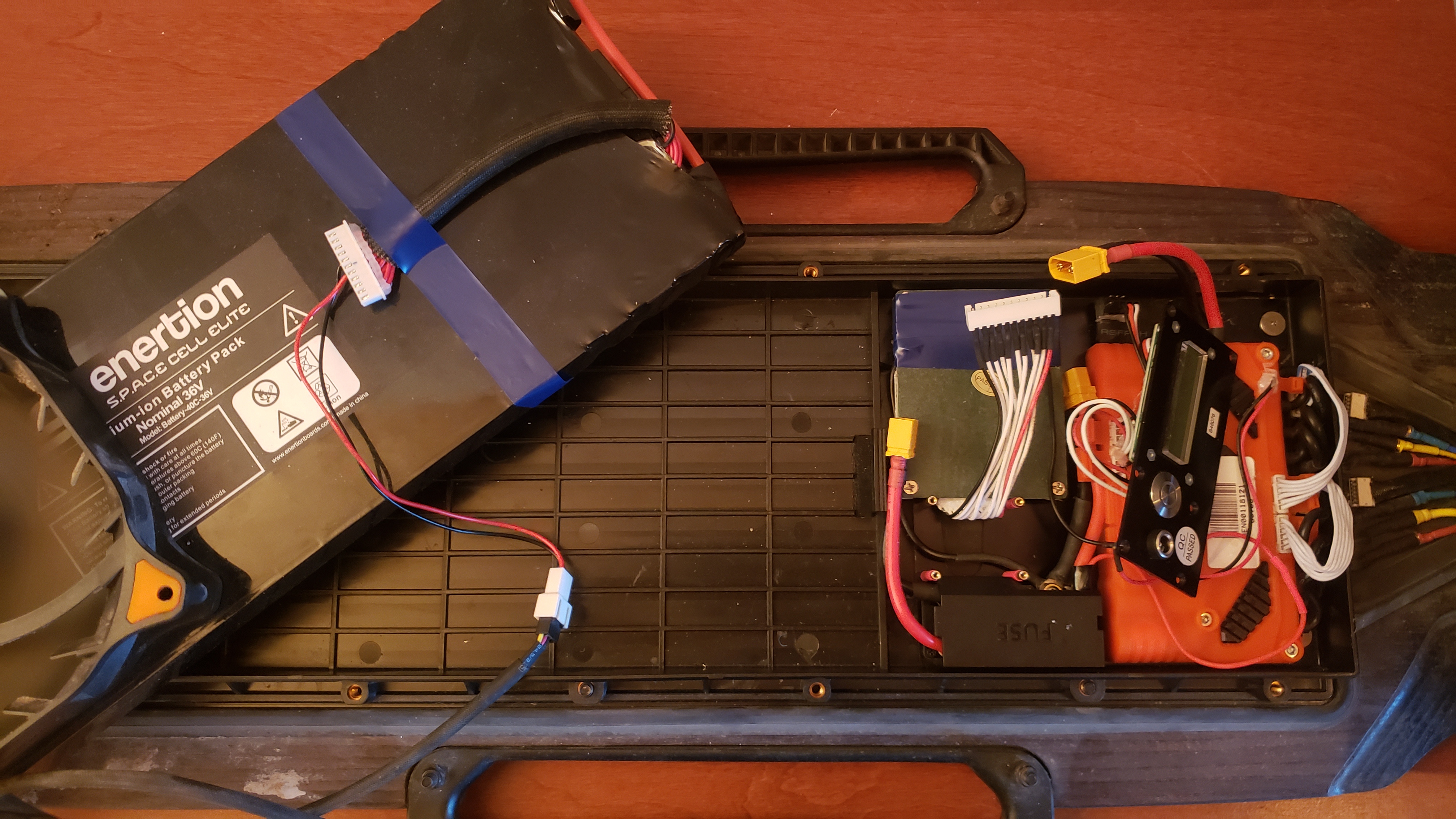

After some weeks of discharging and trying to put the packs a equal voltage.
Finnaly pluged everything and:
Last thing, I misplaced the Bluetooth recepter I think, I gonna reopen the box and check that because It seem I got some connection issue with the remote.
