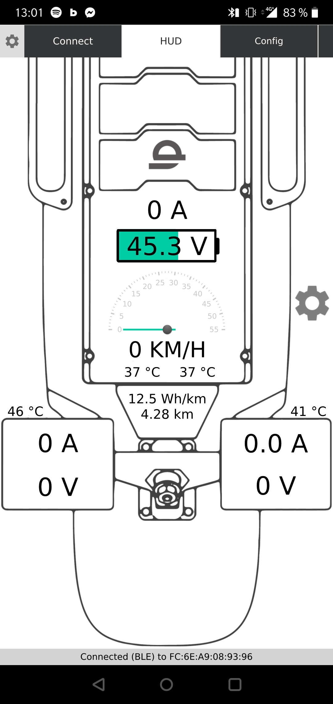

Hi I have a 12s4p 21700 P42A pack. I rode ~50 km range the last Friday. My battery draind down to 36.7 volts (3.06v/cell) acording to Focbox UI. Today when I ride the board I got shitty range
My BMS is due to be replaced as son i recive My new one eventually. It is wired to Charge only. I don’t know a lot about batteries and wonder what can be at wrong.
Before I started my ride today I charged it full 50.0v acording to Focbox UI app.
My charger is a YzPower 12s(50.4v) 6A charger.
Never had this problem before. I have like 20-30 charges only on this battery never had the battery below 40v before the last ride.
Any ideas?
Edit I have checked before that my battery is att 50.4 volt with a multimeter. And my charger charges att 50.4v.

I rode another 2.5km and the voltage is at 44.6v. (14wh/km)
The voltage drops slower know? Is it a indikation that it’s a p-group that is spooky?
if one p group is lower than the others, that means something is wrong about it, if the pack if low cycles it can be replaced
Kepp the battery plugged in to the charger for longer, considering bms is only probably 50ma balance, and you have a 16ah battery it takes some time to balance out hopefully
The first p-group is dead shows no voltage.
All other shows simular voltage. 4.06-4.07 total voltage 44.8 volts. So I just need to replace it right?.
