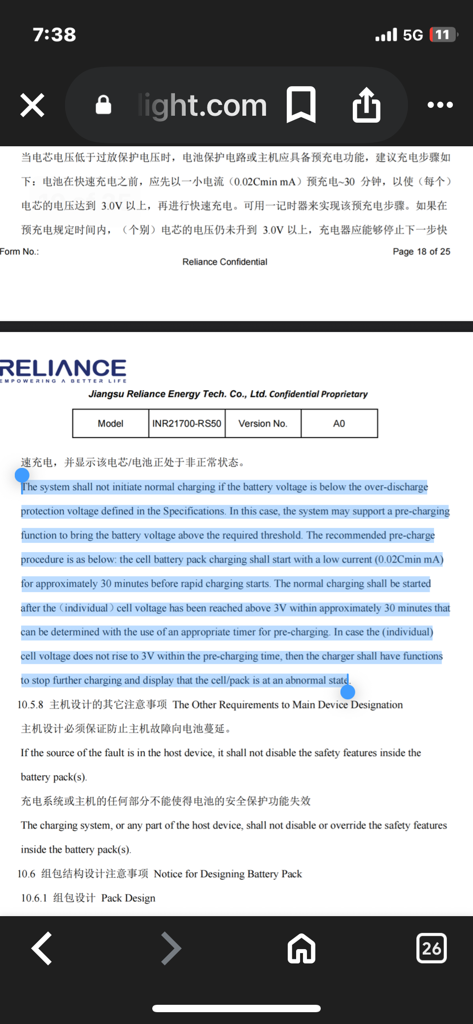

When charging a battery that was over discharged is the right thing to do, charge it as slow as possible as soon as possible.
According to most manufacturers if it’s under 1v it’s toast and that’s the lowest voltage any will say you can revive it.
Yeah, I got giddy too about home depot, BUT, they will not accept ratty still soldered into other things janky cells. In fact, you have to feed them into the receptacle one at a time, so even horribly swollen will not fit etc.
Not even a 1v minimum cut off beyond which you can’t recover as far as I can see with the Reliance rs50
