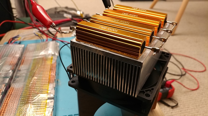

having said that, if you want to discharge your pack, put a load on it. a fan, bulbs, i use resistors attached to a heatsink. but remember to drop the voltage down depending on what you’re using. most fans want 12v, some 24v. bulbs have a whole range of voltages. resistors get HOT so need to dissipate heat somehow.
i use this to discharge, it’s about 6amp @ 50v
