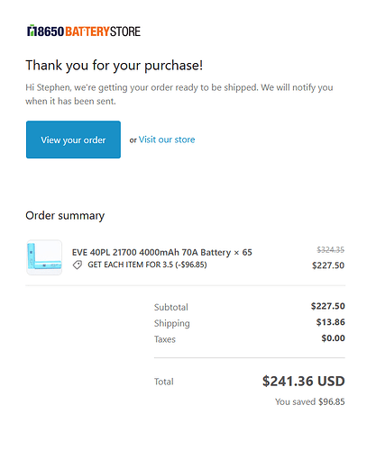

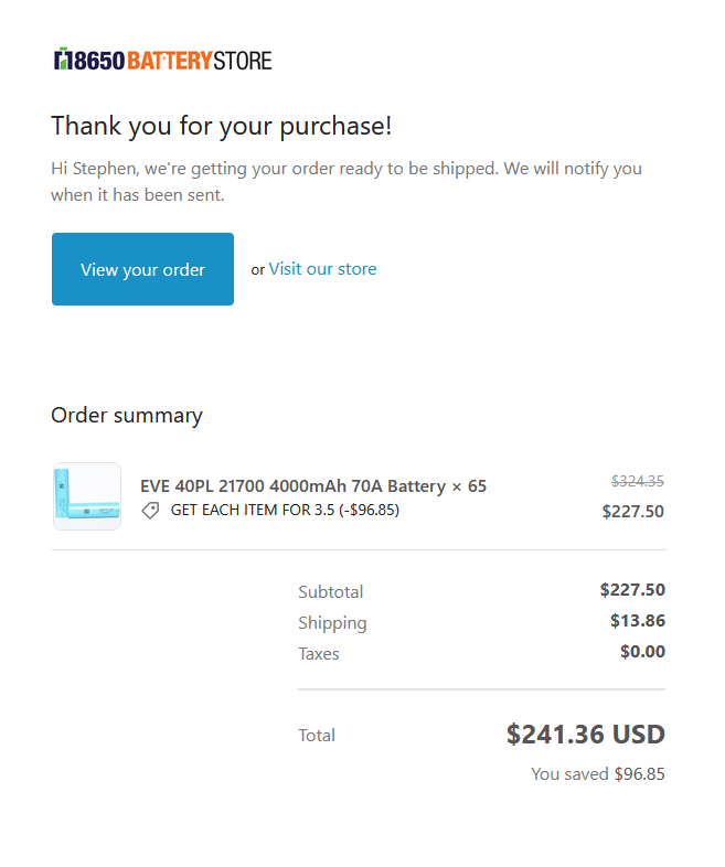

As a side note, tabless cells for $3.50 seem like a real bargain!

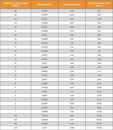

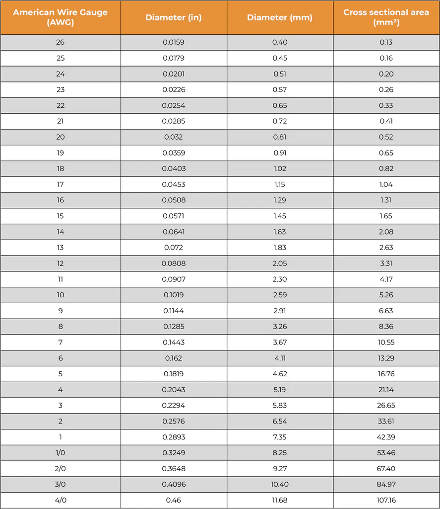

Got it, so (2) 10AWG cross section would be 10.5 mm^2 and (3) 12AWG would be 9.9 mm^2.
