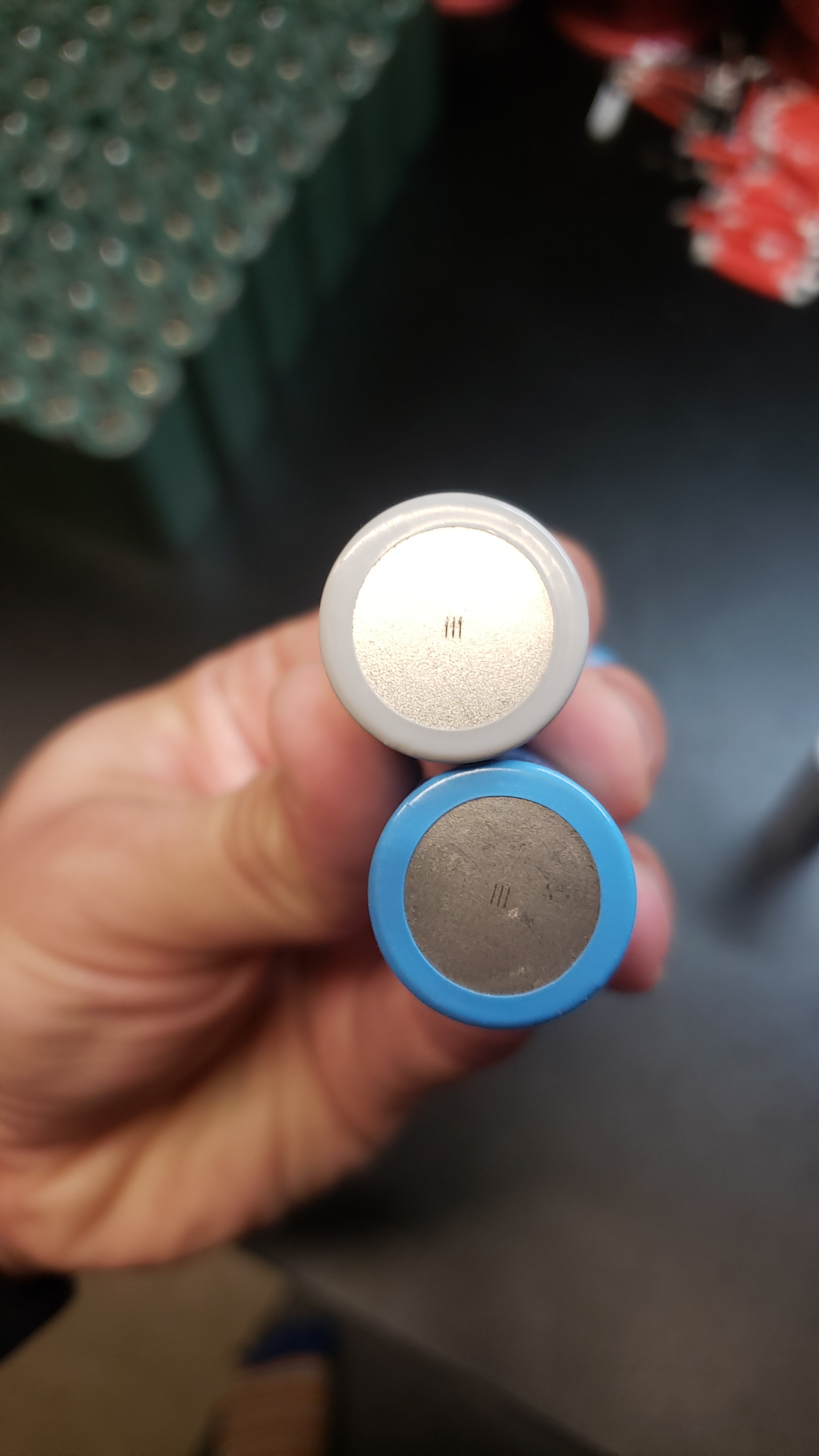

I sent him 4 tesla cells, 2 that came in the grey wrapping from bigbattery, and 2 that came in the blue wrapping from an ebay reseller. They should be at his place on friday. I am hoping that they atleast perform well at 15 amps :sob:
that’s interesting, wonder whatsup with the rewrap…I’ve seen the capacity specs varying between batteryhookup and bigbattery on these cells and I have 200 here waiting for , ummm, ya know, some purpose
Yes I’ve seen varying capacity ratings too, but all within a few 100mah, nothing crazy. Not sure what the rewrap is all about, only thing I can think of is the cells are probably bare when they are recieved from whatever model3 they came out of. They are for sure tesla cells tho. They have the same exact spotweld footprint on the negative side
