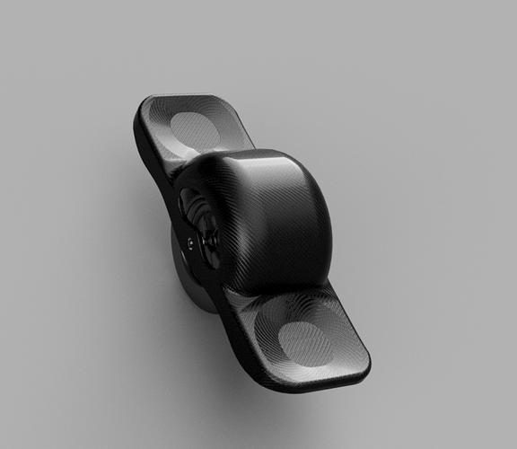

Started with a bunch of bits and pieces I found STLs for, side rails based on the other projects. Kept angles and most dimensions off the original. It doesn’t look like it - but the front/rear still maintain that overall angle - just mine swoops up / tapers - so there will be a longer contact patch when it’s actually on the ground (more surface area)
one-wheel-CF3
One of the guys on the floatwheel discord said - looks like what batman would ride :rofl: I can work with this! Kiddo won’t object (he is more into spiderman now but…)
Got a little swoopy for reasons; Thinking of doing the upper shell as basically a full monocoque chassis. Dropped the sides there beneath where we expect the feet will be, bit more room for batteries + longer. Concave foot pads - somewhat like like the 3d carved wood / printed ones, but opens that space beneath. Intention is add some hardpoints; then probably print boxes to fit beneath.
As usual with carbon - structurally, it’s easy - it’s more the banging around the house/yard/on the road that’ll cause issues - by the time you’re strong enough to handle road rash you’re way past structural needs (napkin math said 300lb rider, 12g hits on the wheel and I still had a 3-4x FOS). Going to use a bit of foam core in the side rails, makes for easy closeout/finish + hardpoints + channel for wiring
Pondering the main wheel hardpoints - I’m probably overthinking it, first plan was a 1/2" thick aluminum puck (i’ll just cnc it out on the 3018). But galvanic corrosion is on my mind for some reason, trying to decide if just a layer of fiberglass/kevlar between carbon and aluminum is enough. Usually I use phenolic - but it’s ‘rated’ to 150c - but that’s not really active loads; same with UHMW…
And I’d really like to think up a nice underside vertical hardpoint scenario.
Still debating options on controller / motor&wheel / batteries. Kiddo’s a speed demon, wouldn’t mind if I built this so it could grow in speed as his skills improve.

Glad to see others thinking about DIY unique onewheel builds. I think there is room in the lineup for an ultra lightweight and lower center of gravity Onewheel board designed for tricks and not trails.
Things I gave in mind for this are:
-carbon fiber rails/everything
-possibly a suspension made of carbon fiber
-a smaller tire or at least a much lighter airless version
-a limited top speed below say 20mph to allow enough torque but also use lightweight power systems.
Using a belt drive is probably the lightest weight solution no? Is steel gears superior even with considerably more weight?
Yeah I was keeping this one to known and proven for this build. The hubmotor that’s already being used in the floatwheel/funwheel was my intended path.
A lightweight version would be cool, not sure where that line is between fragility & weight should be - so I’m not the one to figure that out being the FNG and all :joy:
