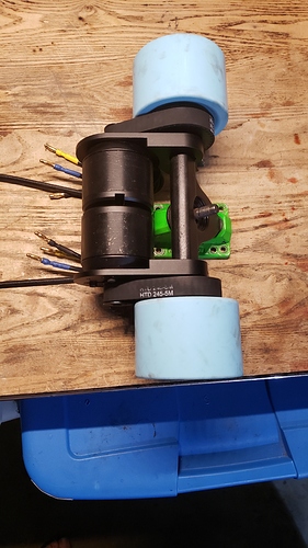

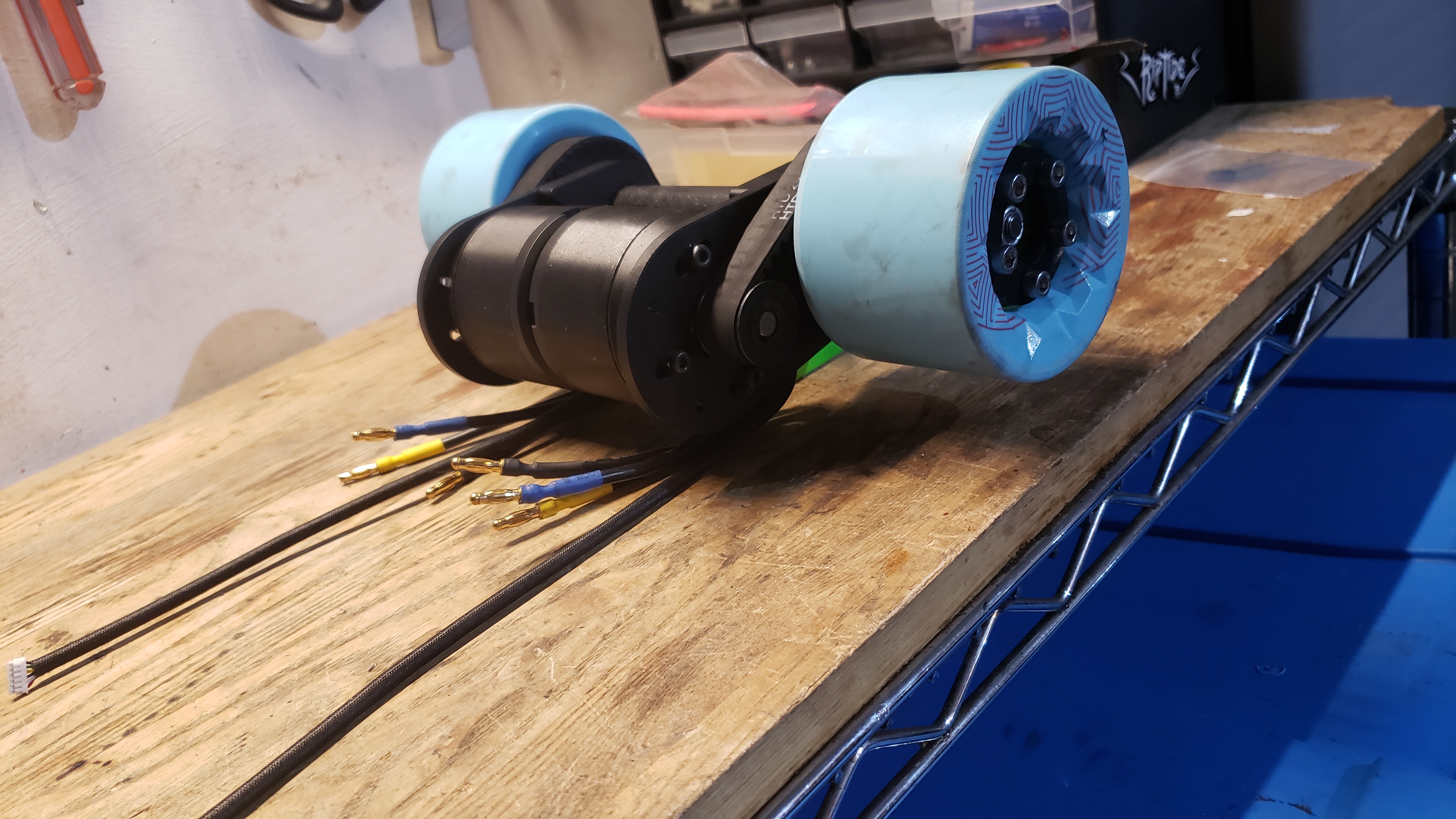

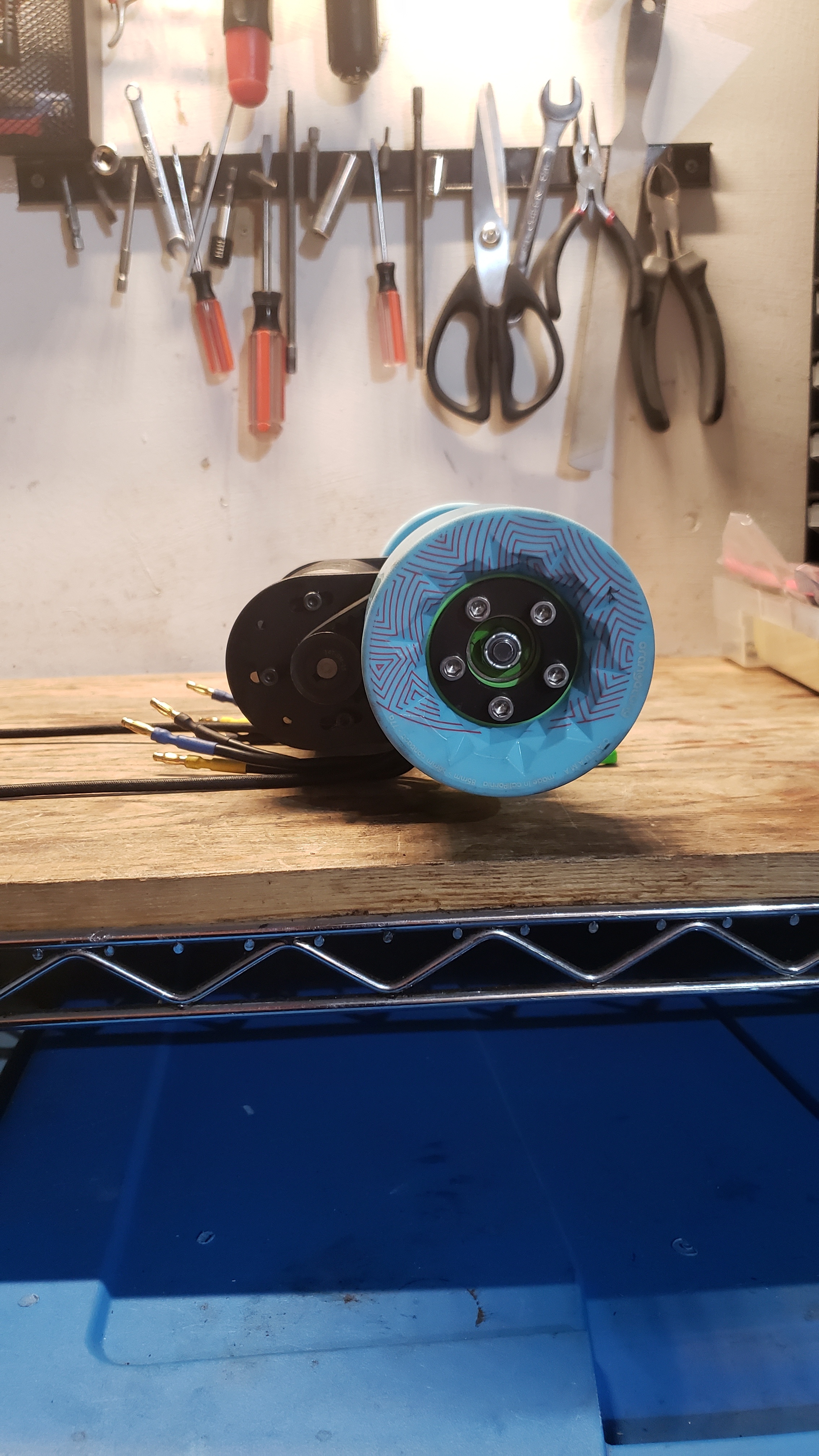

the only parts I actually had for this one was the Flipsky 6354 Motors, and the Caliber Trucks.
I really need to get rid of all old parts I have laying around so I don;t get these insane itches anymore and go buying a bunch of new parts…

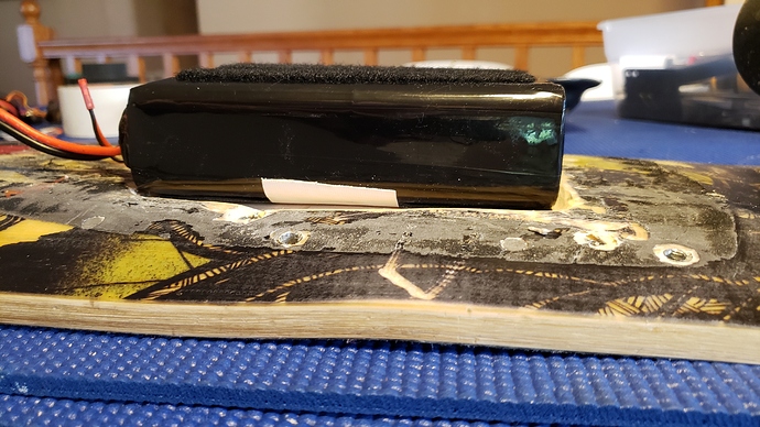

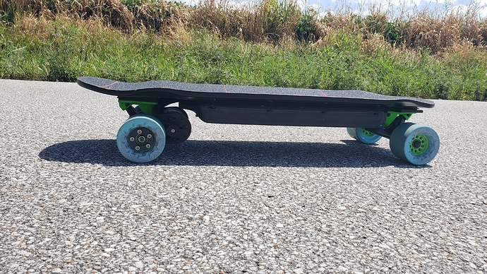

So the deck got here yesterday. and it looks sweet.

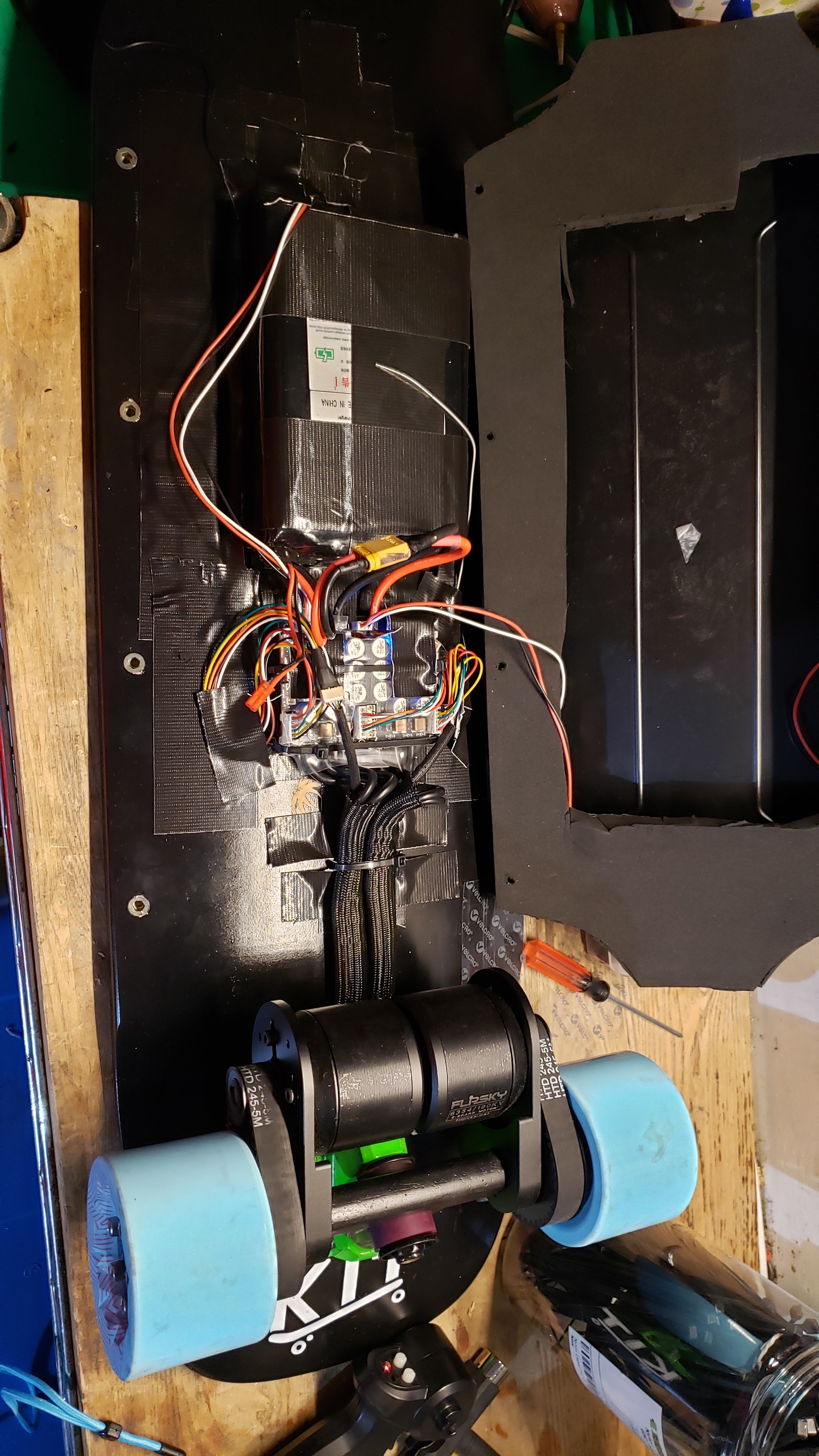

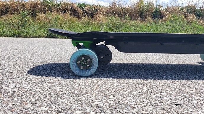

I got the BKB motor mounts Jared had on super sale and they work fine on a painted Caliber Truck.
they are so easy to set up.
Going with 14/36T 245mm belt.

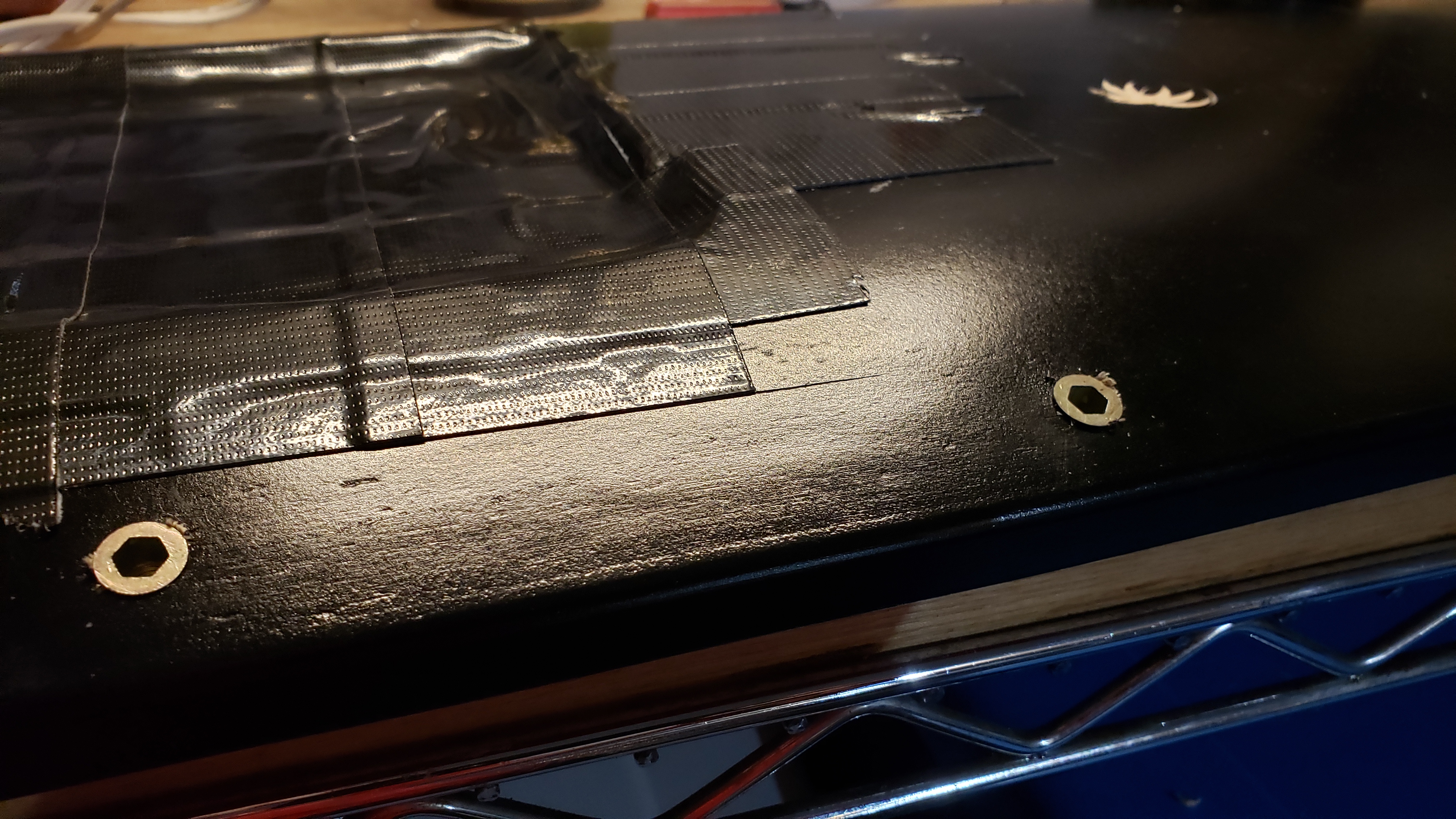

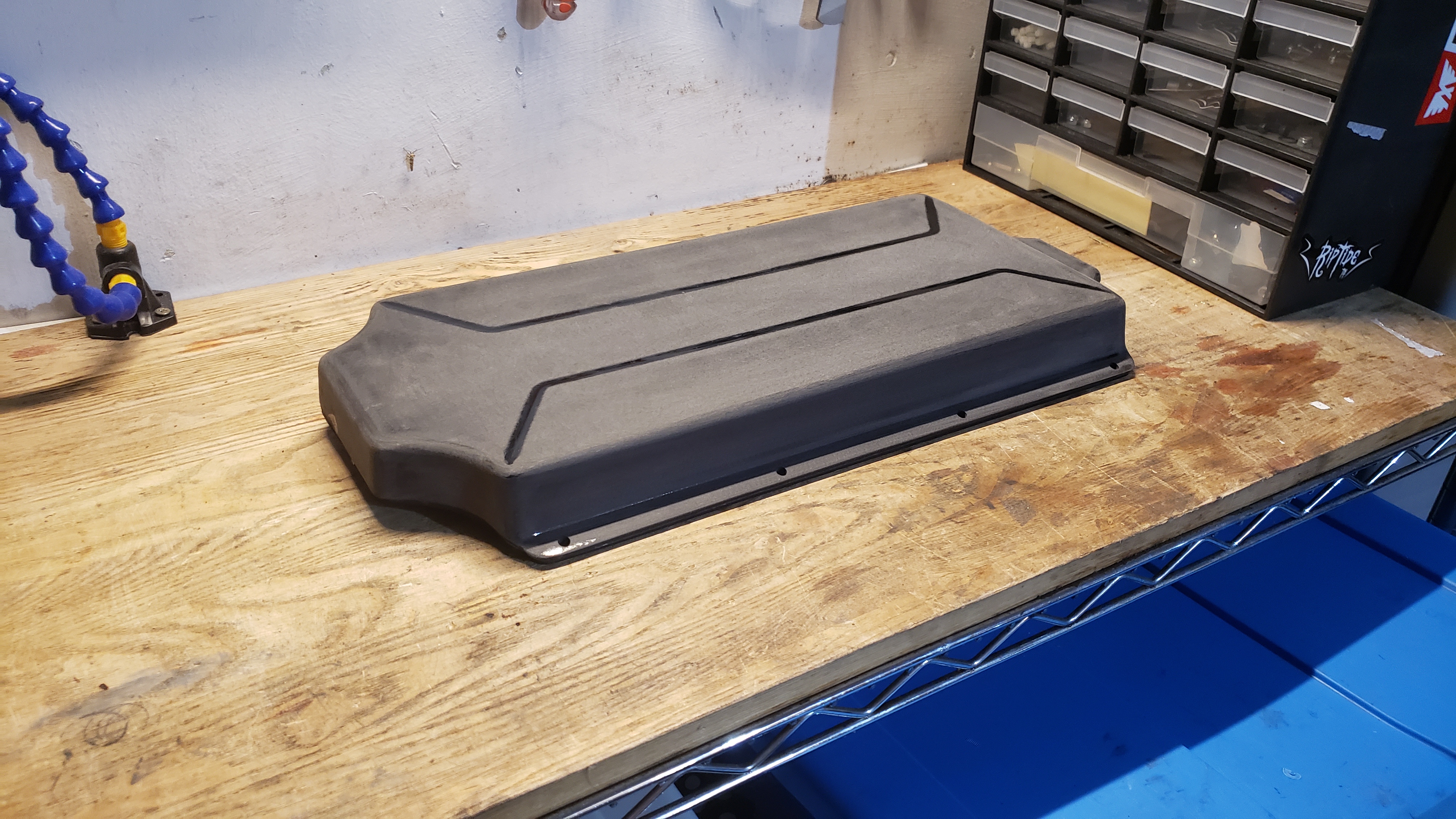

Next I sanded the enclosure. it was too shinny for me.

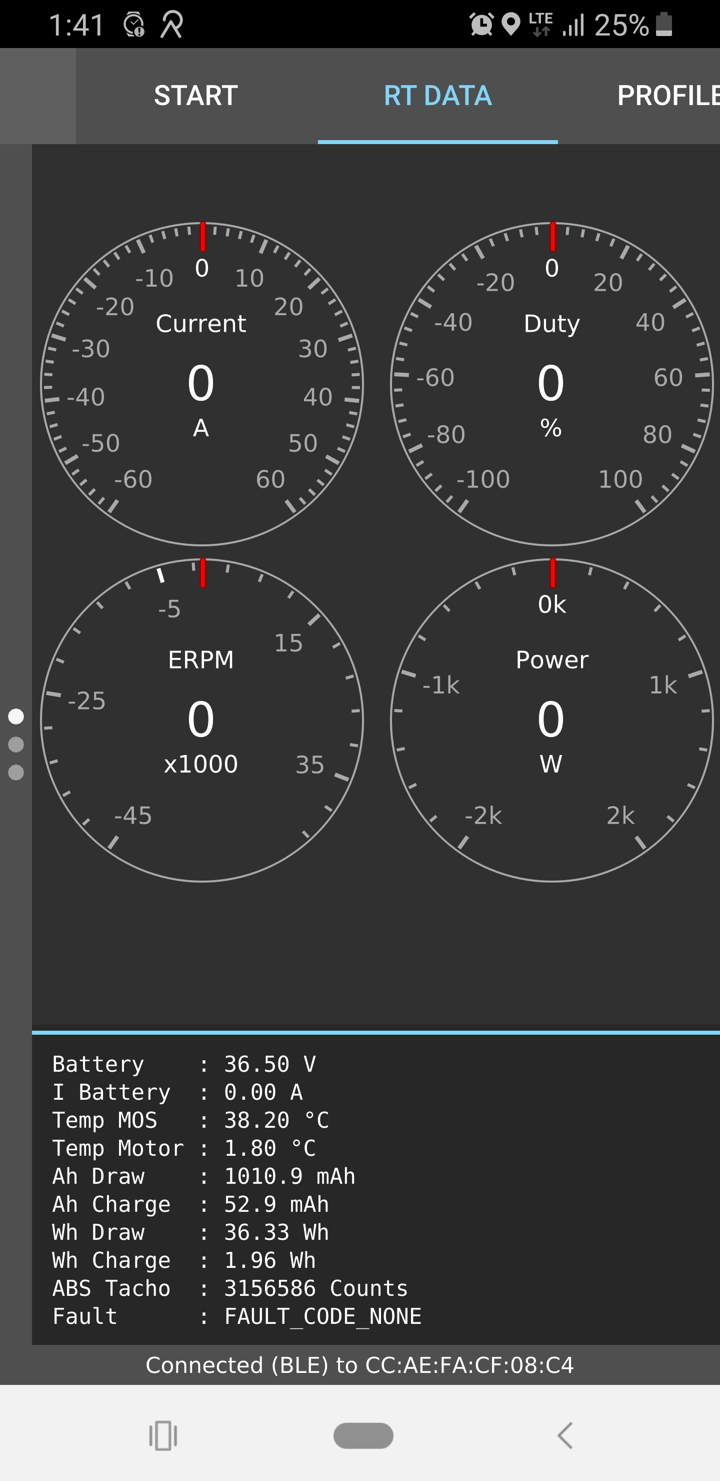

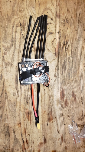

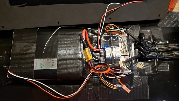

And last task last night was to solder terminals on the Flipsky 4.20 plus.
So I am most of the way there right…

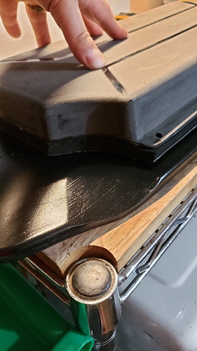

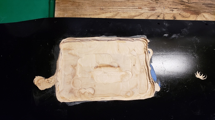

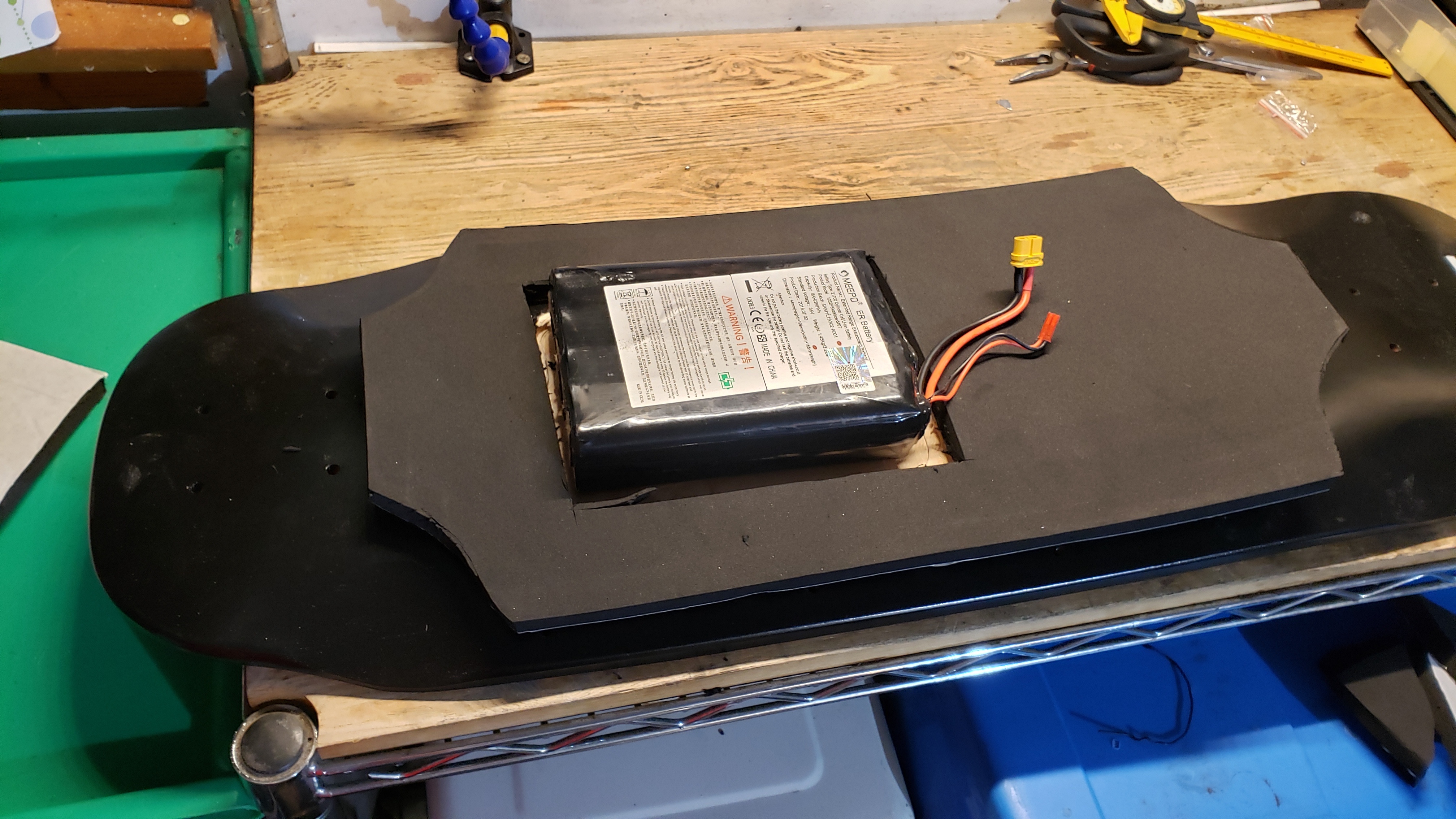

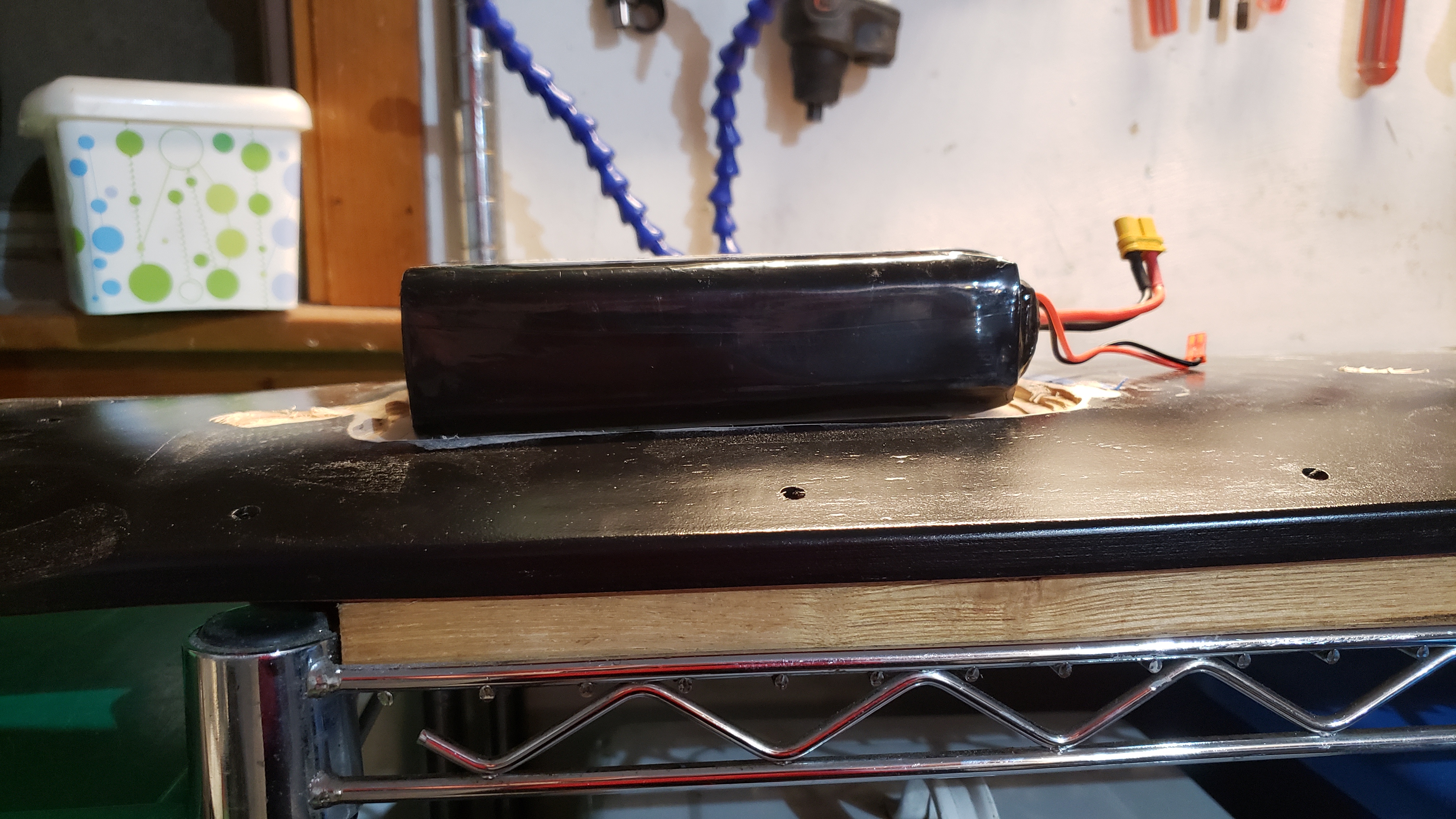

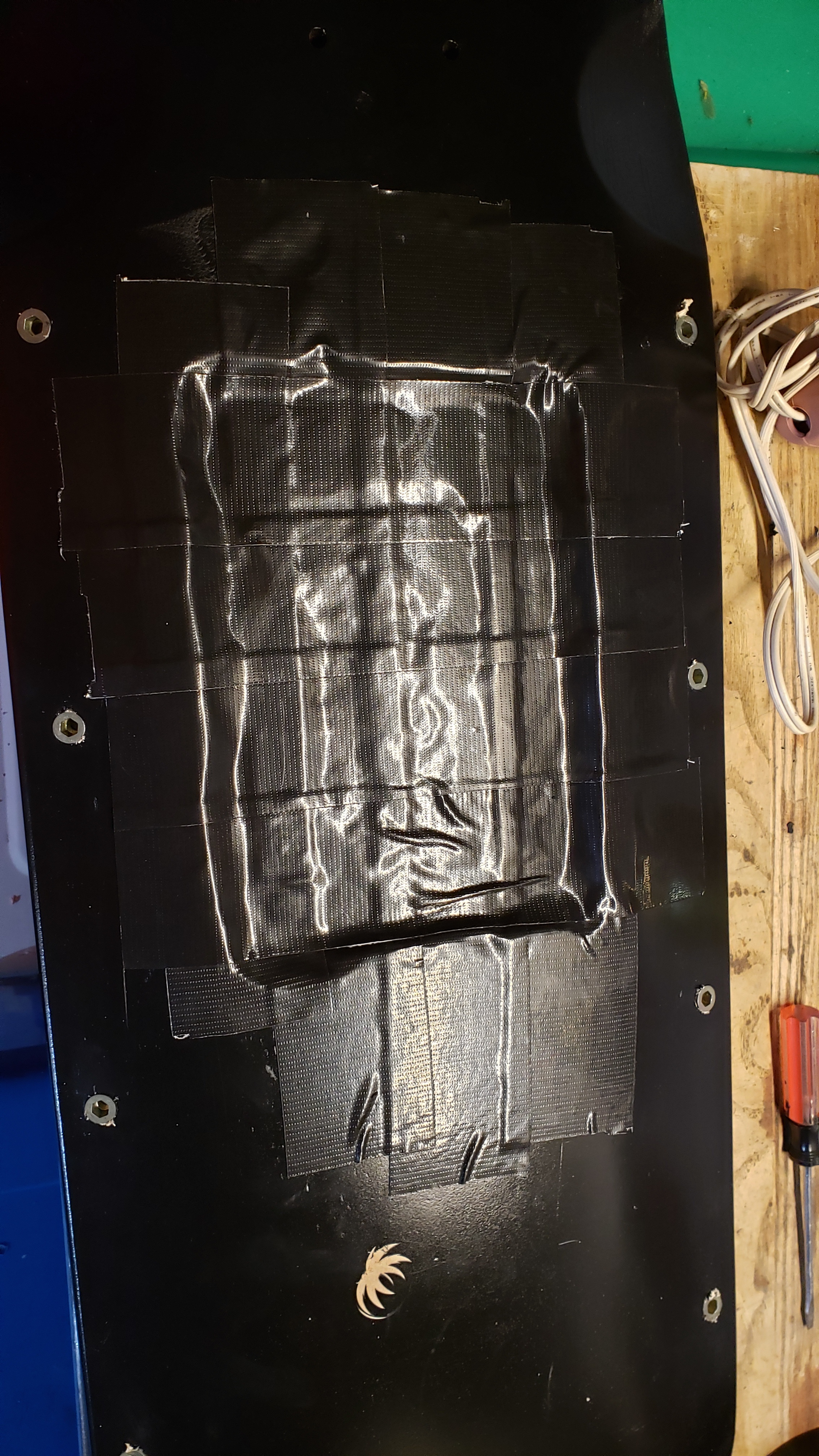

The only bummer will be figuring out how to get the enclosure on with the chunky Meepo Battery.
I plan on routing 5-6mm off the deck, and adding a foam pad to bridge the gap.
This is what I have to live with since it is so hard getting batteries…
Meepo delivered in under 2 weeks.
A flat pack would be awesome because the BKB enclosure is such a sweet fit onto their deck…
More to come in the next few days.
