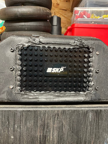

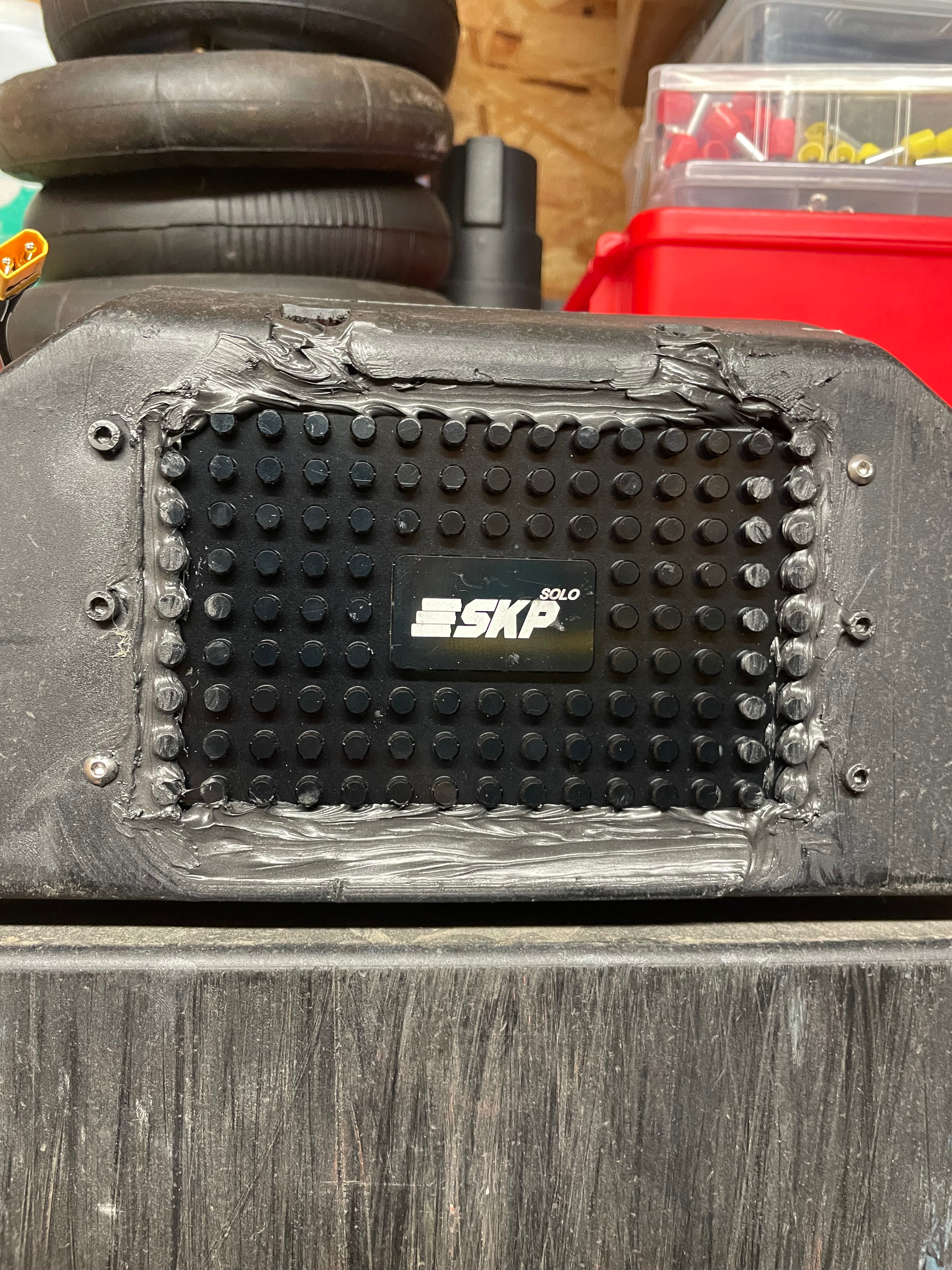

-hoping I can get dual skp solos that I already have to fit inside enclosure. Might require some router work on underside of deck.

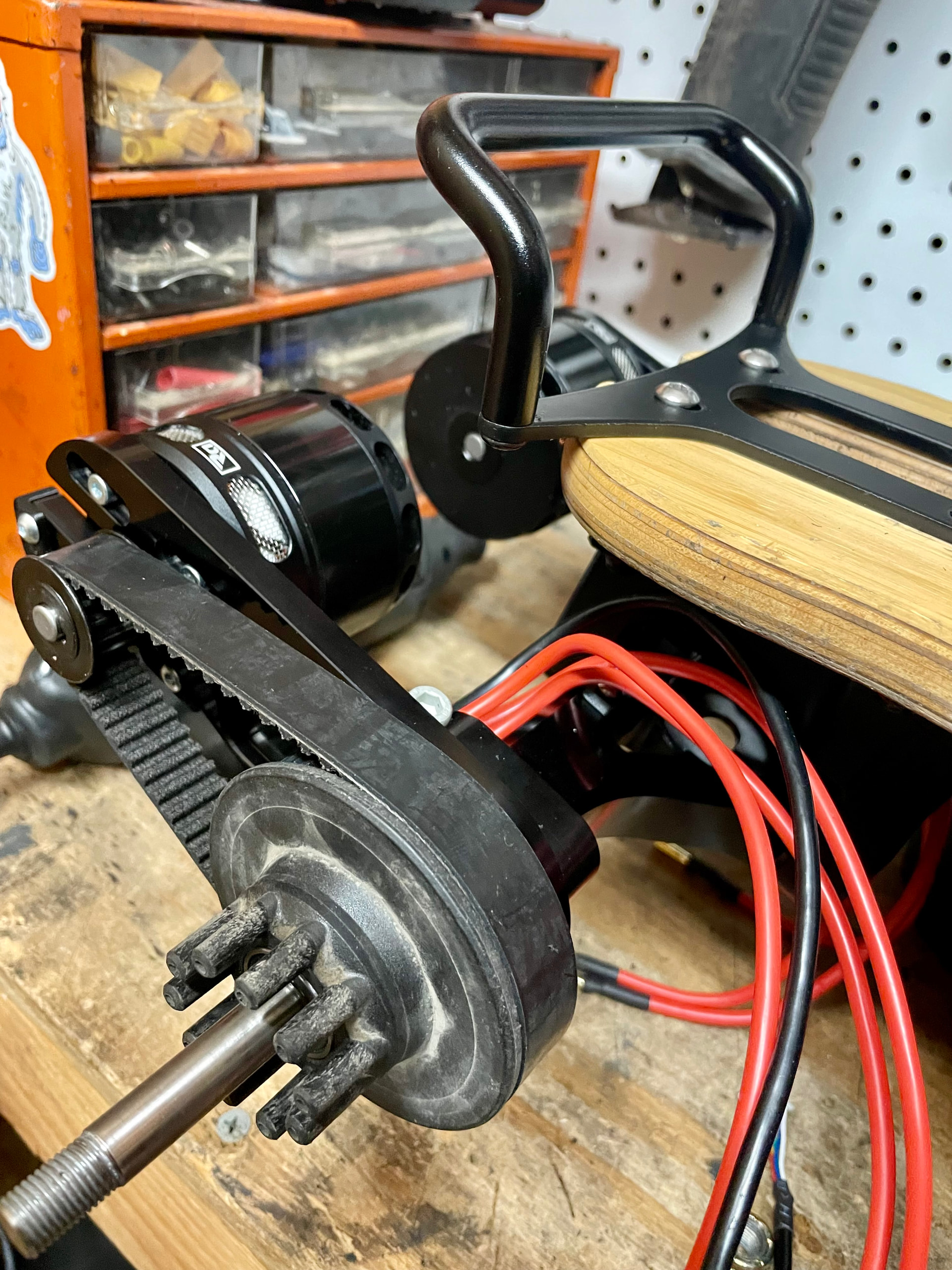

-optibelt Omega HP belts. The HTD belts stretch too much for me I need a more robust belt.

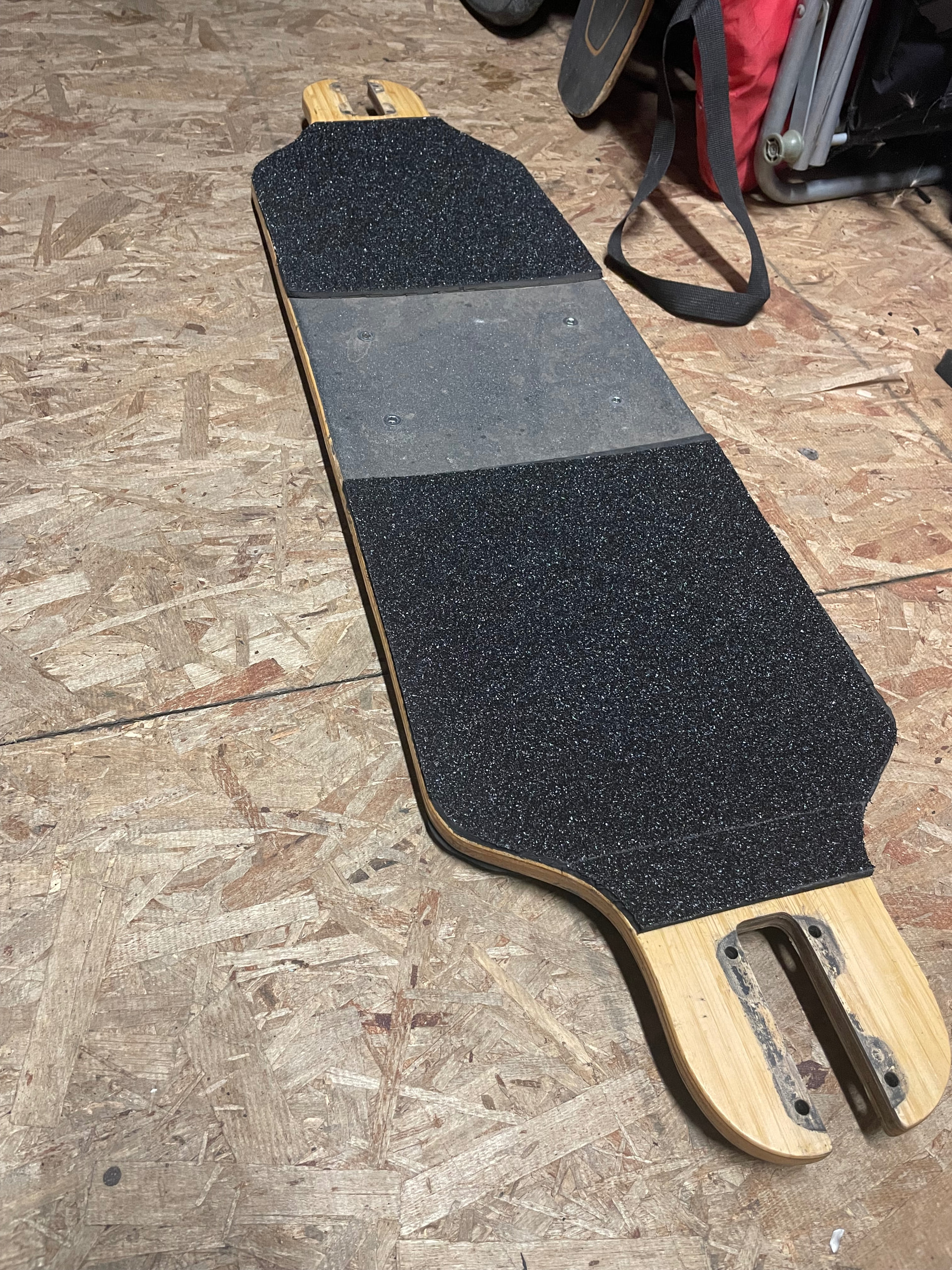

Stripped deck down and replaced grip tape with extra Vicious I had laying around.

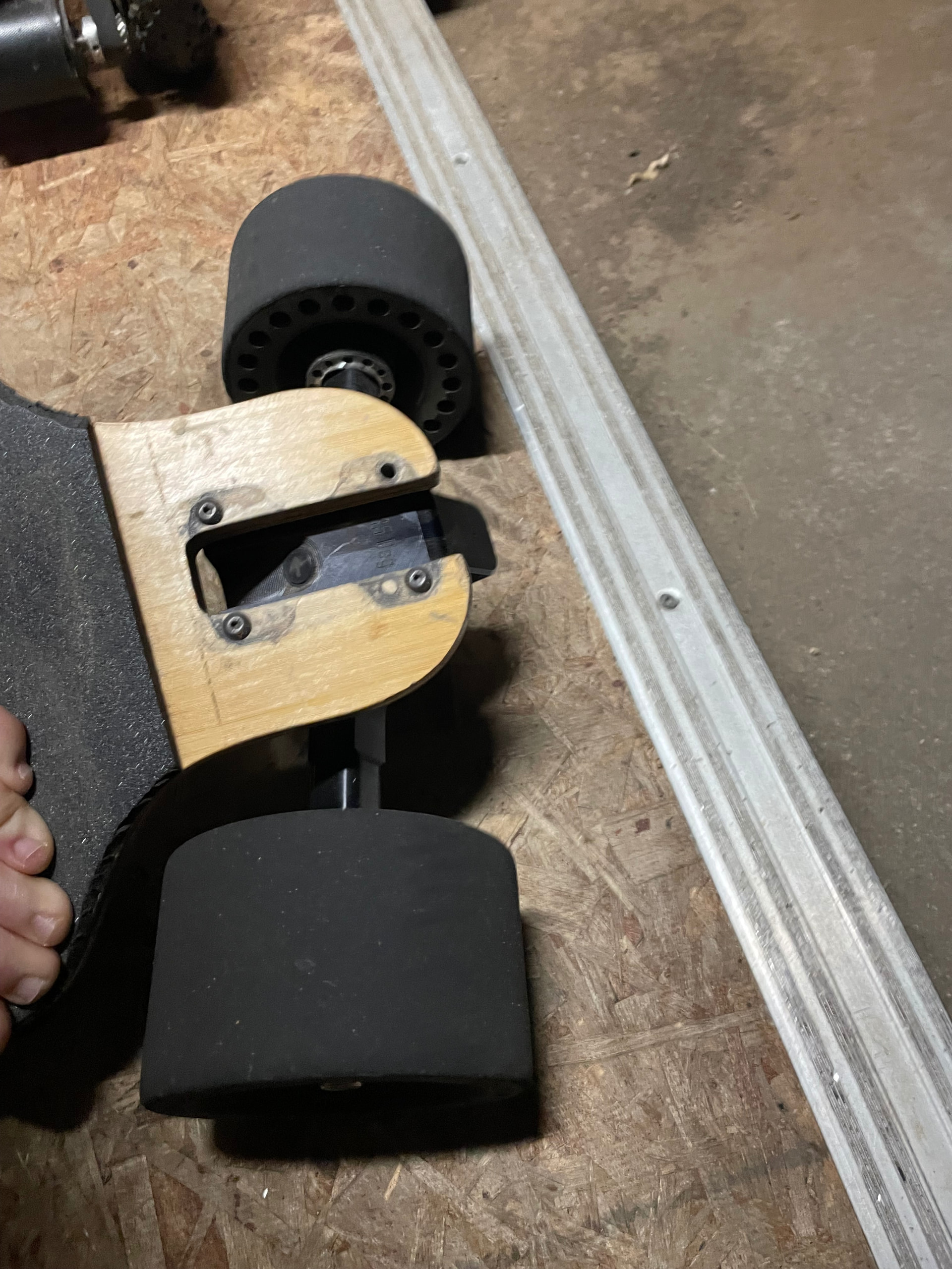

210mm duality motor mounts installed
Dual SKP solos mounted
6455 173kv motors installed
Optibelt Omega HP belts mounted.

**not prettiest job but will do the job for this build, replaced the socket heads with button heads already.

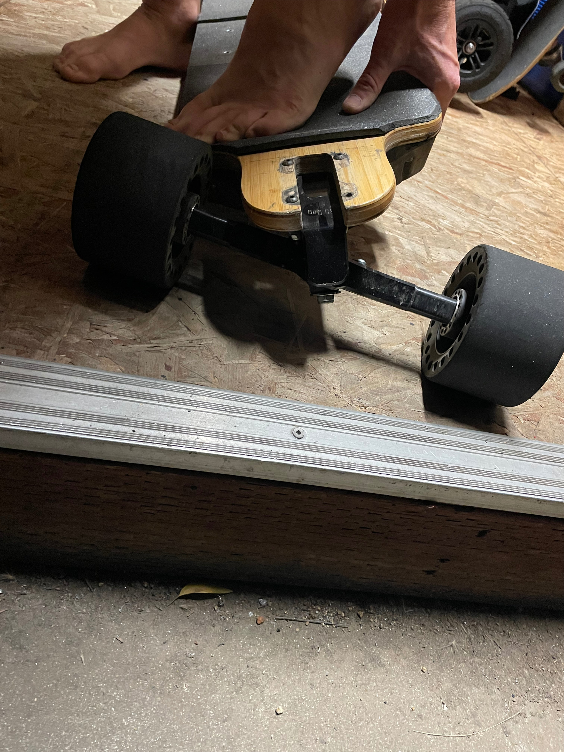

Got the conversion 1.0 completed (esc, trucks upgrade). Very fun carvy board, happy with deck clearances on the 210mm duality hangers. I suspected power would be low, but it’s just not enough. The stock battery only discharges 25 bat amps total for 12.5A per side. With the 6455 motors set to 50A each, it needs a slight bump in power which I think I can get from replacing the pack.

6455 motors weren’t cutting it. Recycled 6495 from Street Beast into this Zeus conversion.
Dual 6495 on @Titoxd1000 Duality 210mm hanger.

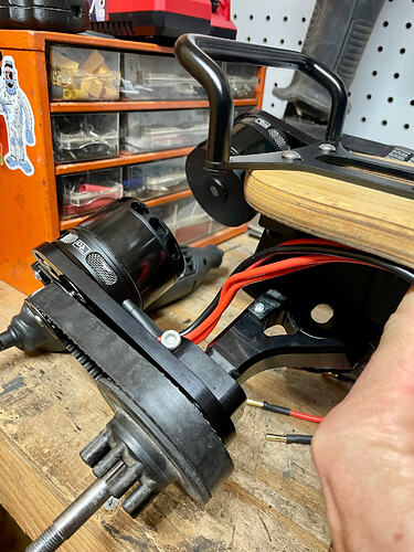

I tried the Optibelt Omega HP belts. Expensive lil things $30 per belt. Only bought 3 of them as a test. Great belts with 6455 motors pushing 50a each. No slippage or belt stretching. But this setup was too low power for me and I switched to 6495 motors. Pushing 90a per motor no issue on belt reliability but upping power to 115a per motor I quickly started stripping the teeth off these belts. Which is unfortunate because this is my desired power for this board. Belts were pretty snug on the pulleys.
With typical HTD belts from say v belt guys or amazon stretching was the biggest issue I had. The belt would stretch then skip and I’d have to pull the motor to get proper tension. And I would eventually snap the belts.
I thought the Omega HP would be more robust for me. I notice they stretch less than typical belts but the teeth don’t seem to be strong enough.
The teeth stripping happened on each side drive and teeth stripped one week apart from each other, so hard to blame it on one pulley or rock inclusions.
Using 125mm mad wheels with 45/15 gearing. I’m jealous seeing the amount of torque radium
Is getting from their boards on belts.
The issues I’ve mentioned with belts are what’s making me explore an open gear drive to use with 125mm wheels.

I think an idler could solve a big part of your belt problem.
115A motor current by itself shouldn’t be enough to kill a good 15mm belt that quickly. The bigger issue may be that with the small motor pulley you only have around 6 teeth properly engaged.
A fixed backside idler placed close to the motor pulley could increase the wrap to roughly 180–200°, giving you around 8–9 teeth in mesh. That would reduce the load on each individual tooth and make ratcheting/tooth shear much less likely, especially during hard braking or when the wheels regain grip after a slide.
I’d definitely try an idler before changing the whole belt drive.
Thanks, yeah I’ll need to look into that option if the open drive doesn’t work out for me. I’ve seen idler’s work well for others also. Good recommendation.
This is what drive me to gear drive
The open drive is installed with mad 125mm urethane wheels. Untested yet though.

Didn’t end up using the skp solos and got a D100S in there instead. The next time I open it I’ll snap a photo the completed build is the cleanest cable management I’ve done yet.
