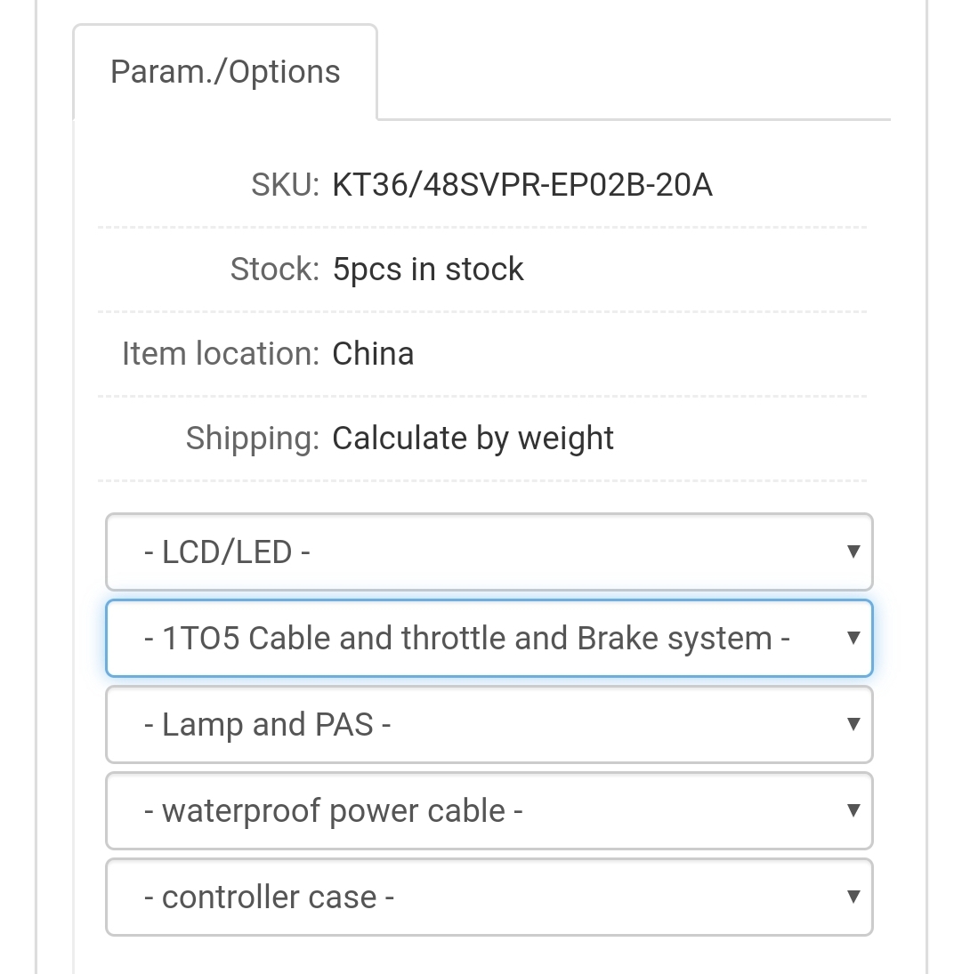

I had issues with the original controllers I ordered.
After that I ordered these
http://www.pswpower.com/ven.php?cargo.2020-3y-gq0f
They are plug and play with the bafang hubs in these wheels. You’ll need a 9pin Julet extension to mount the controller anywhere reasonable.
They took a few days to ship but after I got shipping confirmation they took about a week to arrive.
Which options did you choose may I ask?
I selected these
The lcd is a must get.
The thumb throttle feels pretty nice and seems worth it.
The lamp is pretty lame and the pas ( pedal assist sensor) is pretty cheesy.
The 1m power cable is totally worth it for $2. Solder your xt-whatever on the end and you’re good to go.
The controller enclosure is nice but much bigger than necessary so it takes up quite a bit of space.

The motor wire isn’t long enough to place the controller anywhere.
Full disclosure I ordered the amazon link above but it hasn’t arrived yet. I assume it’s the correct pin but can’t verify yet

Can you post pictures of the different connectors on the controller, and and pictures of what that $2 power cable looks like on both ends? Their website isn’t that good with information / pictures. I actually email them to ask what that $2 power cable is, and their response was just buy one to try. Unfortunately, it turned me off a little bit with their pre-sales response.
At least know I know you had a decent / positive experience. I trust a positive review from someone on this board than a thousand reviews on their own website :slight_smile:
