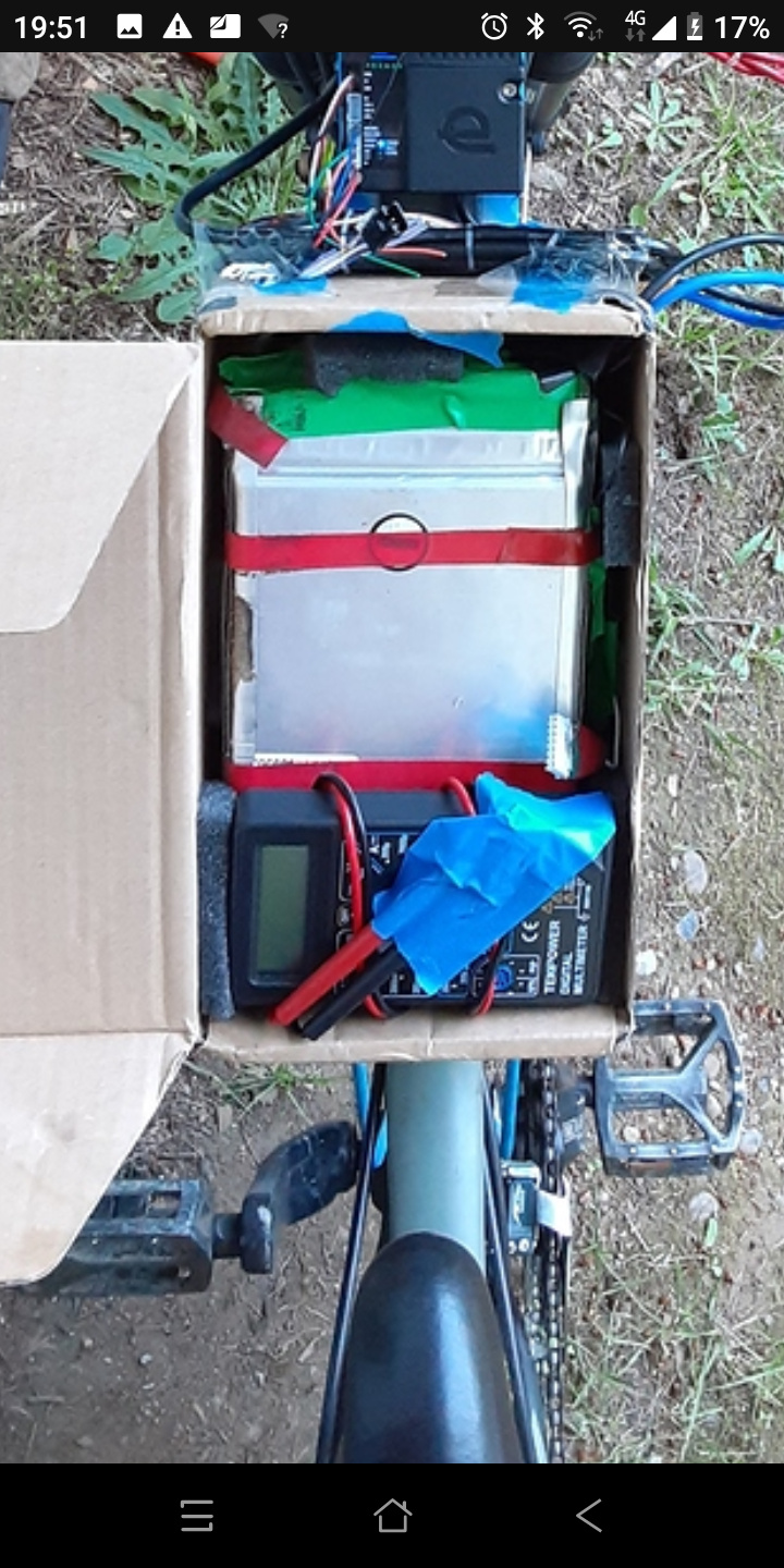

177Wh pack drained to 0 in about 14 miles which gives about a 12.69Wh/mi on varied terrain, some big hills, not much pedaling.
Hmm because it freewheels down hills but doesn’t track that distance I guess I rode farther but it couldn’t tell.
@Fosterqc those are some excellent watt per mile numbers. On my ebike I usually get around 20Wh per mile with a lot of pedaling, and 35-40Wh without pedaling. How much current are you pushing?
Also curious about coasting and braking/speed change. Did you setup braking in the focbox/do the hubs de-clutch and freewheel when not under power?
Regardless, consumption numbers seem pretty good!
Yep I can feel the resistance of the one way bearing when riding downhill, it makes it very hard to pedal much faster at all. The twist throttle I’m using doesn’t do any braking, the cogging of the motor slows itself down.
@Mr.Electronicist I forgot to look for max current when checking the range, but my settings are 40A motor and 35A batt. I’m still only running 6S due to being scared of the missing torque arm.
That’s probably a smart plan until you get the arms. I bet these hubs will be fine with 50-60 amps, but would be good to use the thermistor in that case.

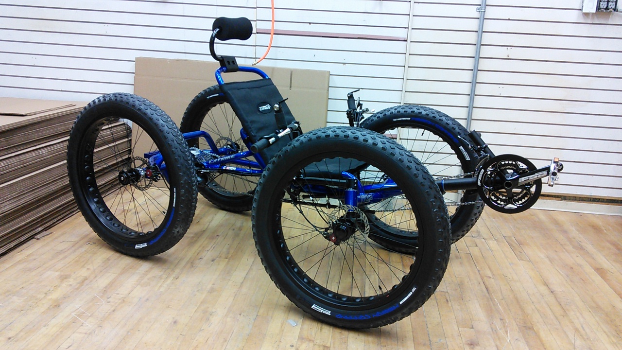

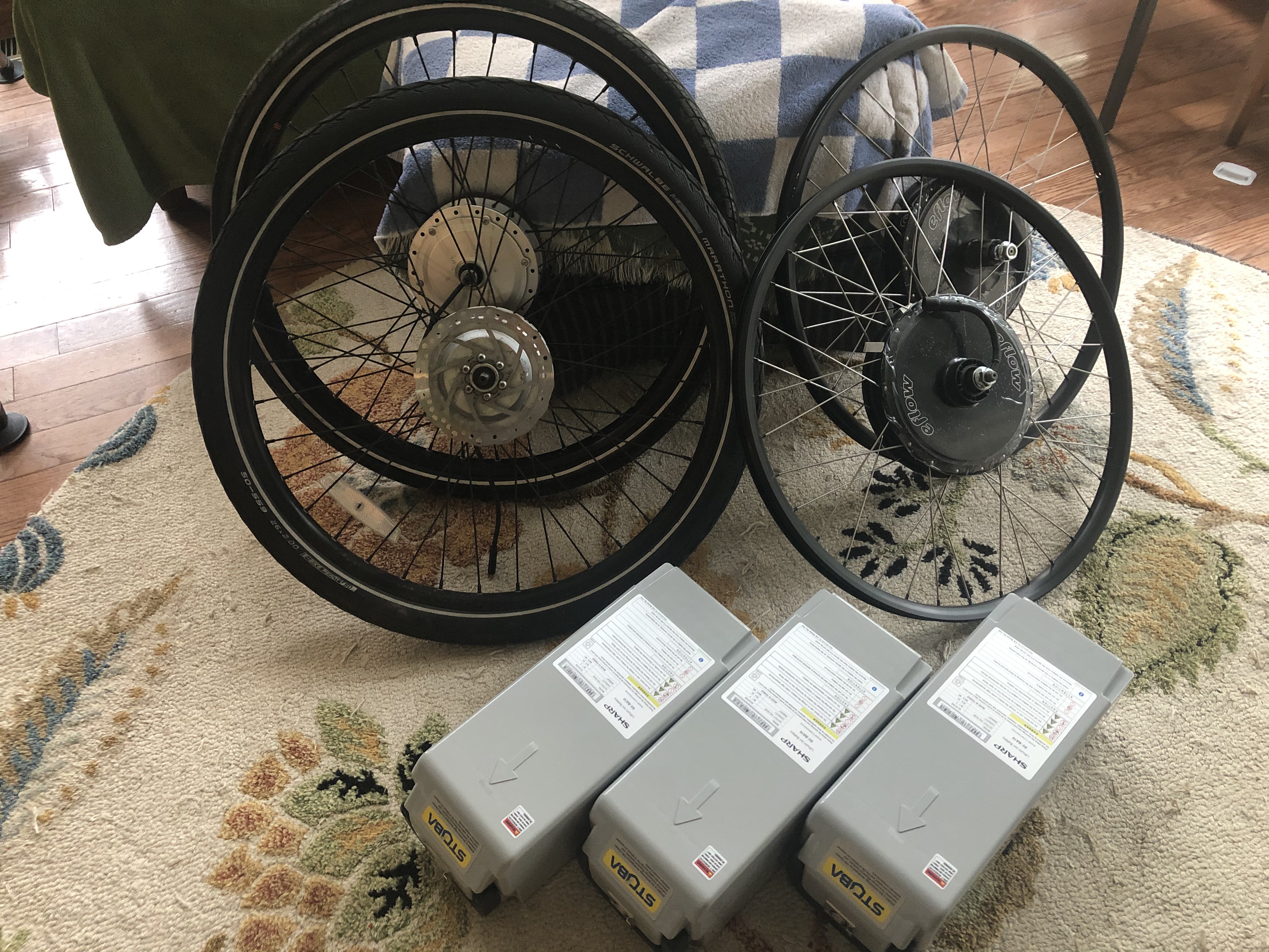

I finally figured out exactly what I’m going to build with these hubs and set of rear hubs I have. 4WD recumbent bike.
will it still have pedals? or how will you make the bafang hubs cassette driven?
are you going to modify an existing frame? that would make most sense to me.

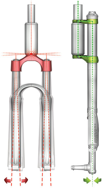

lastly will the wheels only be supported on one side like in that pic?
Also wondering about the 1 sided support.
Reminds me of the “Lefty” proprietary hub setup though
I want to put pedals so I can still fall under some sort of bike classification. I have some separate direct drive rear hubs that have the mount for the gear casset that I plan to use. I would just use these bafangs only as the front two wheels. Right now I’m just using that frame as a reference point, I wanna do something between that and a UTV frame with all wheel independent air suspension. Probably weld up a chromoly frame from scratch. I think I’m going to have to design a two sided wheel mount for it, because i don’t feel like machining new steel axles. Unless anyone here has any good ideas on making them one sided

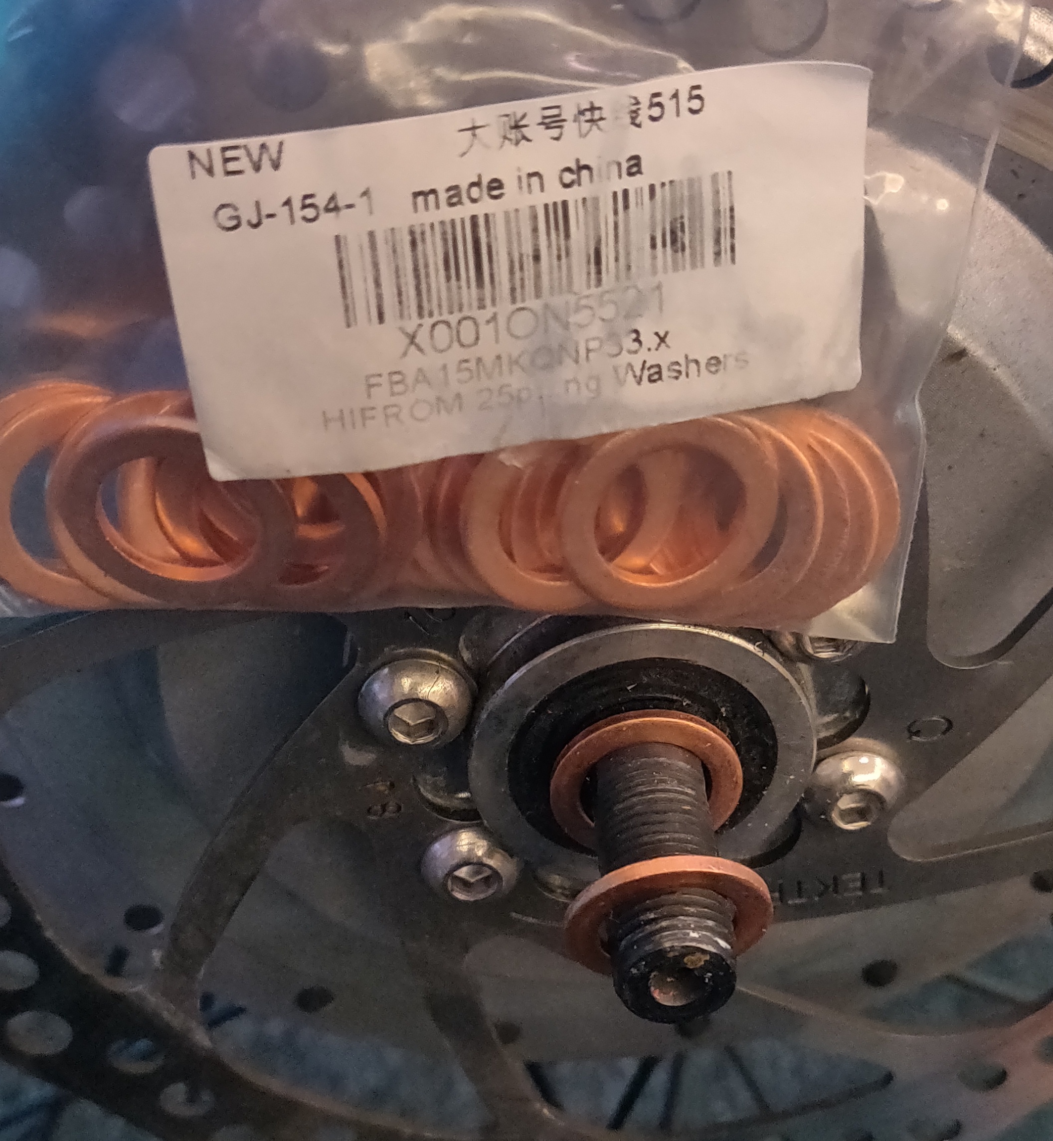

got some washers in
https://www.amazon.com/dp/B078RG5T8D/ref=cm_sw_r_cp_apa_i_oa6-Eb2XTW5TF

haha, hells yeah, I have that same voltage meter :joy:
seriously dude nice work getting this thing to move, even if it is in a shoebox, lol
