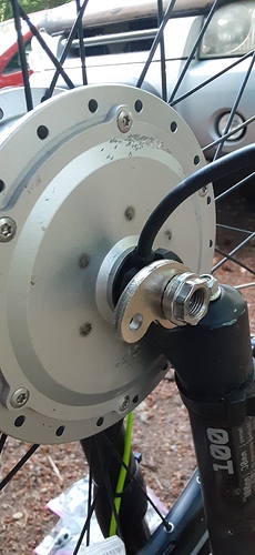

@Scepterr did you use the lock washer things as spacers? One of those on the disk side fills up the room.
With the torque arm the axle is not long enough…

you need like some skinny ass mofos on either side or something due to the short shaft.

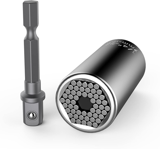

@Scepterr did you have a tool to tighten those down? is it like a security nut?
Hmm should pick up some m12 locknuts I guess
My friend had some of these I wonder if that would work lol (bigger ones)
dudes on endless sphere use , like, hack-sawed-and-defiled 10mm (?) open end wrenches before they spend $10 on something that will take them 3 hours to build.
lol
Me? I would get to work with a hacksaw, grinder, and beat these out of some plate I have laying round or in my way.
I really think the “easiest” laziest? thing to do is have someone with a CNC make some proper fitting and thinner steel versions of the loose part I have.
My bike toolkit has the needed wrench
there is only one kinda critical measurement here.
  1. the channel for the flat on the axle.
the arm is hose clamped to the fork and length is fine as long as you can fit a hose clamp onto it. Or find a hole (like one for the disc brake, if equipped) and still you can do this with a drill press, a file and a grinder.
It’s a hacked ebike, not a spaceship, lol

Oh I forgot to say @Mr.Electronicist the bad part is stamped!
@Fosterqc I’m wondering if that’s old stock or something, and they updated it. Of all 3 kits I ordered, all parts were stamped accept for the main piece that goes on the axle. It looked like it was laser cut and was thicker.
hmm yeah like the old stock hadn’t sold out at this warehouse.
What do you think about the axle length problem? it needs to be much thinner
Hopefully my stepdad is able to align the brake disk as well because it is rubbing on one side, still able to spin but needs a little more alignment. I need a TINY bit thicker washer on the axle, but i’m not sure I could put a thicker one on. :thinking: idk maybe the caliper part can be moved.
I ran into the same problem on my back ebike hub. I just used loctite and am dealing with only half of the nut being in the threads. So far no issues (200+ mi). Can you use the torque arm instead of one of the washers?
I thought about that but haven’t tried yet. let me try
Oooh that was satisfying when it slid in very tightly, but the bolt to link to the arm interferes with the brake disk bolts. let me take pic
I’ll post a picture tomorrow, but I managed to use 3 of those torque arms on my back hub. 2 on one side and one on the other
