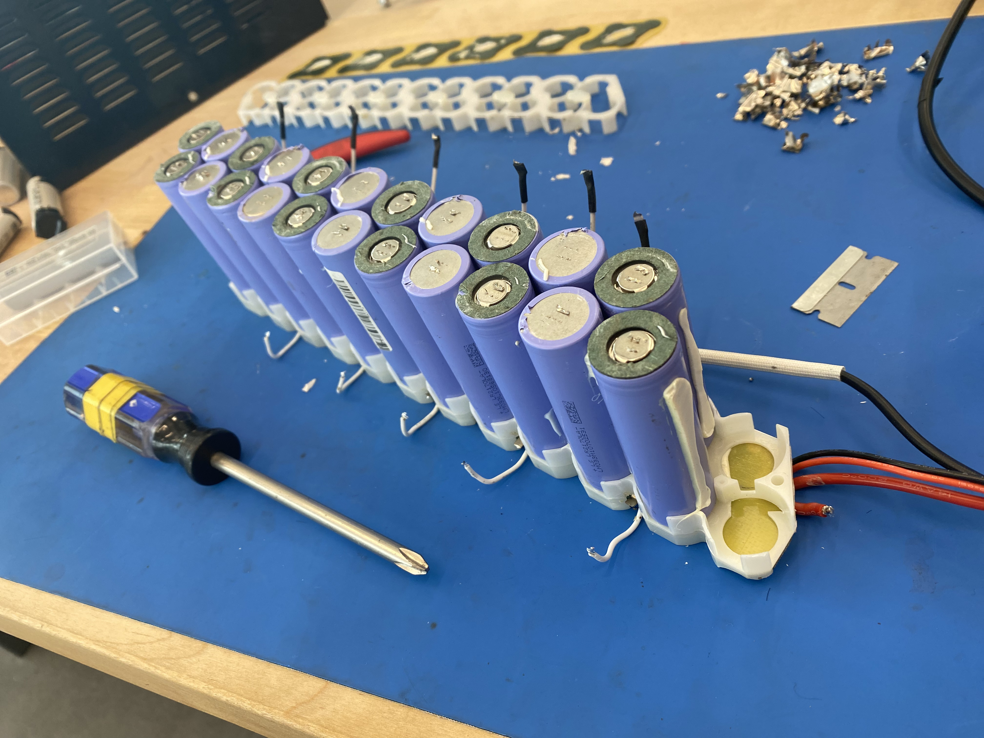

Step 7: Remove the polycarbonate protective sheet on the bottom. Don’t short out these terminals. Even a sweaty forearm is enough. Carefully cut and pry off the nickel sheet with some side cutters. Also, maybe Google your batteries if you find it interesting. The writing on the side will tell you what it is.
Step 8: After cutting off the nickel strip on the bottom, then you have to remove the PCB. I found it easiest to desolder the connection points, and then slice the silicone with a blade and then slowly pull the PCB up, careful not to bend it too much or break it. If you can’t get it out, then move on to the next step and remove it after you have the batteries out.
Then remove the nickel strip in the same way as before.
Step 9: Start to wiggle the cells out. You have to break the silicone here too. I also cut the silicone here with a thin blade.
Step 10: Remove the protective covers and attach them to the new cells, then place the new cells in the plastic retainers.
