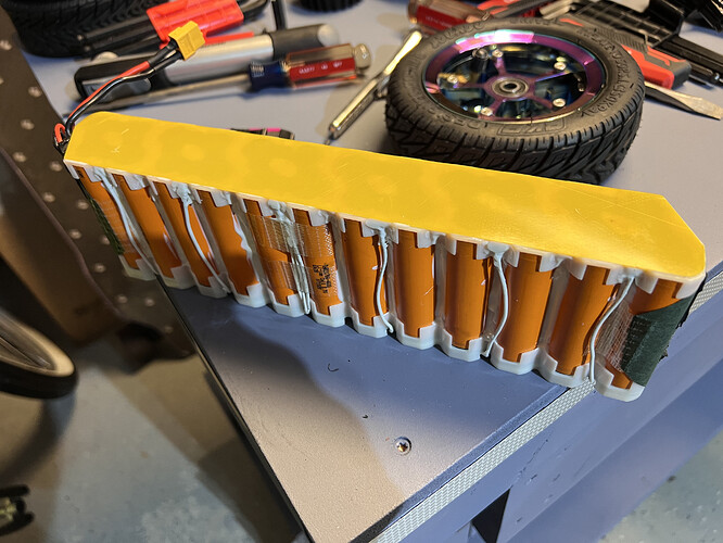

Whatever it is, I want to try and test it just to find out. I pulled it out of the board tonight and took the shrink wrap off to get a look at it. I’ve got a multimeter. Is there anything I can do to test this? I’m sure it’s probably toast, but I am curious anyways.

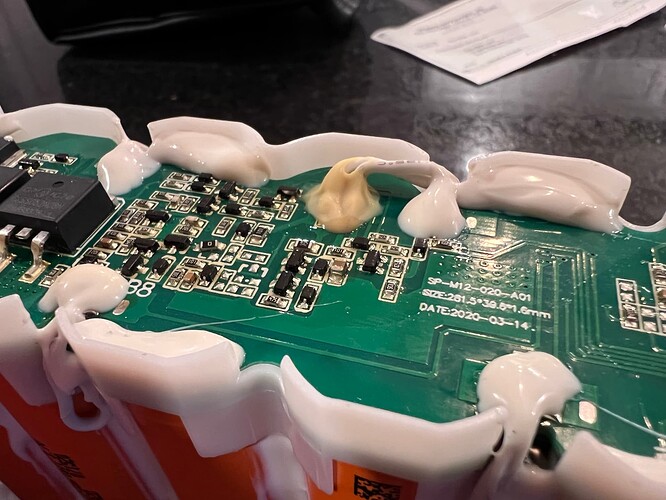

This BMS is wired for discharge, I recently encountered a pack with the same issues. Check for damage around this area.
If nothing is visually damaged, manually check the cells with a multimeter.
If the cells are good, backfire can send you a new bms for 50$. A bypassed daly might be a better option though.

How do I go about testing each cell with the big goofy PCB board on top? I don’t see any visible damage on the board where you mentioned.
There are balance tabs under the “glue” on the pcb, you should be able to measure those if you take it off. Its the white stuff on the pcb where its says B1, B2, B3 etc.
Don’t know how I didn’t see this at first but yes there does appear to be one “glue” spot that is yellowed near group 7. I see it’s the same in your photo. Is that the damage you were referring to?
Not specifically, if you look at my picture the entire balance circuitry has burned up. But the same “glue” spot is also yellowish now that I look at it.
IMHO that looks too evenly tinted to be heat damage (which would probably concentrate any color change near the pcb).
Is the hardness of the beige/tan goop the same as the white goop? If not they might be different materials to provide different degrees of flex, anchoring, and/or insulation.

Where I have circled in red, is there any yellowing of the white silkscreen lines on the pcb? It’s hard to be sure but it looks like there might be some yellowing there. That would indicate components that got wayyyyy too hot (for those types of components).
Not from what I can see - the silkscreen looks white in person (same as the rest of the board). That yellow goop must be a different material because it is hard compared to the other white goop which is soft (like silicone).
There’s a closeup of that particular spot.
