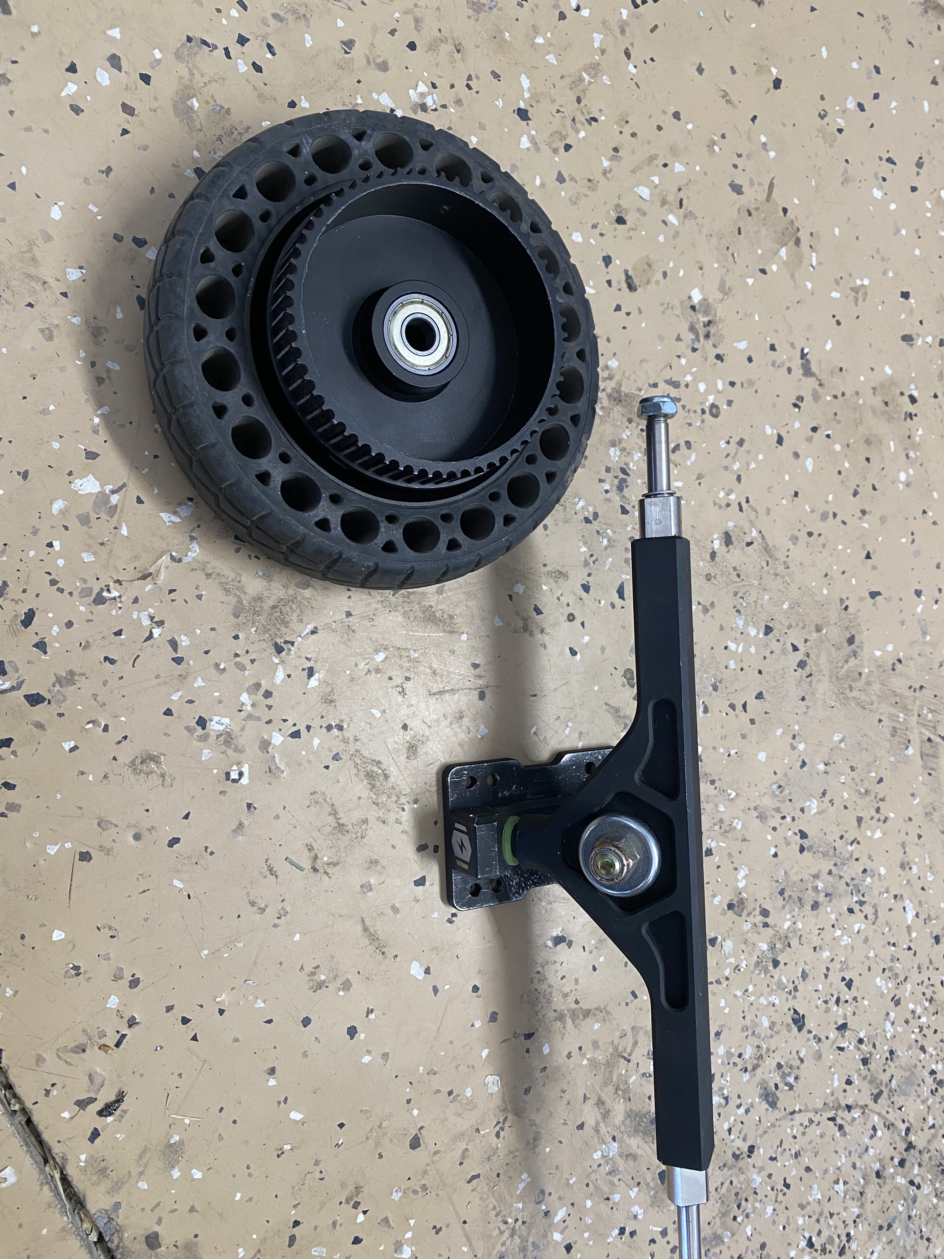

I picked up a set of these trucks recently used. It doesn’t appear that they ever brought the variety of axles to market that they originally intended. I would like to know if it’s possible to get axles elsewhere. Any other ways that would allow the evolve / ownboard AT wheels and press fit pulleys to work? This would be a 10mm shoulder with 8mm shaft that is so common in the RKP world.
Should I abandon trying to make this work?
cant u just change out the bearing in the pulley to make it fit on 8mm axle?
Yeah try changing the pulley bearing from a “6900ZZ” to a “608ZZ”
Ownboard makes a non inflatable set (seen here) that I actually really enjoy riding on. I think the pulley bearing is 26Mm OD 10mm ID/bore. Getting a 26mm/8mm is a bit strange, but even if I located one the shaft length seems to come up short. I have some TB AT hubs that need longer axles.

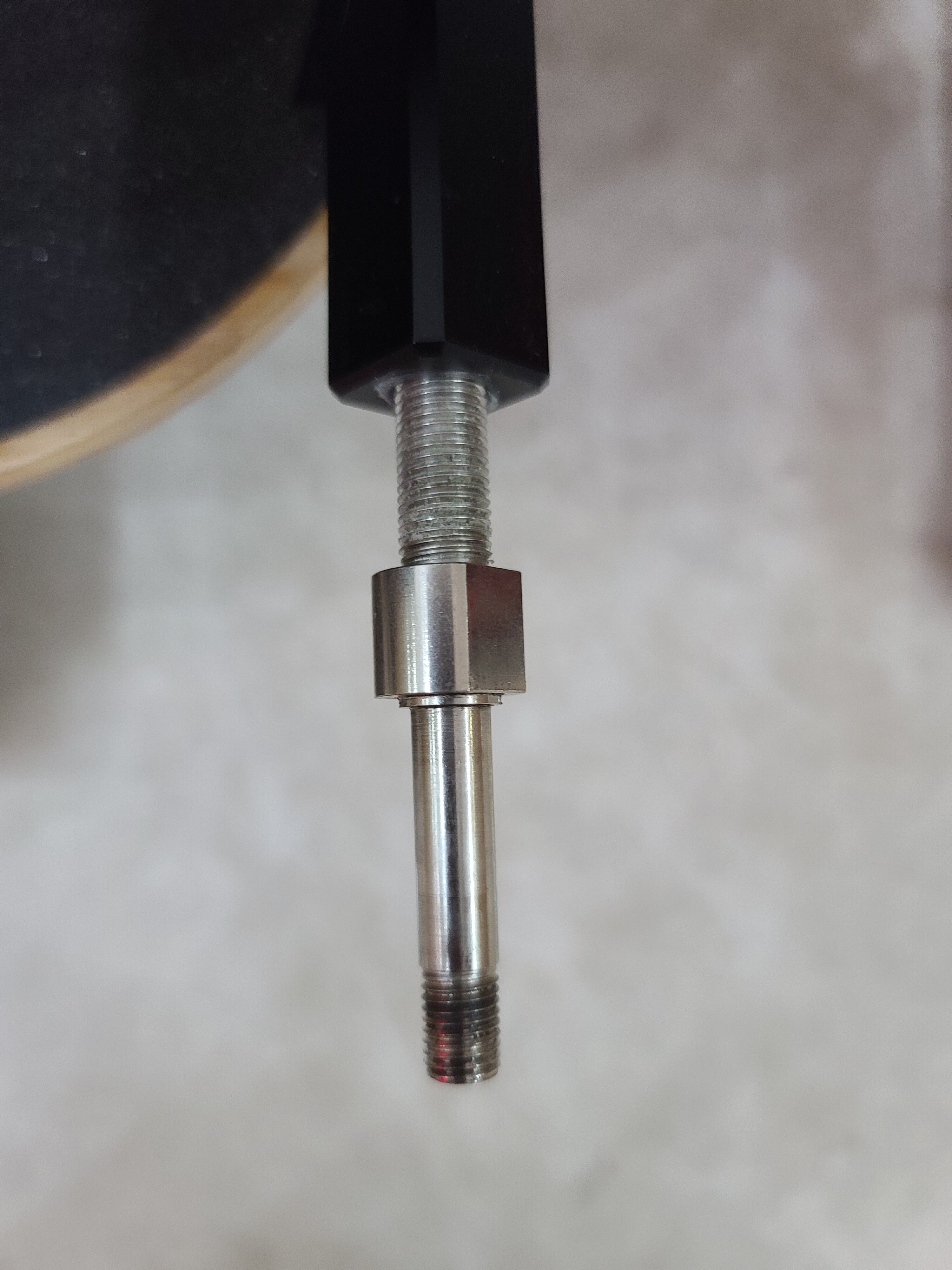

If they’re M8 then I have good news for yoh
they are
Then congratulations, I have 10mm solid axles or 10mm stepped to 8mm. Both install with a 5mm hex key :slight_smile:

The deapth wheel / pulley combo is way deeper than the approx 1.25 portion of 8mm shaft from shoulder to tip of thread. I need something more like 2” for the length.
See the pic and give me your wisdom
Ideally you want a spacer bridge from the axle nut to the hanger face. That way, the nut can be tightened down hard without any binding.
Without knowing all the dimensions, it’s hard to say exactly what would work. Usually there are several configurations that work.

Also if you email Tb, they have longer axles to fit their at wheels. Just not on the site.
So @Boardnamics, you have extended axles for these badbois?
If they’re M8 thread and 10mm diameter where they go in, I do

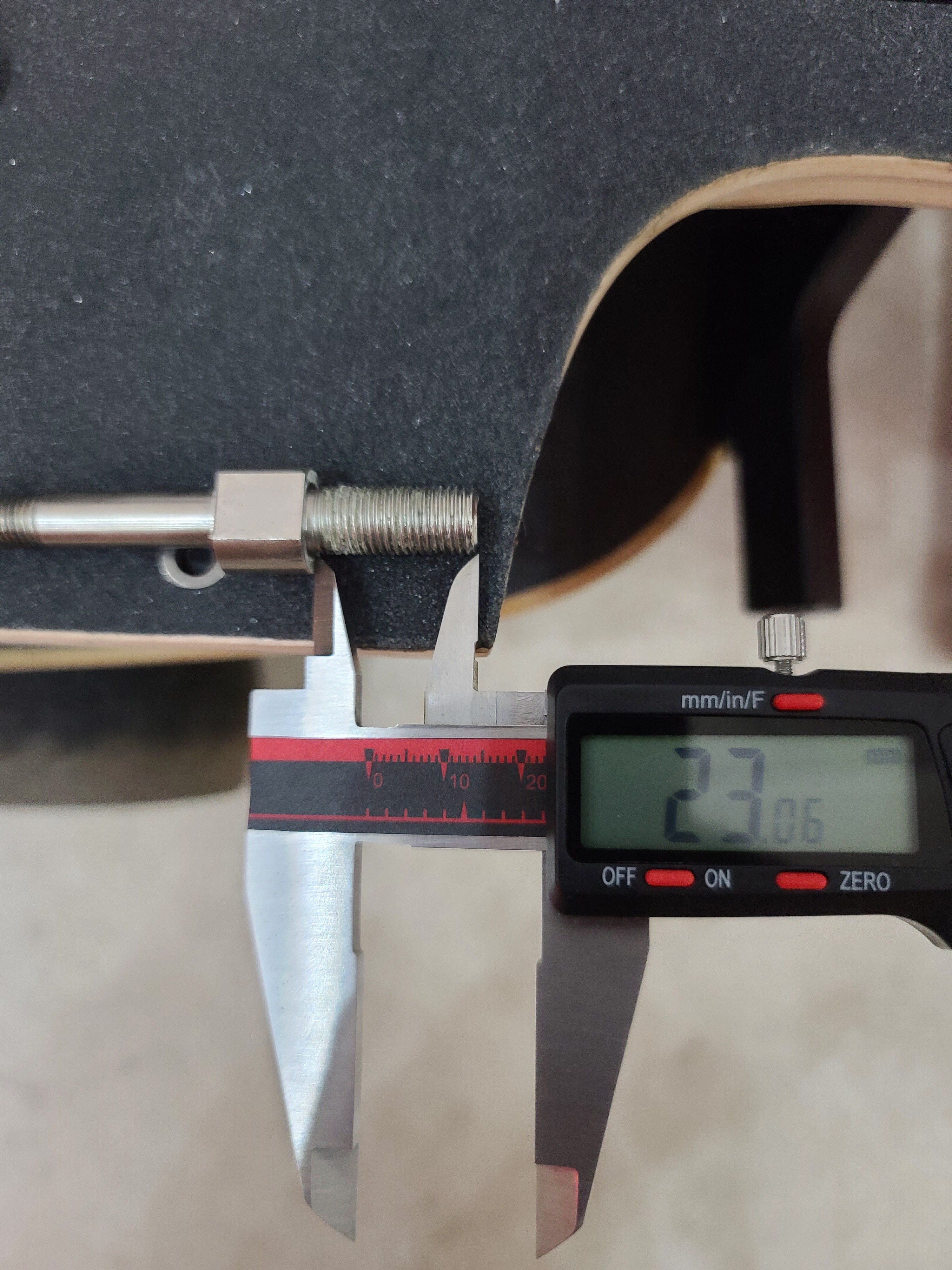

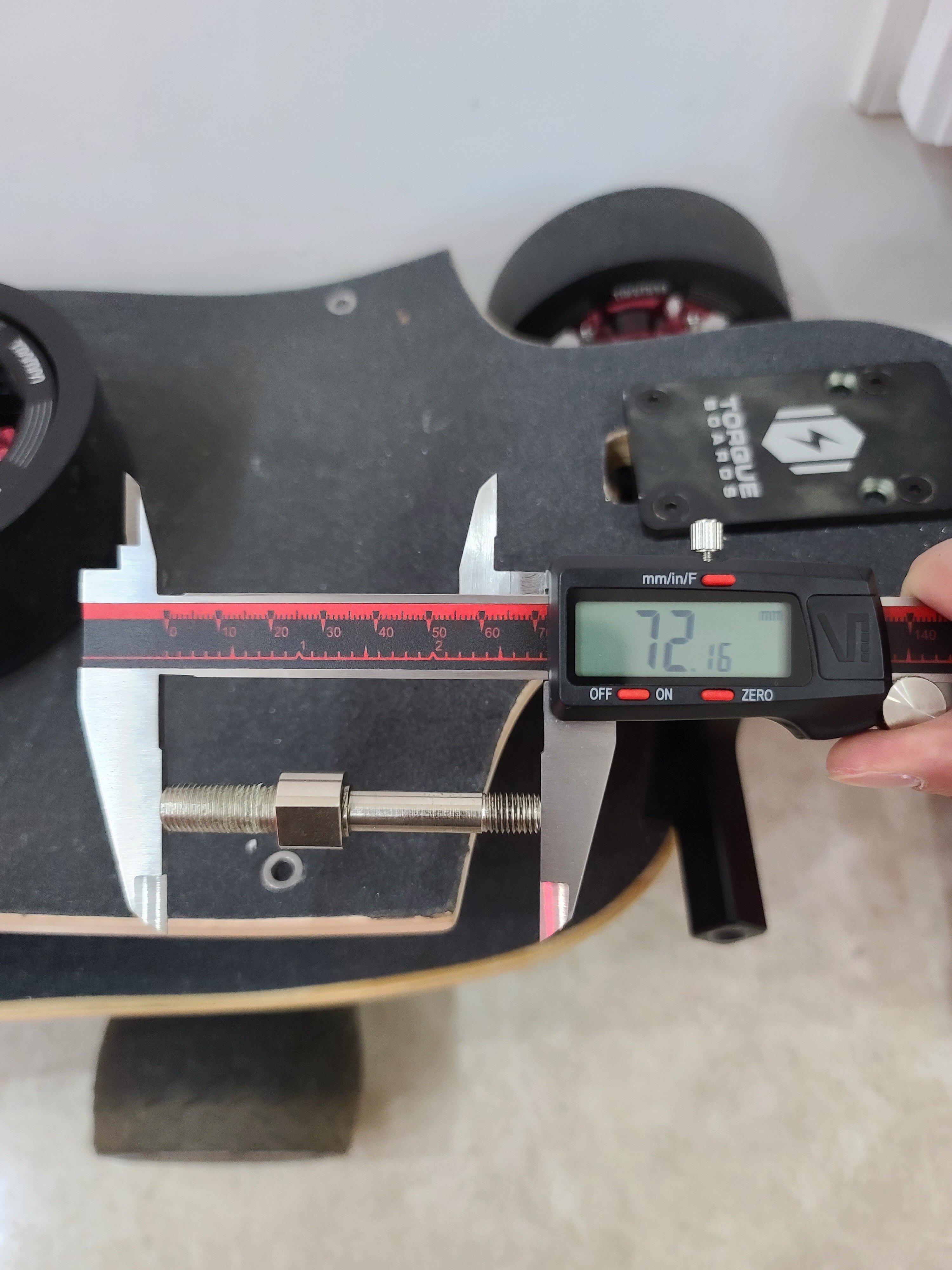

what’s axle length u got if they fit in the thread
I don’t know actually. I know the bolt is 97mm long in total (not including the M8 thread that goes into the hanger) It’s 97mm - whatever the hanger hole is.
They’re 60mm overall when on my hangers.
@Lionpuncher i have two versions. Both will be $35 for a set of four
