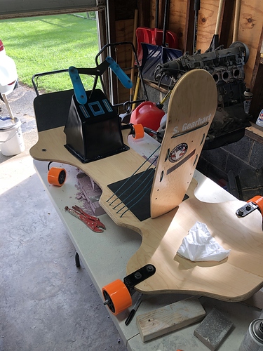

AWD Eskate-Kart | 100kv Maytech hubs | 4.12 FSESC's | Left and Right throttles
Adding a layer of foam to the bottom lip of the enclosure and finalizing the packing of all the electronics… maybe I’ll film the feature video and drive the final version tomorrow!? Who knows

My wonder is if it makes sense to keep any of the esk8 style lean to steer rear wheels in addition to a steering wheel/ackerman up front.
If anyone wants to talk a lot on this jump to this thread making it the DIY esk8 go kart wombo combo.
in my head I had originally thought that putting a seat and bars on the right deck with really wide trucks would be the way to do it. that would still be fun but seeing this done makes me want to look at actual karts.
but what you’re talking about makes me think of linkage going from steering to the seat which can allow you to lean-steer while holding onto something fixed.
using purely modded esk8 parts getting a steering wheel would involve like a chain and sprocket or steel cable attached to the hanger then some linkage.
If you wanted to be even lighter on the mods to esk8 parts needed, you could add an additional two wheels that attach to the steering wheel. All one unit you strap onto an existing board. When you turn the steering wheel the additional wheels force the board into a turn.
Was thinking of simply adding some pedals to a long front hanger.
