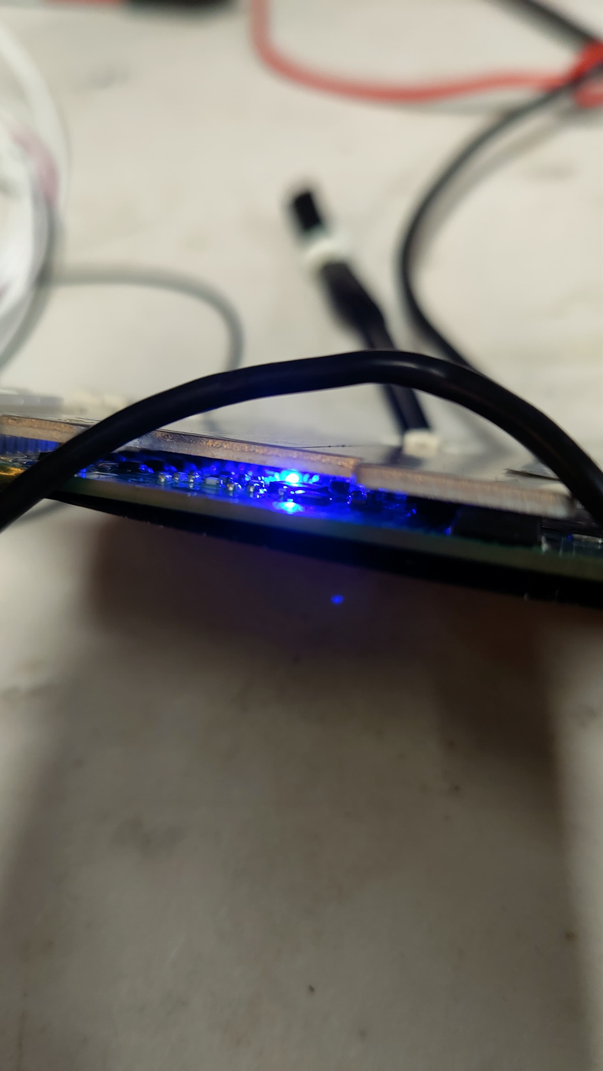

Hi, is anyone using the new version jbd bt bms with the auto voltage detection?
Just wondering if the Bluetooth sleeps after it’s disconnect from the app?
I noticed the blue led onboard is still blinking at least 10 mins after I disconnected, I’m concerned it might draw more power when not in use more so than the older versions. Admittedly I haven’t put a meter on it to test any extra current draw.
Have you completely closed the app on your phone?
The light should turn off after 30 seconds i’m pretty sure .
Yeah, I unlinked and closed the app.
The older version with the separate dongle switched off after closing the app
