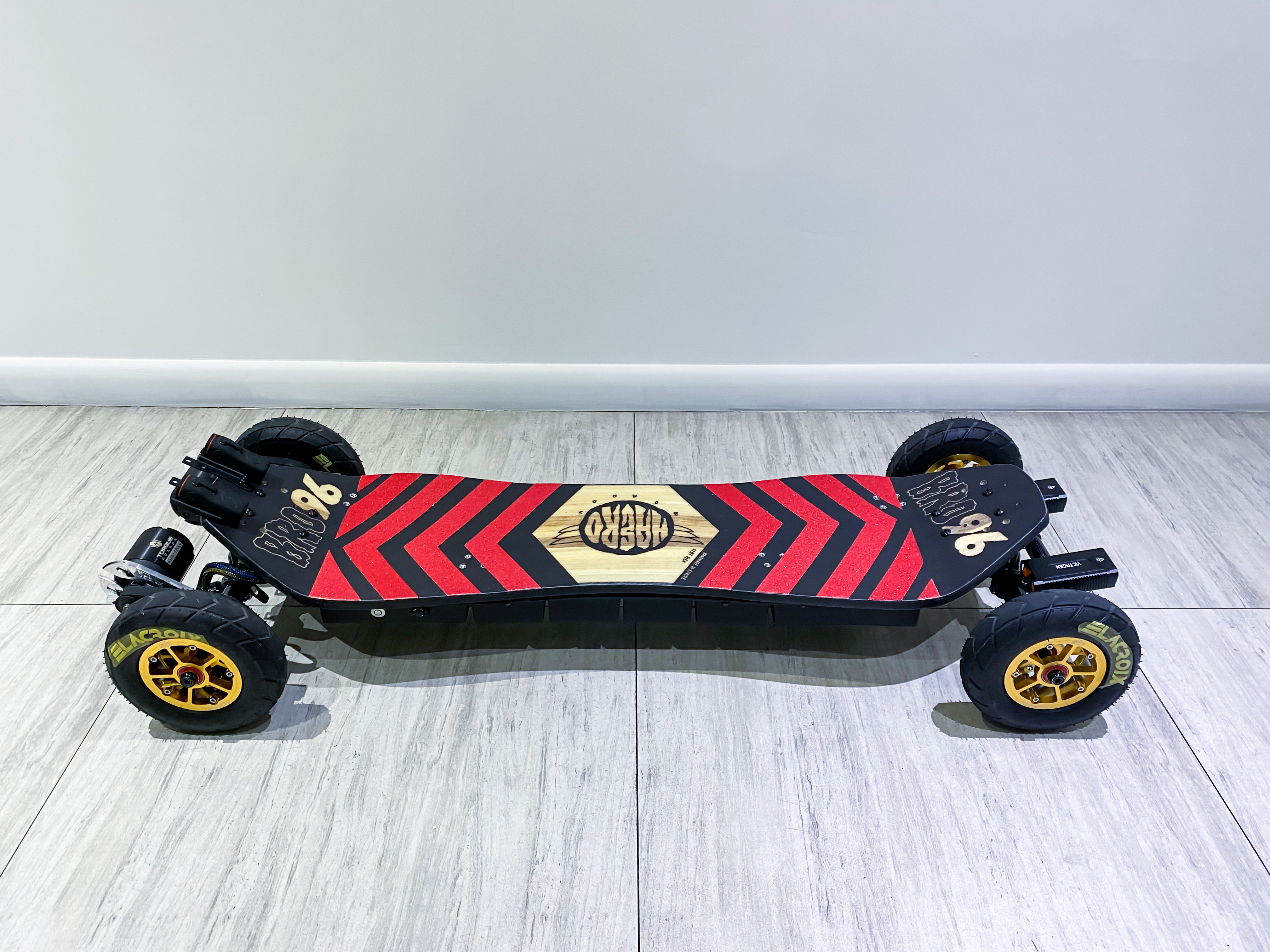

It’s been a long time coming, but I’m stoked to finally be able to share with you the Aurum Bro Build. :call_me_hand:t3:
Big thanks to @GJF1 for making it happen. :hammer_and_wrench:
I love my GTR bamboo deck, so I knew I wanted something similar, but with less of a defined concave design. The Haero Bro deck delivers everything I could have asked for and more; flat wide underfoot with concave lips locking you in perfectly.
Dual kingpin trucks provide for fluid response and are great for carving. However, I needed something more robust, so I went with MBS Matrix II. This 2 chamber truck system has shock block wedges that provide an off-road advantage. I wanted this build to have a high end look, so I chose the MBS Rockstar Pro hubs in gold with Lacroix 7 in tires to compliment the the stunning color scheme of the deck.
Speed is one of the main reasons to go custom, so I opted for Torque Boards’ motors paired with exquisite Radium mounts that make this thing a total monster. We simply cannot forget about range, and that’s exactly why this baby packs a 12s8p Molicel battery that just takes it over the top. No more struggling to charge on group rides.
There is still some adjusting to do as I familiarize myself with the build, but I’m extremely happy with how it turned out. She already rides and feels like a dream.
Aurum Bro Build

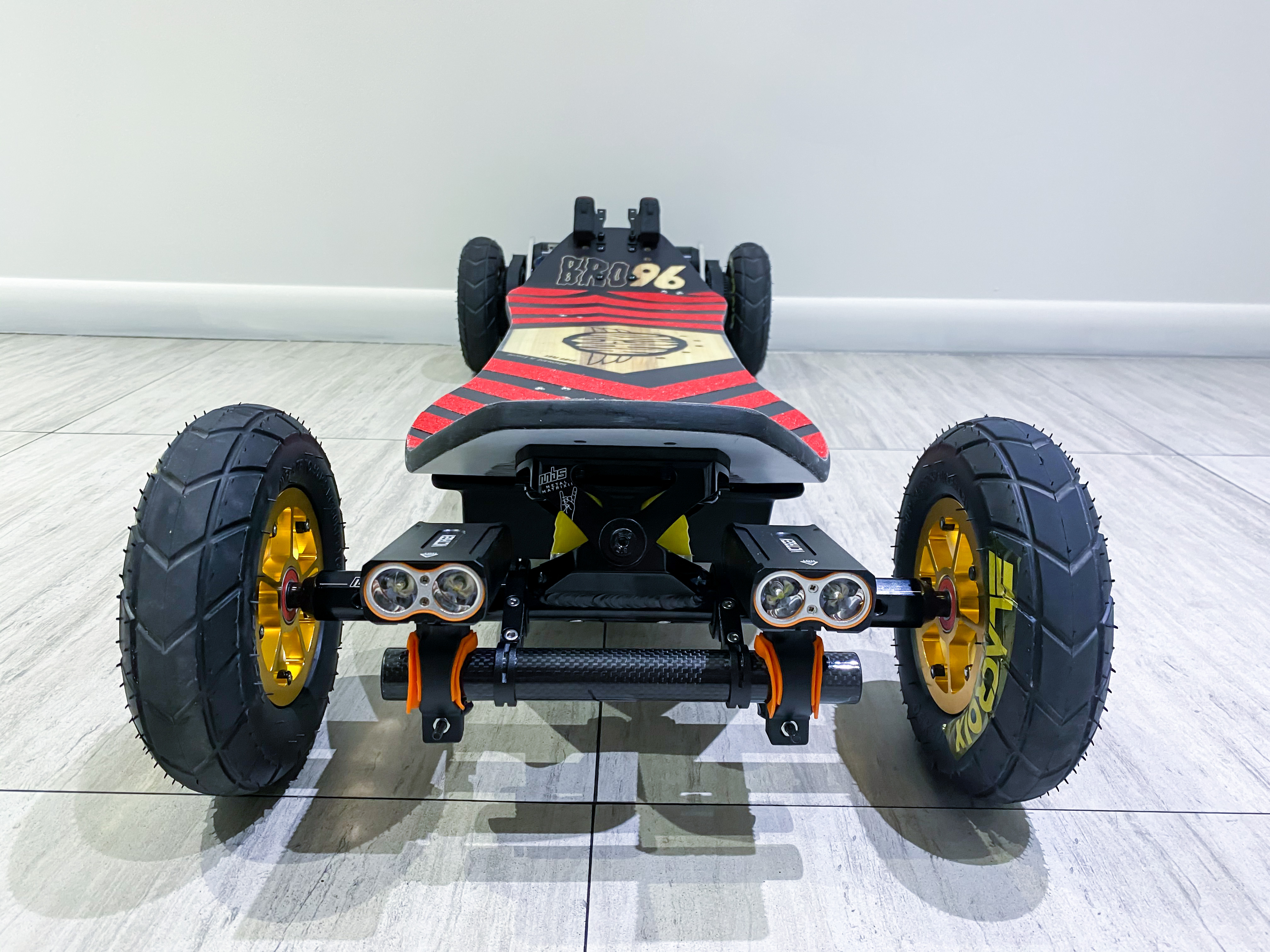

Hows the ground clearance on this? Looks pretty good from the pictures you’ve posted.

Can I ask where you got that bar up front as well as lights mounts? That’s sick.
While waiting for op, I ordered similar for dirt cheap on Ali. Still waiting of course.

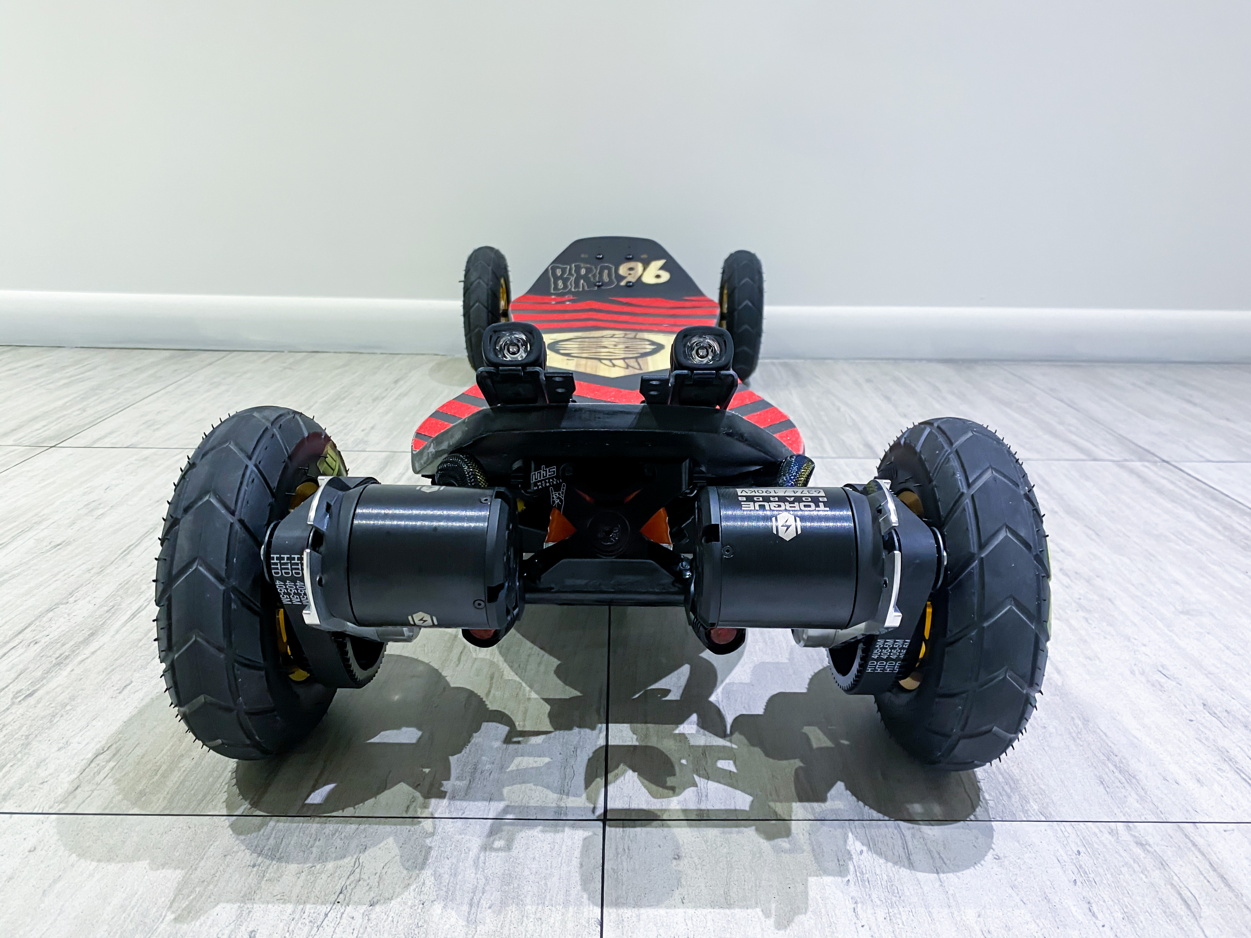

You can basically slide your foot right under the board, which is exactly the amount of clearance I was going for.
Same club but mine finally cleared customs enroute from San Fran now :laughing:
I got mine from Amazon, but the one @Venom121212 found on Ali sounds like a steal.
https://www.amazon.com/Yizhet-Handlebar-Lightweight-Motorcycle-Speedometer/dp/B07VGQTWNL/ref=sr_1_3?crid=QHZT06ZIC063&dchild=1&keywords=handlebar%2Bextender&qid=1607115536&sprefix=handlebar%2Bex%2Caps%2C184&sr=8-3&th=1
