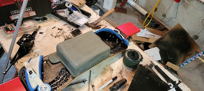

The bolts should hold ezez, only possible failure point i could see is the plates bending sideways or the holes failing, although that seems very unlikely. This build looks friggin dope! Love the diy.

I’d gladly do the actual calculations and show just how much force is on each of those pins - theres a difference between armchair engineering, and understanding the principles at play here. Nothing against the OP - it just seems like the two pin mounting is close together, for very little reason. Moving the pins further apart would significantly reduce the bending moment generated.
The lever arm between the two pins is quite short, by eye it looks like 30mm or less. Assuming a rider weight of 100kg, and an even split of weight distribution front to back, each side has to handle 50kg, split across the two sides thats 25kg per interface. The truck mounting is spaced pretty far from the pins, I’m going to make an assumption of about 150mm distance to the first pin. This means the pin closest to the deck has to withstand a constant 125kg load, per side, with the fulcrum pin having to withstand 150kg of load in the opposite direction to compensate for the huge moment this lever creates. 3mm steel, and an assumed 10mm pin, ill give the benefit of the doubt of a 30mm load bearing cross section, even though it would really be much more concentrated. Doing the math, this gives us a pressure load of 49 MPa on that steel plate/fulcrum pin contact face, for a purely static load, with perfect weight distribution and idealized contact faces. For shear force, the cross section of that tube is about 20mm^2 or less, resulting in a shear load of 80MPa. With regular steel limits being around 300-400MPa on shear force, a safety factor of only 3.75 for a purely static load is cutting it quite close. In the real world, you’d be dealing with a significantly higher dynamic load, with weight distribution never perfectly even, and the loading being concentrated onto much smaller cross sections. With dynamic loading being potentially orders of magnitudes higher, and the repeated vibration/shock something like this would undergo, fatigue wear could become an issue.

With all due respect - did you actually read through the math and explanation, or just emote and then reply? The issue here would be wear over time, with repeated cyclic loading deforming parts and introducing plastic deformation little by little, and wearing out the interfaces. That tube cross section is only about 20mm^2, with a significant load on it. The shear force load would be immense.

The rider load is assumed to be centered in the deck. Each end of the deck holds half the full load. Each end of the deck has two sides, which interface onto the endplate via the pins.

At the end of the day, its your board and your life - just seems like thats a lot of load for those components the way the pins are arranged.

Working on temparary top mount 12s4p enclosure. Will bolt through binding holes.
