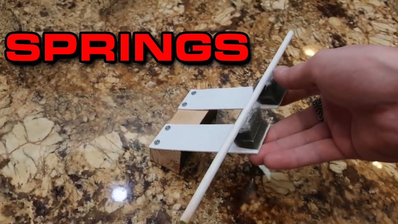

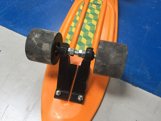

Here is the first video I made, with the original proof of concept:

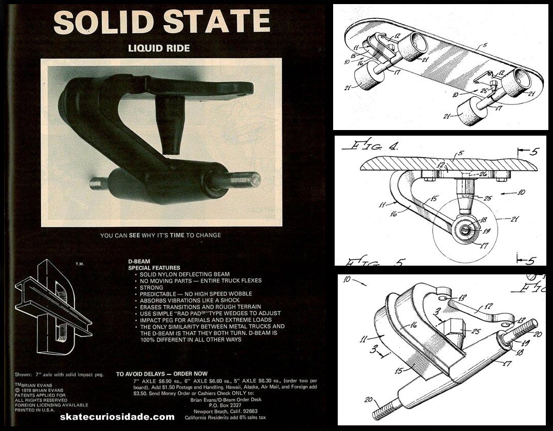

For years even prior to this, I’d been playing around with torsion trucks, and had been completely stumped on how to make torsion springs trucks work without breaking.
Designs like this have been around since the 70’s, and I’d been fascinated by them for a while.
But they never took off for several reasons, but the biggest is because they break.
This proof of concept video was the big “Aha!” moment, where I realized what was actually going on to cause this style to never work out. And with a fresh new lead, I started out making.

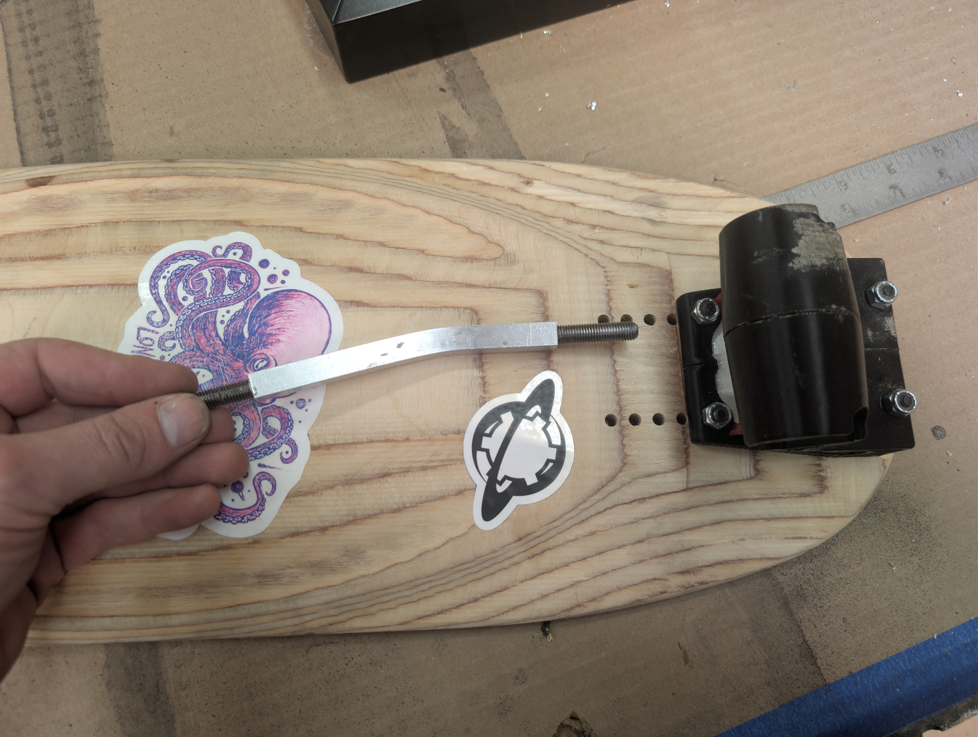

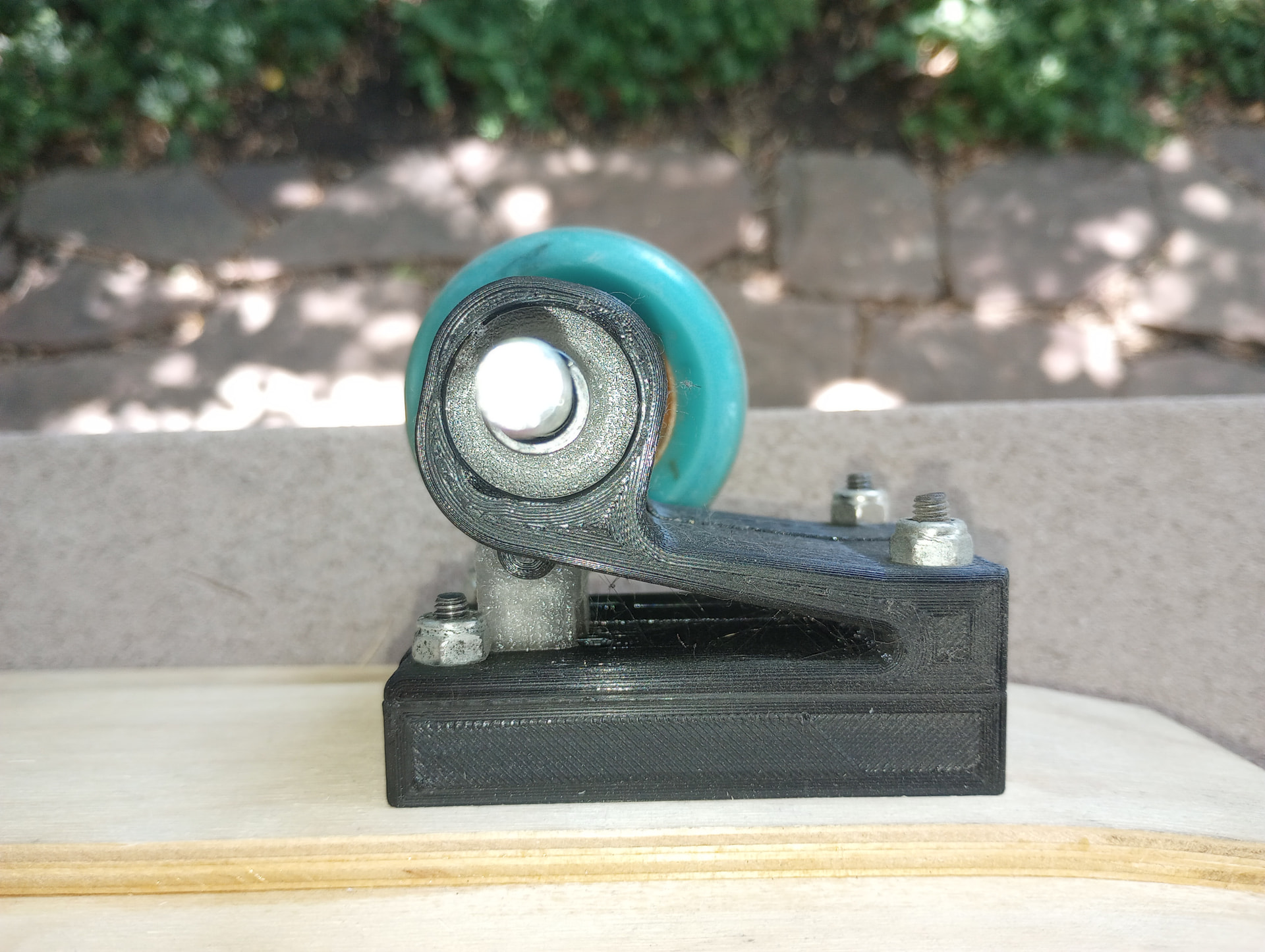

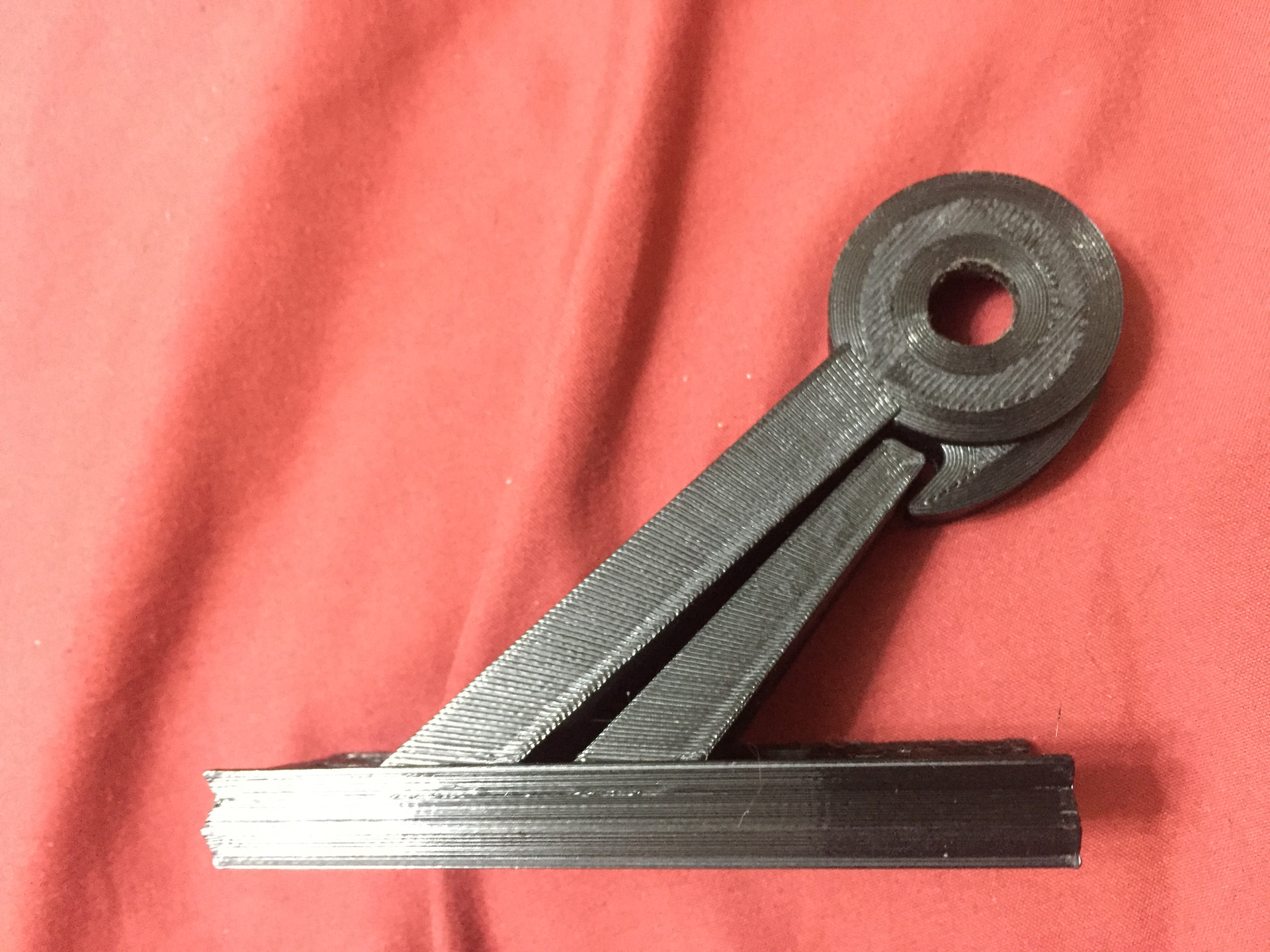

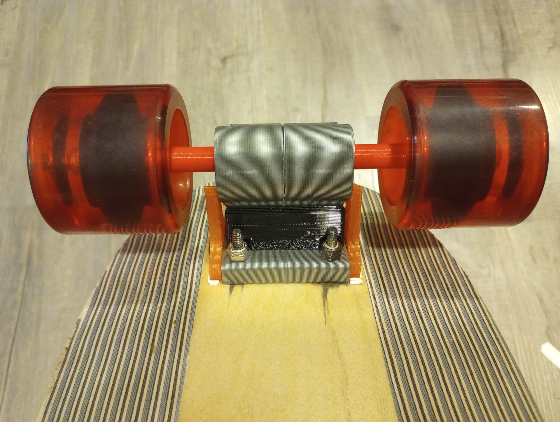

I’ve been neglecting to update this thread, so he’s some pictures.
First “ridable” prototype.
Secondary Spring idea
The whole assembly.

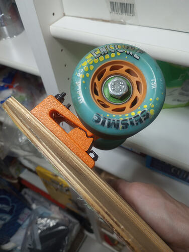

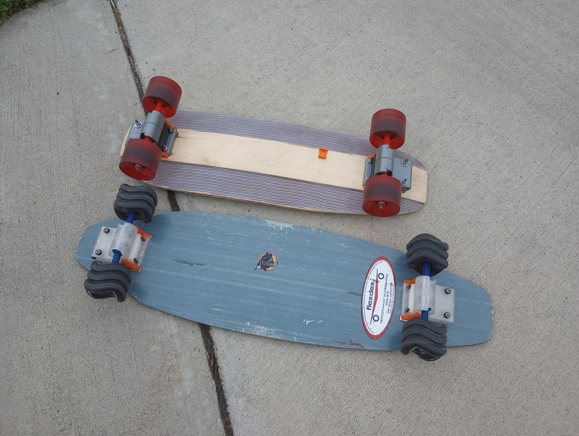

After a lot of work and several years I reached this point.

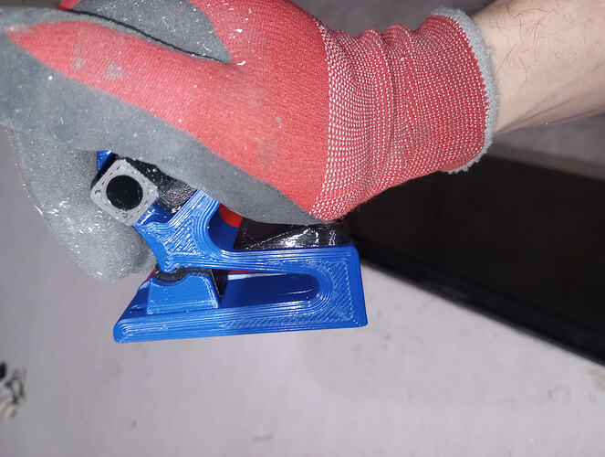

Secondary spring replaced with a urethane block. Polyurethane ball joints.
Testing “Wings” to limit lean.
Looking slick.
Testing reduced “wings” to limit lean and prevent hyperextension of the springs.
Worlds most comfortable Mall Grab.

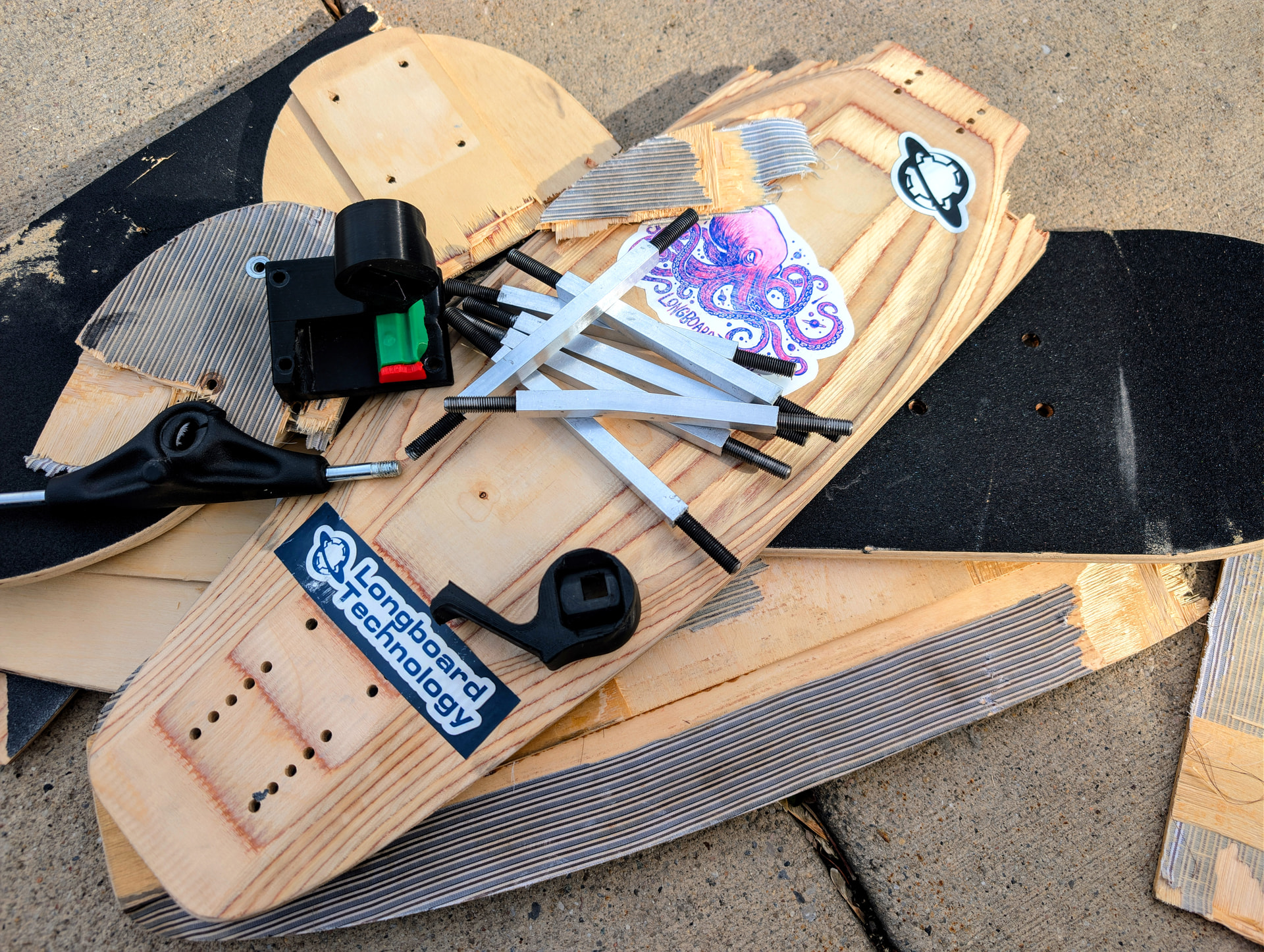

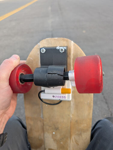

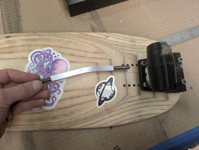

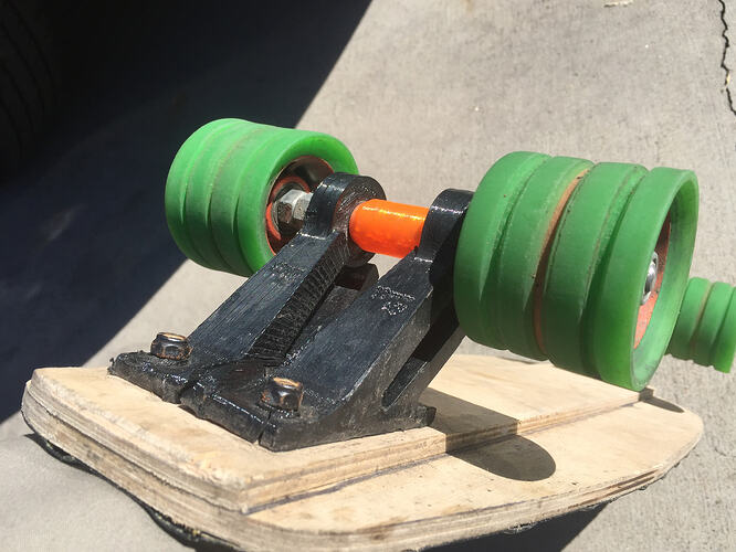

Destructive Testing.
Many bent axles, broken trucks, and busted decks later.

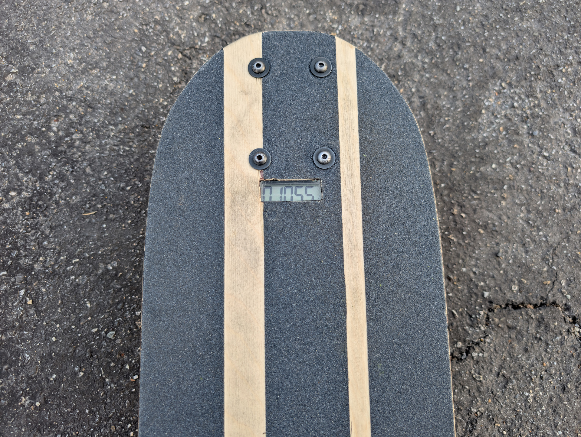

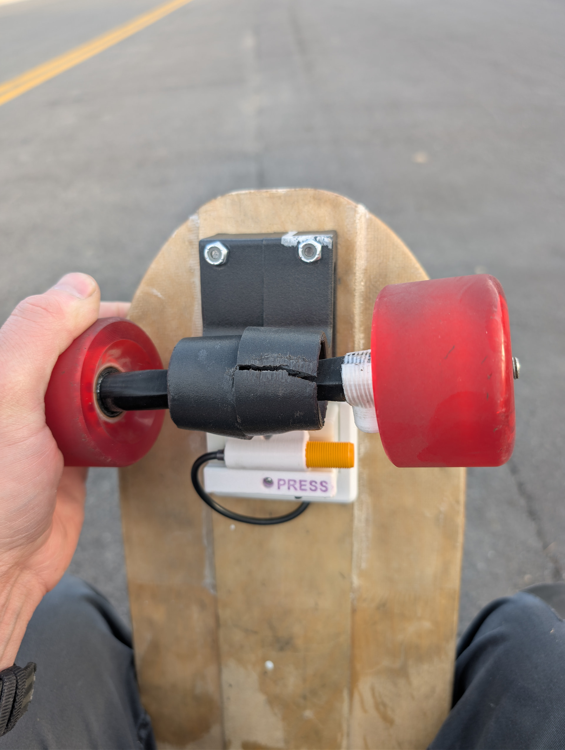

My “Carve-O-Meter” for fatigue testing.
Truck reached failure after 1055 carves, but this truck started the test already cracked from previous brunt force trauma during last testing round.

Is that “carve-o-meter” an inductive sensor with a magnet taped onto the hanger? Pretty creative solution, love it!
Yes. I was looking browsing different counters and I came across this thing which comes as a kit for $15.
And when I saw it, I knew I wanted it showing the counter on the deck itself.
Its super fun because I show it to people, and everyone wants to put a few carves on it to make it go up. So its made it a lot easier to get people to try the trucks.
