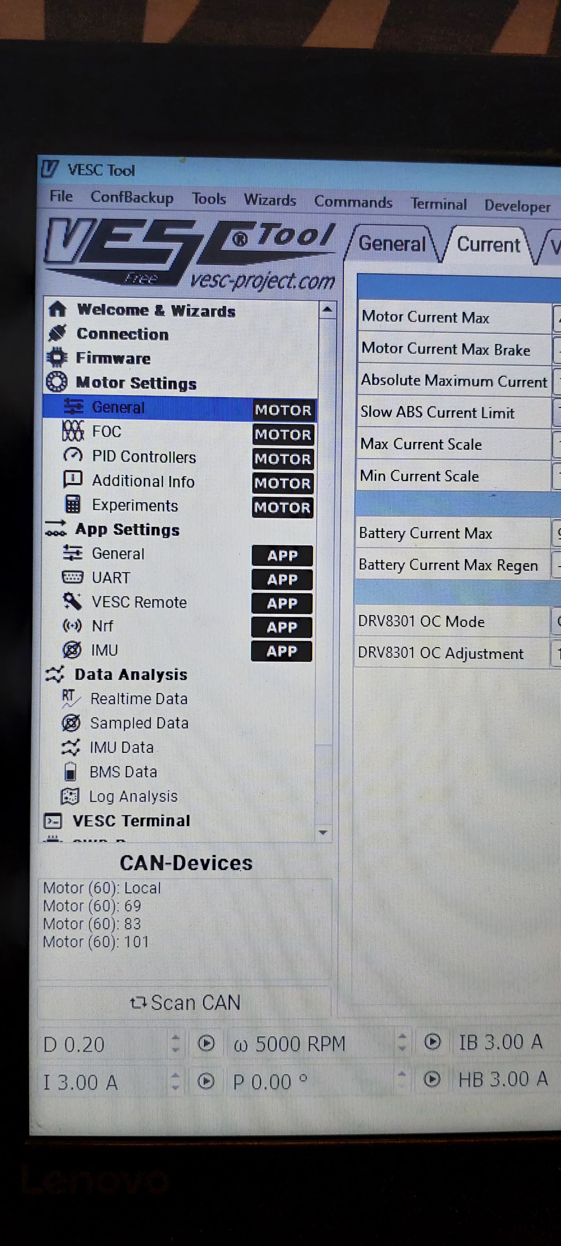

I realised today that i needed to build a jig to support the running gear while its detached from the deck to run the first detections
I went.through and connected all rhe hall sensors and phase wires and added clear heat shrink. Im thinking of running a sleeve over all the cables but thats all polish and not important right now…
