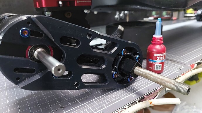

Gettimg there by degrees… had some assistance with the antisparks after i torched one, still not quite sure why vut i was very nervous about doing it a second time, much thanks to @Tony_Stark for all the assistance.
This is all still pretty loose and not in final locations obvoiusly.
Started final fitment and tightening things down…
Got a protractor out to try and work out the angles, had fun just finding one and rage quit searching the interwebs for the answer… you’d think a couple of markings on the adjustable plates wouldnt be too difficult.

After a number of icidents around wiring in antispark switches unsuccessfully… spactacularly set fire to one in fact… ive had to have a other think about how to wire this thing up… its amazing how many changes of direction for one reason or.another ive had to take.
Ive been advised to have a think about these
I have some significant trust issues when it comes to anything coming from Flupsky but am happy to be convinced its the best way to go. I was playing around with connection tho and thought id run this past
Isn’t this an alternative thats both safer and cheaper? If i dont have trust in the antispark switches to not fail, then it needs a loop key too… if it needs a loop key, doesnt it not really need the 2 antisparks switches? It seems to me like a whole lot of connections and headache when i can just use a 120A fuse on each controller and run with the loop key.
Seems to me that there are advantages to both ways only with the loop key it limits the extra connections and additiinal hardware/risk.
Think of a loopkey as a circuit interrupter/breaker. In the photo above you’re missing the black negative between batt XT-90 and the loopkey.
As for antisparks, that’s the wrong one. You want the Flipsky “Enhanced” version shown here:
The “Pro” version is prone to failure.
I run a couple of these and they work well with roll-to-start and auto shutdown. They do have a small passive drain you need to keep your eye on, though.
Do you think there is an advantage to adding them? Id prefer to just use the loop key if it doesnt matter and keep Flipsky out of my board altogether. Initially i wanted to have both a switch and loopkey but now that my options are restricted as far as antisparks go, i think id rather just do without for now.
I guess technically the 120A fuses are also flipsky…
There’s no question that a loopkey is best. No idle drain, no chance of your board discharging. You just have to make sure you remove it after riding. I run one in my nicest board. I’m just a lazy piece of human garbage, so the others get antisparks.
