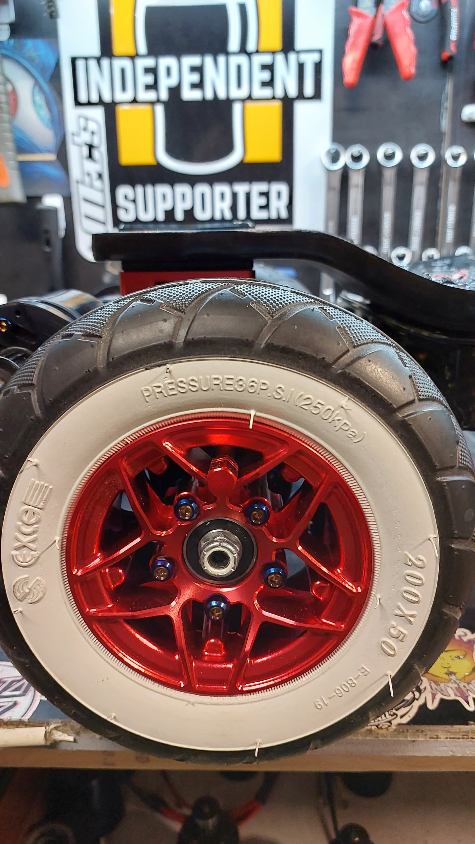

Personally i would keep the white wall tires, but looking good!
@rusins I dont rekon they’ll last very long, they dont have a very deep pattern to them and I only got one set to test them… they should last long enough for the glam shoot tho

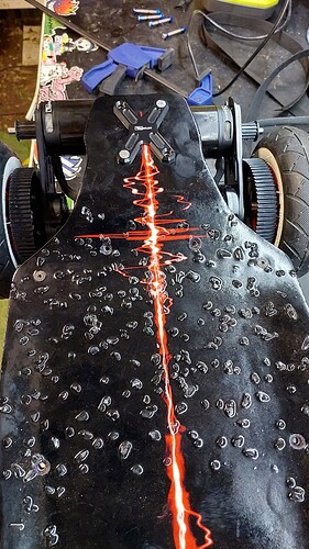

One side unheated
Looks dope. I was lazily and just covered mine in glue, but respect the dedication to a perfect board.
