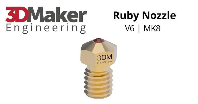

I will be getting the ruby nozzle from 3dME and heat break from amazon, but I don’t really know which heat break to get. You mentioned the solid titanium but there’s quite a few on amazon and hard to tell which is good.
Would you be willing to help me out with a list of things you think I would need to do to print cf nylon frequently?
I could still consider the slice bimetal, because I still want the ability to print PLA+

I’d recommend going all out with a tungsten carbide nozzle instead of Ruby in 0.8mm if you wanna make super duper strong prints with abrasive material.
Found multiple reports of clogged ruby nozzles
Well I guess I’ll see how the ruby goes, with the new hot block it should be easy enough to swap out a nozzle
What kind of extruder setup were these reports on?
The tungsten carbide ones still wear down - and I’m not sure I want to go all the way to 0.8, since you lose so much detail at that size
I was thinking I would maybe also pick up a 0.6mm hardened steel or tungsten carbide
If I’m right it was Hemera or similar and direct drive (so pretty powerful feed setups) but still with some filaments it fucked up pretty bad (and things were coming back to normal with brass nozzles).
While they do wear down, they still are a good mix of resistance and high temp tho.
True 0.6mm keeps a good detail level, tho I’m using 1mm nozzles now (0.4mm for very fine parts) and it does wonder for me. So I guess 0.8 would be super fast for your use while still being able to do good levels.
For example you cand downsize the lines around 0.65mm with the 0.8mm nozzle and it will be ok too. I’ve been able to print 0.8mm lines with the 1mm nozzle for example
