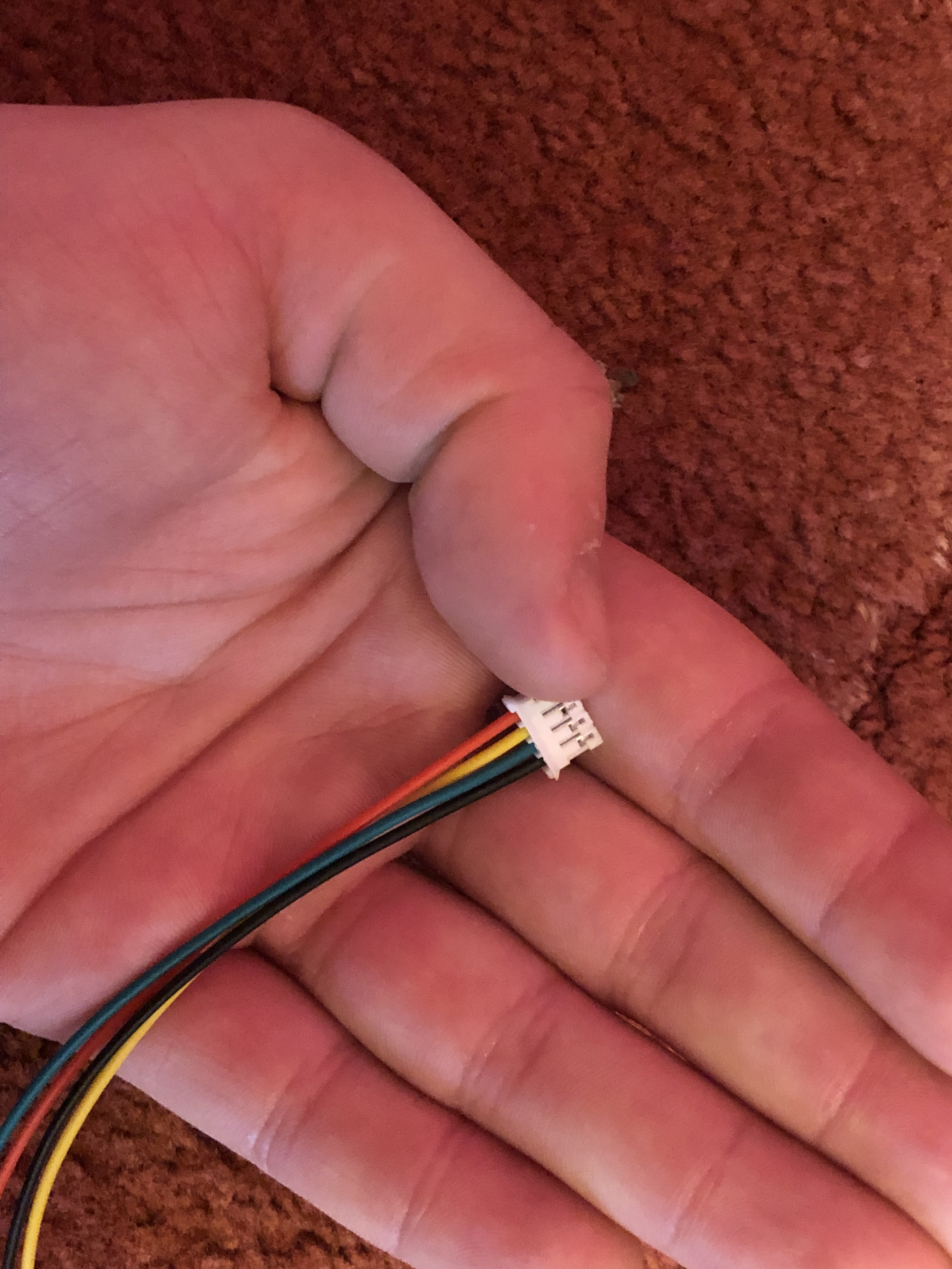

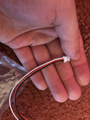

i’m converting an eovan over as their customer support wasn’t the best and the company has since went down. I bought a mboards dv4s and it came with some connectors and cables. i’m new to this and don’t know what’s what. some of its pretty obvious eg. the bullet connectors, power button, bluetooth connector etc. I have some cables which I have no idea what they are for.
i’m planning on using the original eovan motors and need to convert them to use bullet connectors and sensor cables. the bullet connectors are easy enough but I don’t know what sensor cable goes in each pin of the connector as well as if the wires that were included were motor sensor cables.
thanks

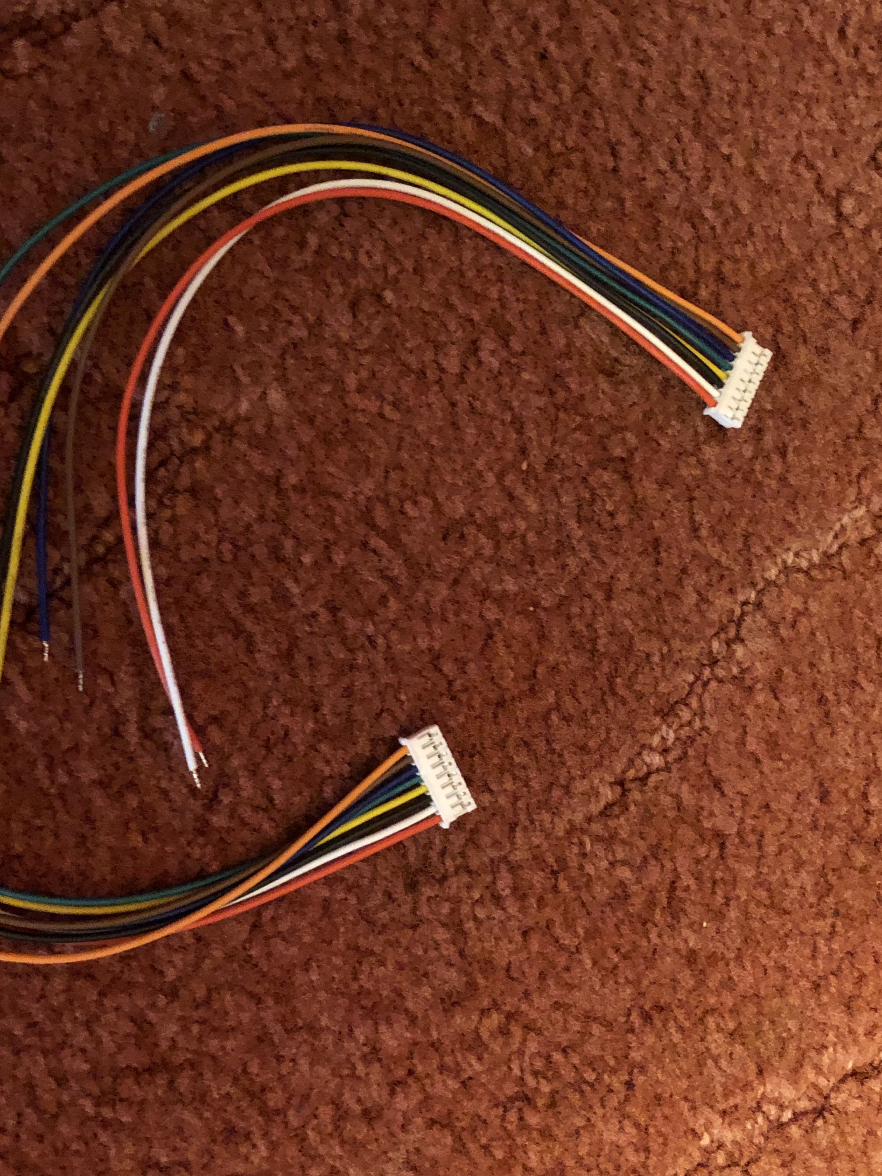

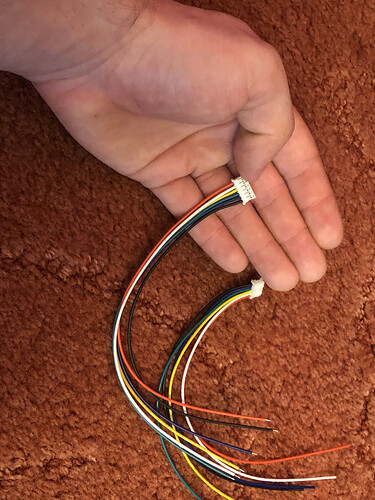

these are the different cables that came with the vesc
6 pin cable: sensors
4 pin cable: power button
3 pin cable: remote
8 pin: eludes me right now, what features does your esc/motors have?
Probably UART

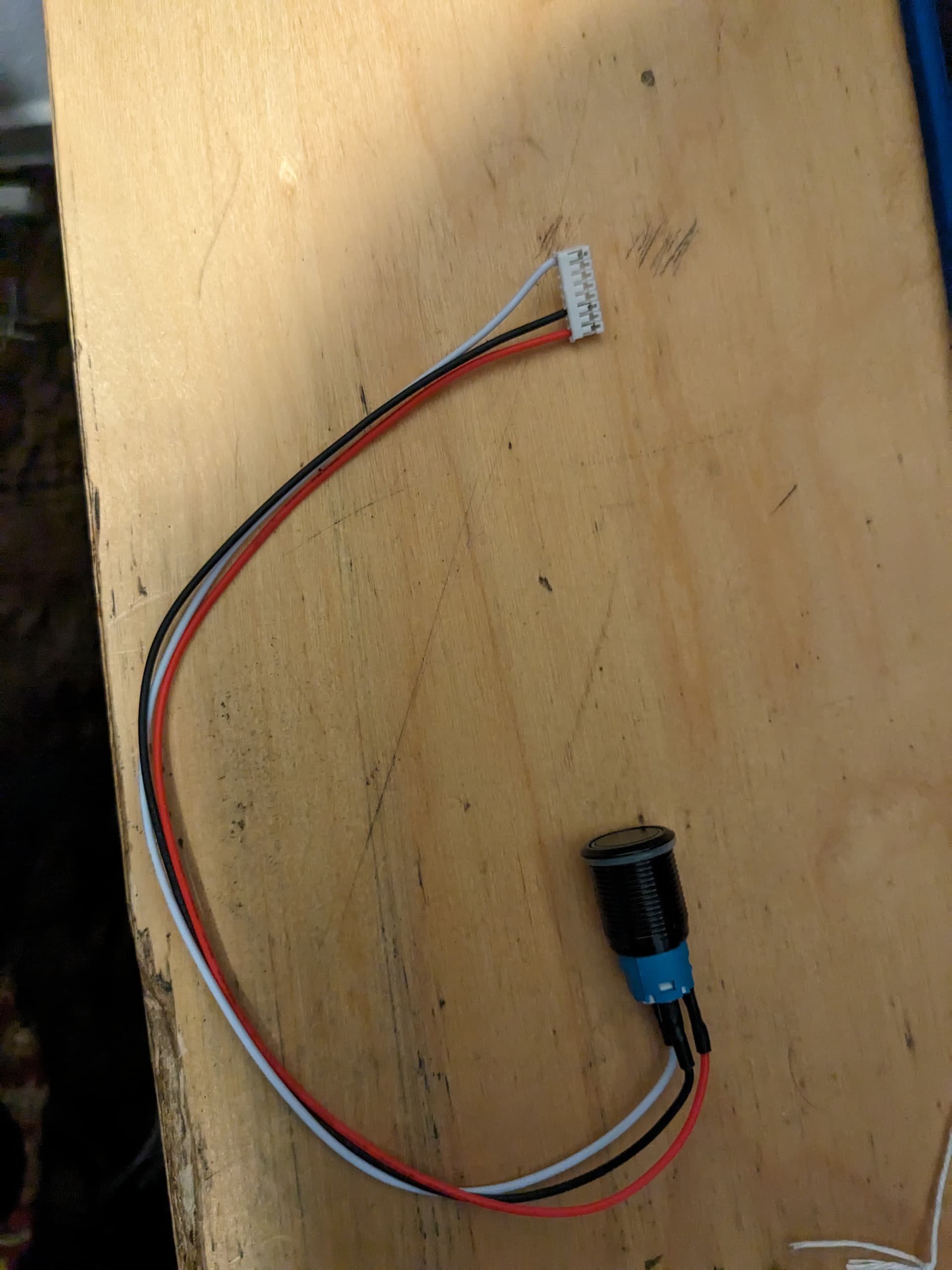

the 4 pin is a power button? the vesc came with a power button and it has 3 pin connector.
what is uart? cant seem to find alot of info in one spot.
as for the sensor cables do they have to mounted in the connector in a certain order or is it correct that there’s only 2 important ones and the rest can be random?

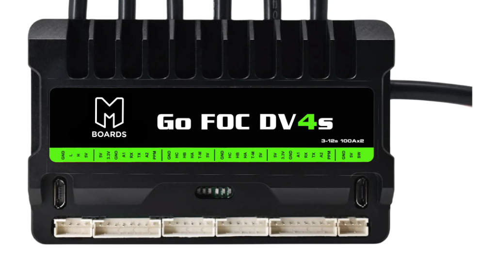

You need to find a pin-out for your esc
Look for the model number on your esc & google it + pinout, if nothing comes back maybe email the company asking for one. Or crack the case open & see if pinout is printed onto the pcb
It could be the case that the 4pin header on the esc is for the power button & the button supplied is only 3 pin. The missing pin is likely for Illumination, if your button doesn’t look like it has an LED in it that makes sense.
But posting a picture of the breakout would be best

Yes, there are occasionally changes in the pinout between versions of the same speed controller, it is worth checking either:
1: if you already have the DV4S, look at the ESC itself, each individual pin is labeled on the top.
2: if you can’t physically check the DV4S itself, you can likely email mboards support to get confirmation that the pinout from their website matches the version that you have.

It does indeed, mine is built into the 8pin uart port but I Believe later versions of the ESC have a separate 3pin switch port (I believe it’s the far right port on the ESC)
does yours not have the 3 pin connector on the far right? and did yours arrive with a power button with a cable already installed with it? mine came with a power button with a 3 pin connector. not a hell of a lot of information for any of this stuff.
My on/off button uses 3 pins out of an 8 pin connector leaving the other 5 connection points empty like this:

I believe your uart port and switch port are separate like this picture.
Notice on the far right of the mboards picture there’s a port with pins: SW 5V and GND
Does your DV4S have the SW pin inside the uart port (8pin like mine) or does yours have a separate 3pin port for SW 5V and GND like in the picture from mboards?

sorry I just saw your response. for some reason i’ve not been getting any notifications. esc has 3 pin connector that sits on the far right like in the picture. I dont have any label for sw anywhere else.
