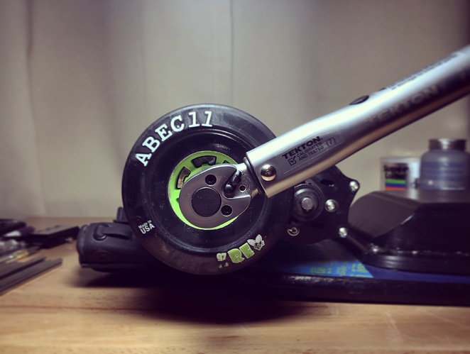

Yes I did. My math says 40nm if torque before she gives way. Ill get my neighbors torque wrench and wrench on em.

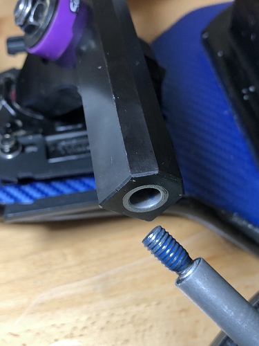

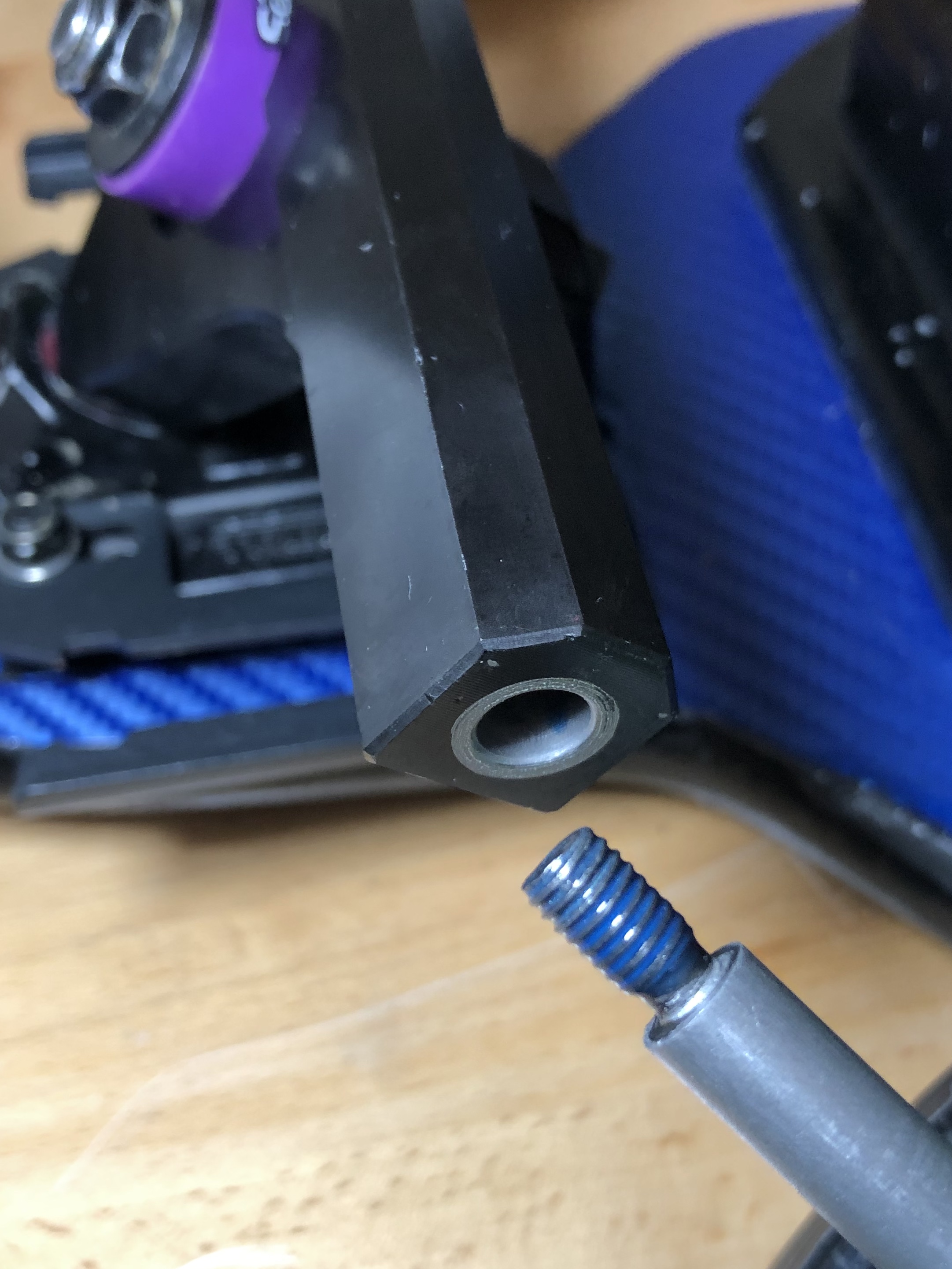

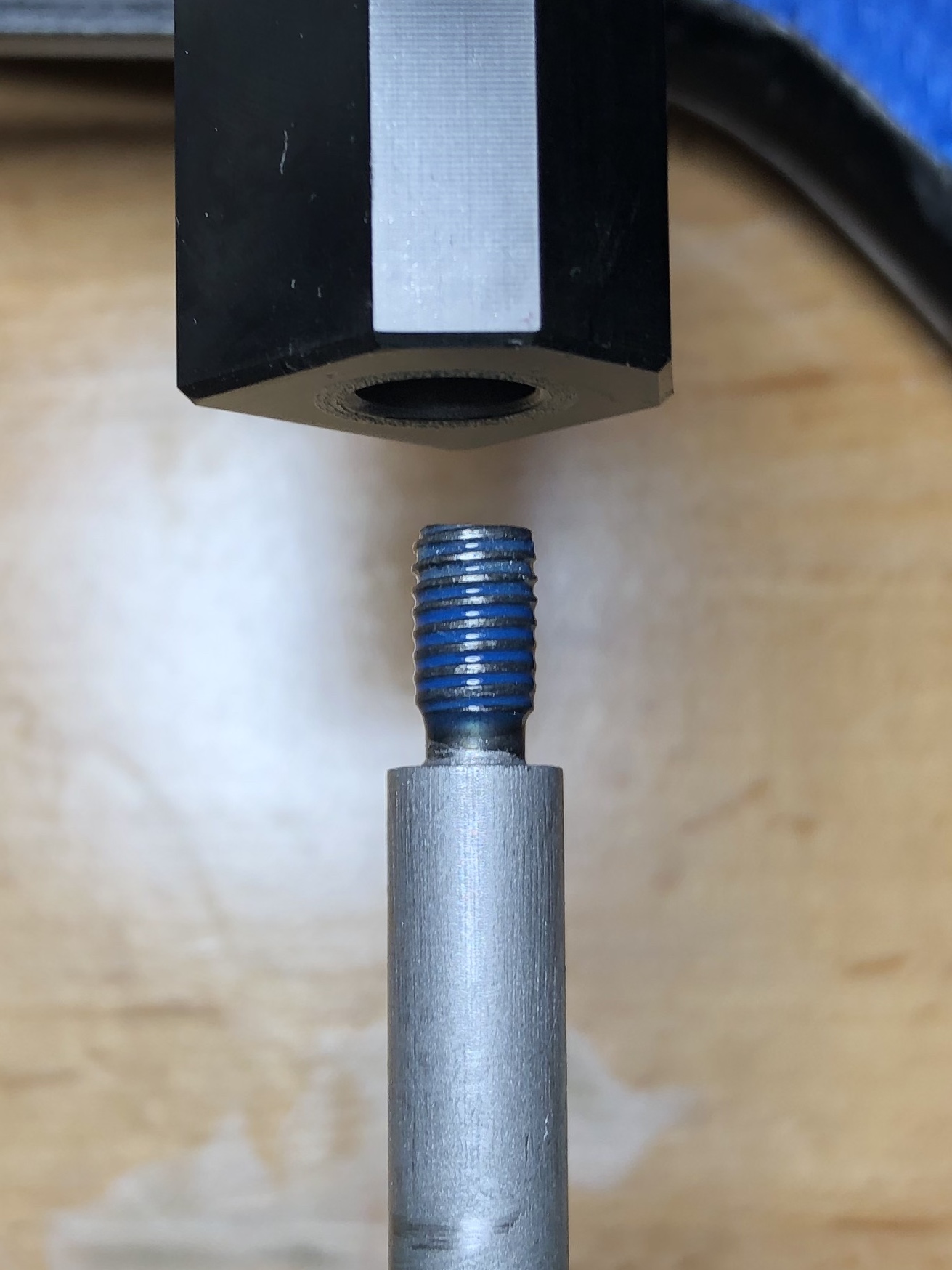

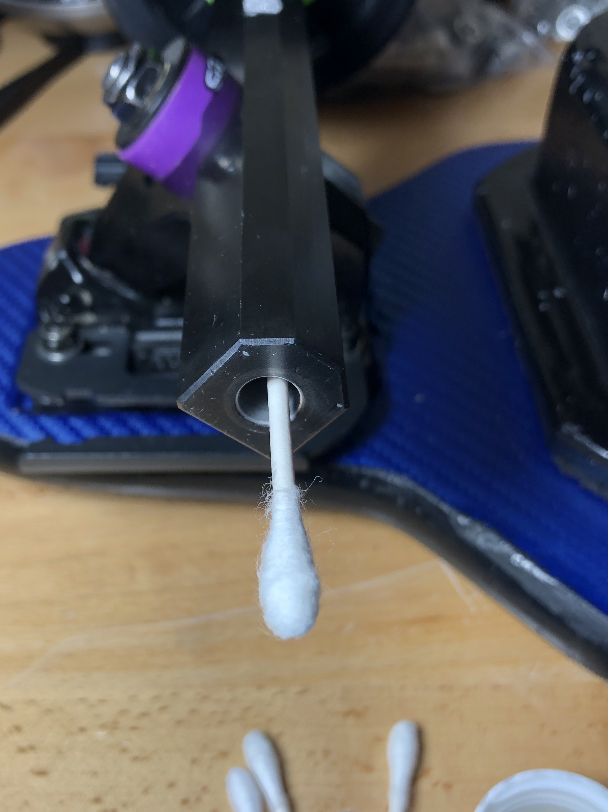

For those of you with BN hangers. Loctite and antiseize do the opposite of each other. Take your time and install cleanly and you won’t have to worry about issues. Small film of anti seize on the inside of the hanger and then bolts.
Clean the inner threads with alcohol and Q tips. Clean the bolt threads with alcohol.
Apply loc tite
Torque. I was hand tightening these to snug before and was coming up way looser than this and had no issues. I torqued to 50 inch pounds or about 4.2 ft lbs, about 5Nm.
Most of what I’ve found suggests around ± 10% 7Nm or 60 in-lb for m6 in aluminum for recommended, not max. But I’m choosing to stay lower. Those values depend on number of factors

Why put the anti seize if you’re going to wipe away with the alcohol? Genuinely curious about this
He cleaned the inner threads with alcohol, not the hole itself. His way is the ideal, but of course I cannot rely on people being this careful, hense the fixed axles
