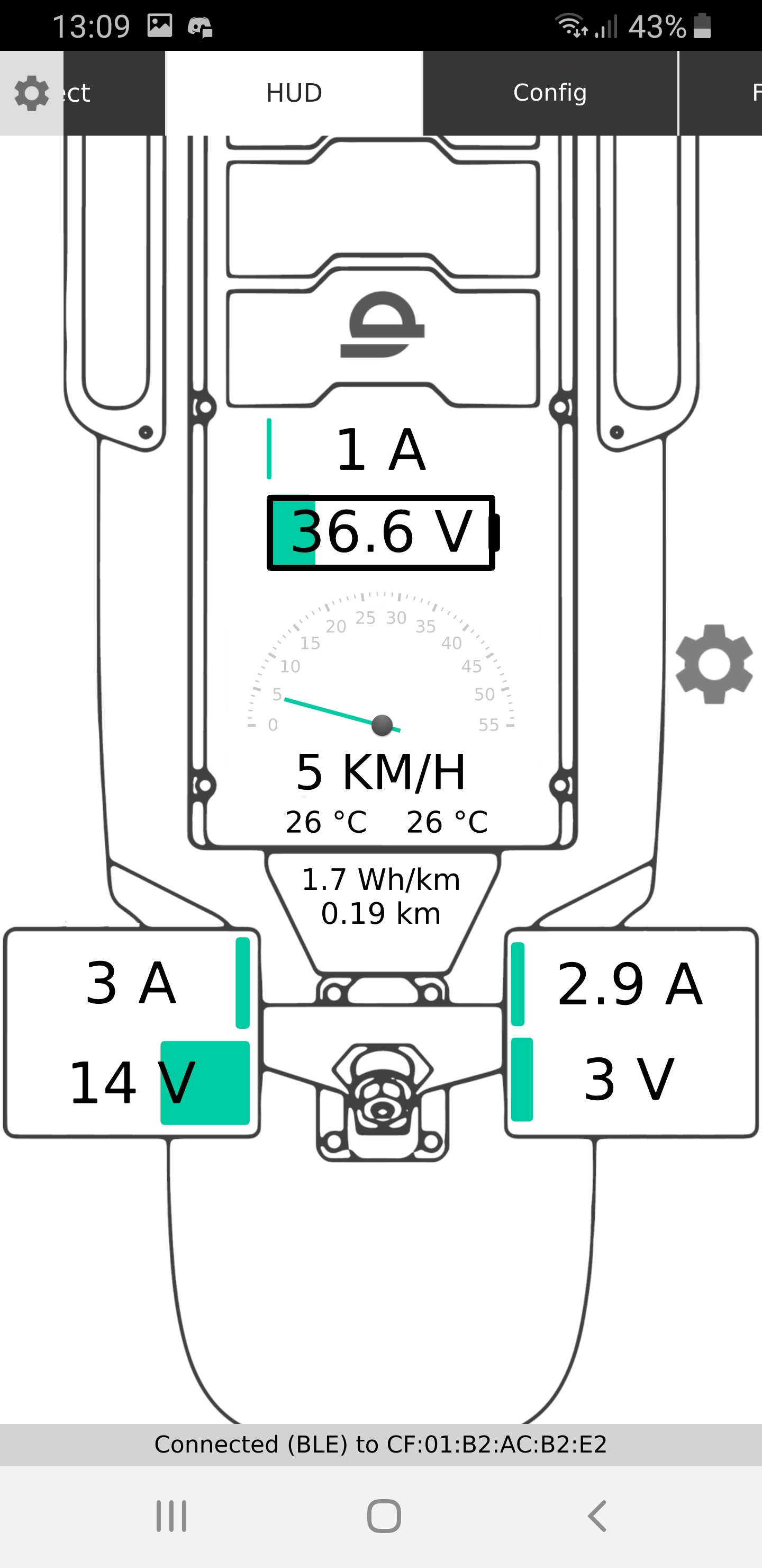

Can motor detection be done with canbus connected to another vesc.? (Dual drive)
I lose vesc settings every time I disconnect motors
currently my board won’t go full throttle and is in the VESC app shows 15% duty and .5 amps.

I’m going to guess it has something to do with losing track of pole position
Yes, you just have to turn on can forwarding.
i would guess its a remote issue.
Which I knew that before pulling it out 15 km from my home :grinning:
I always have to do a redetect if I unplug phase wiring. One of those annoying little foibles you have to put up with. Make sure they are double shrink tubed because losing a connection on the fly is not something you ever want to happen. Ask me how I know…

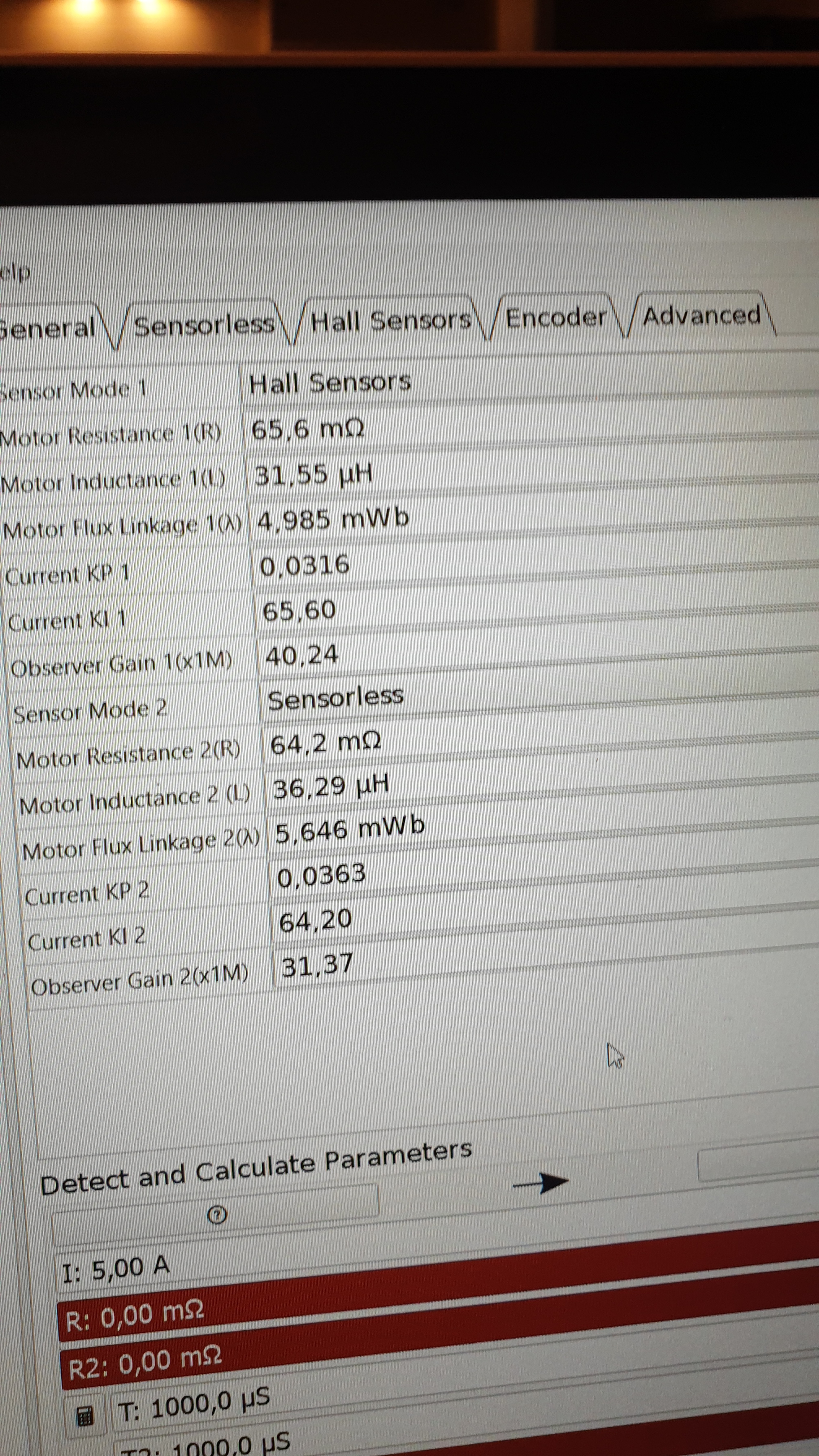

Does anyone know what’s going on here? The motor is not running correctly. There is a huge difference between the motor voltages (bad motor is lower). And it looks like the motor is set as sensorless. When I change it back to sensored it switches automatically back to sensorless. If I switch the motors the issue still happens with motor 2 on the unity, so its not an issue with the sensor or the sensor wires.

If you put the plug the phase wires in the exact same position then no redetect is required.
If you are being sloppy and just plug them in the first hole you find then a redetect is the least of your worries :wink:
