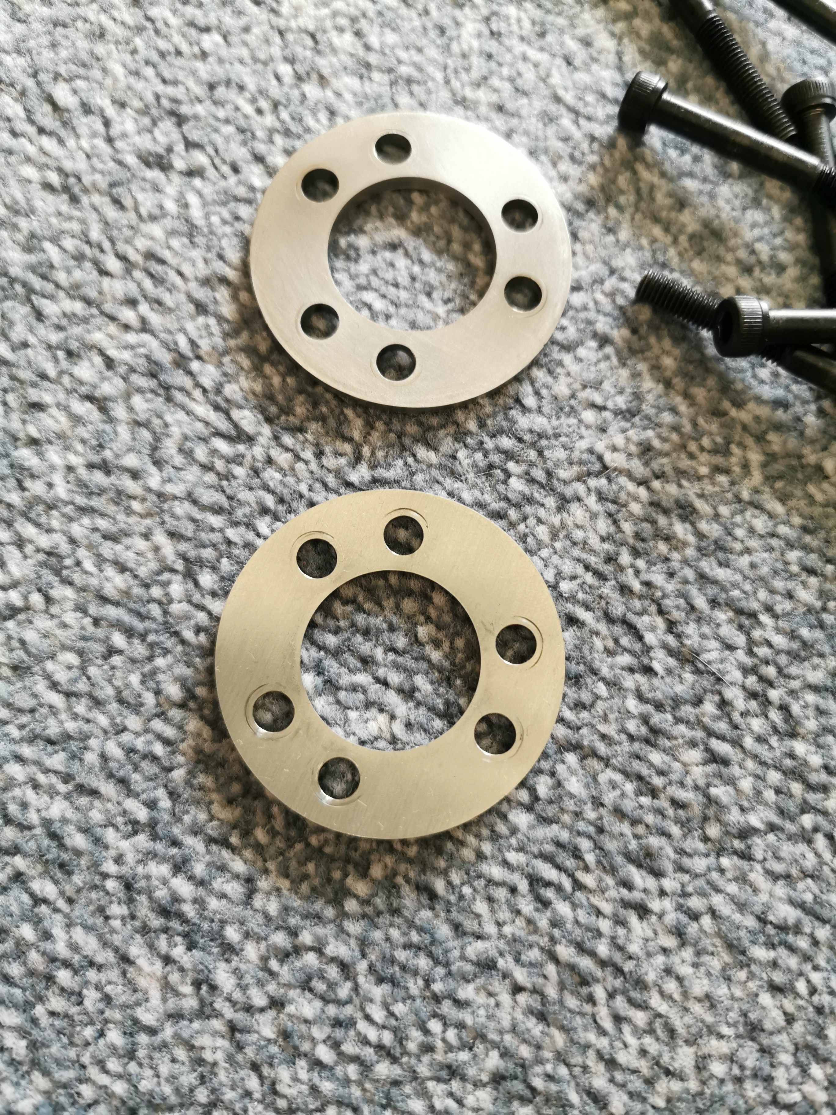

yoooo so i just unscrewed it all and tried the pulley on a different wheel for shits and giggle- and guess what? perfectly flush just like you said
so now i have somehow obtained an offset core. interesting.

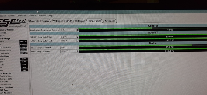

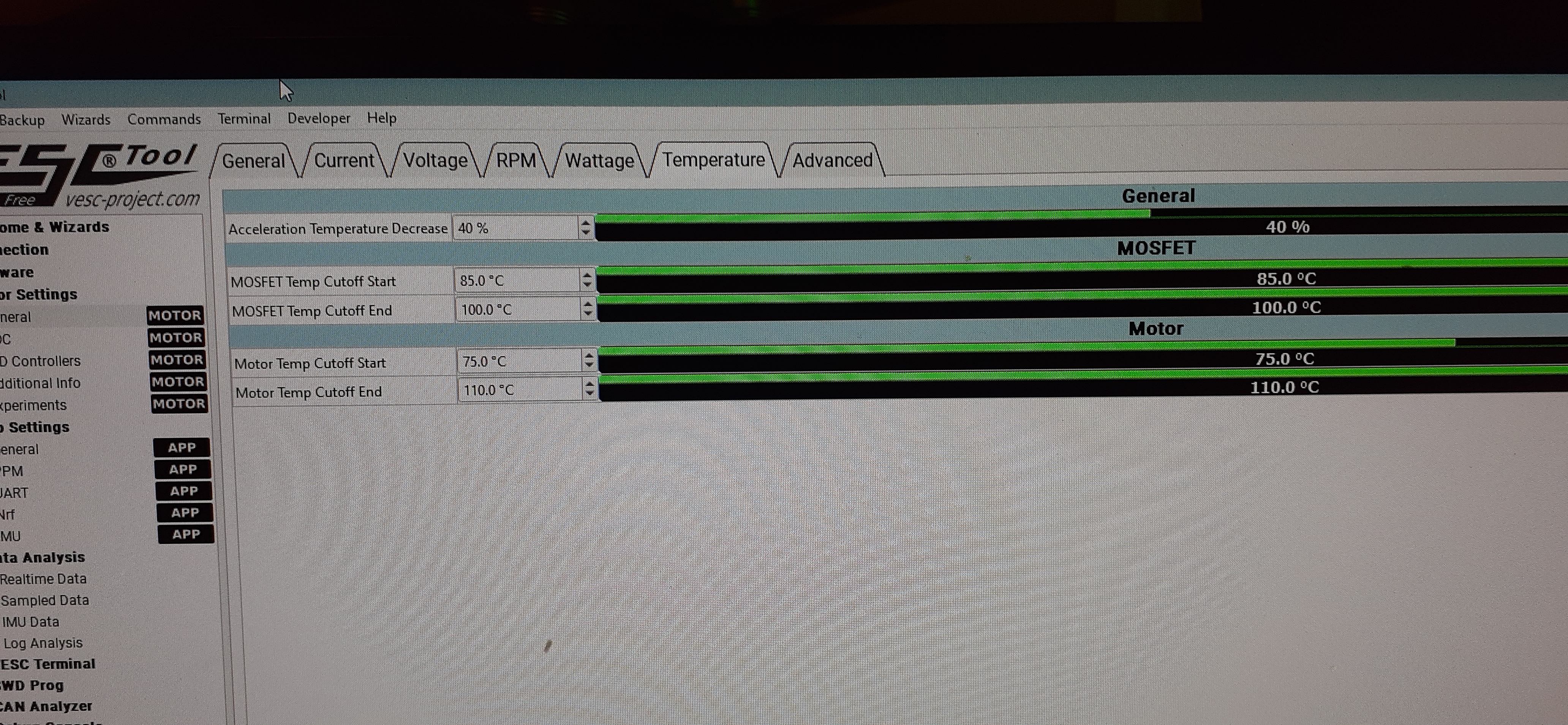

set the acceleration decrease to 40% and start at 70 and stop at 100c , and its still getst to the point where pushing is needed initially
the bored should atleast be able to maintain the power need to go 40 kmh at the leas imo wtf
