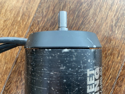

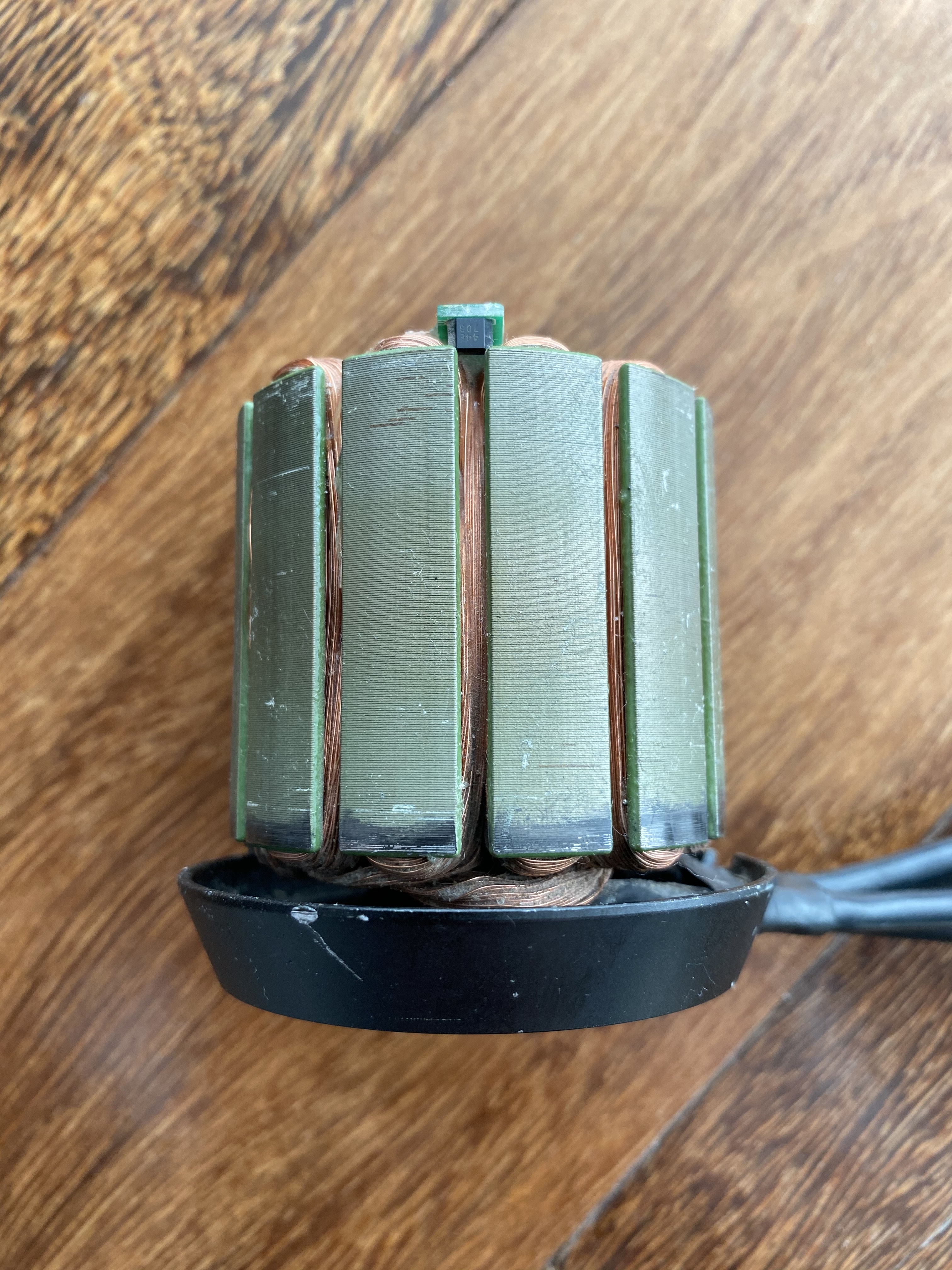

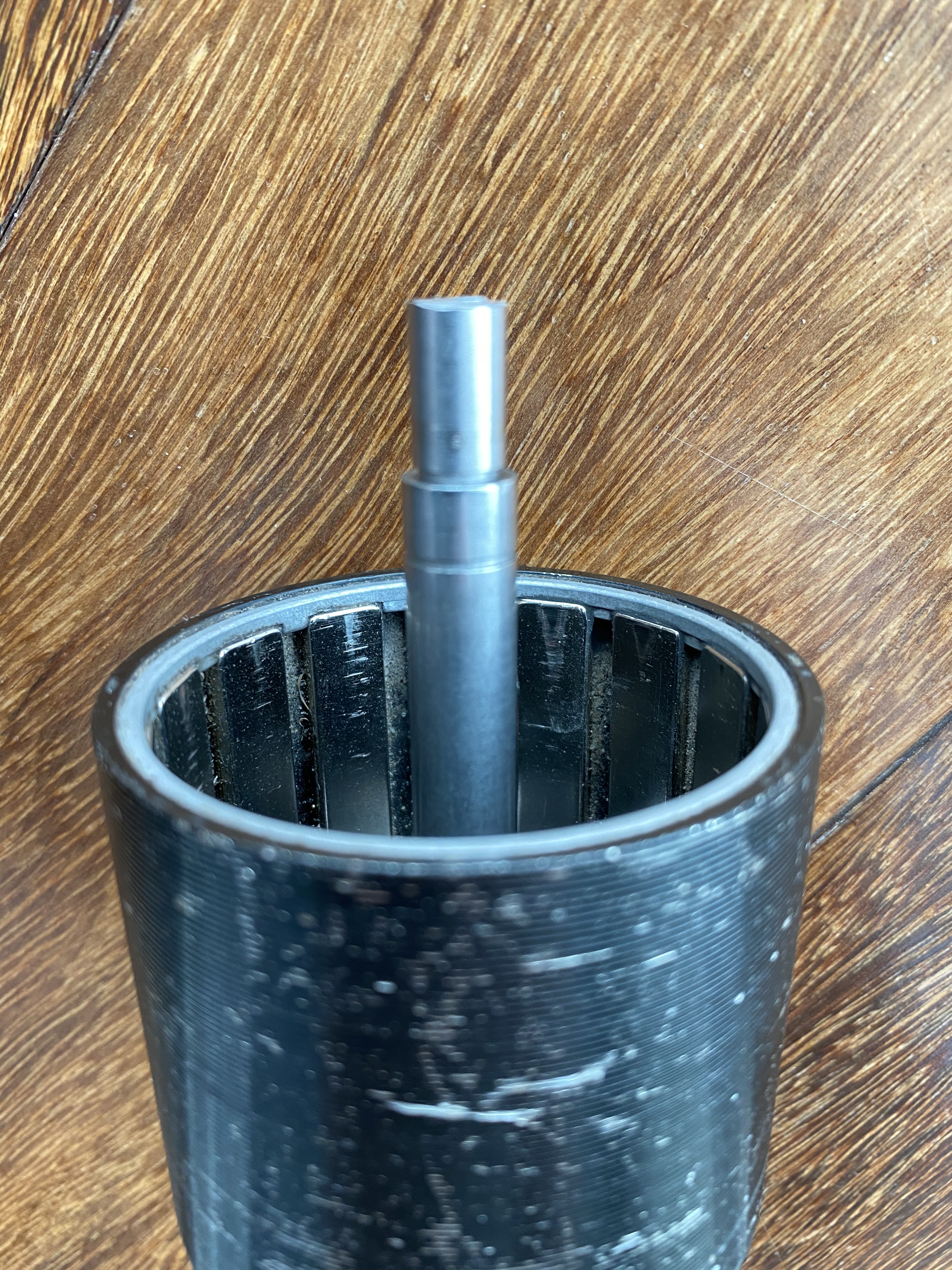

I have one old Street Wing motor which wasn’t running well. It was “blocking” in a small part of the rotation movement, when turning it by hand. Opened it, noticed shaft was loose, so tried to attach it again to the rotor. Put it back together and now it’s even worse, really need to force it when turning it by hand for more than half of the rotation. In the bottom of the stator, there are a few marks which seem to be the rotor magnets rubbing against it, since the magnets also have those marks.
The rotor is indeed a bit angled but I never thought it would have a huge impact. Should I try to mount the shaft again? Any tips?
