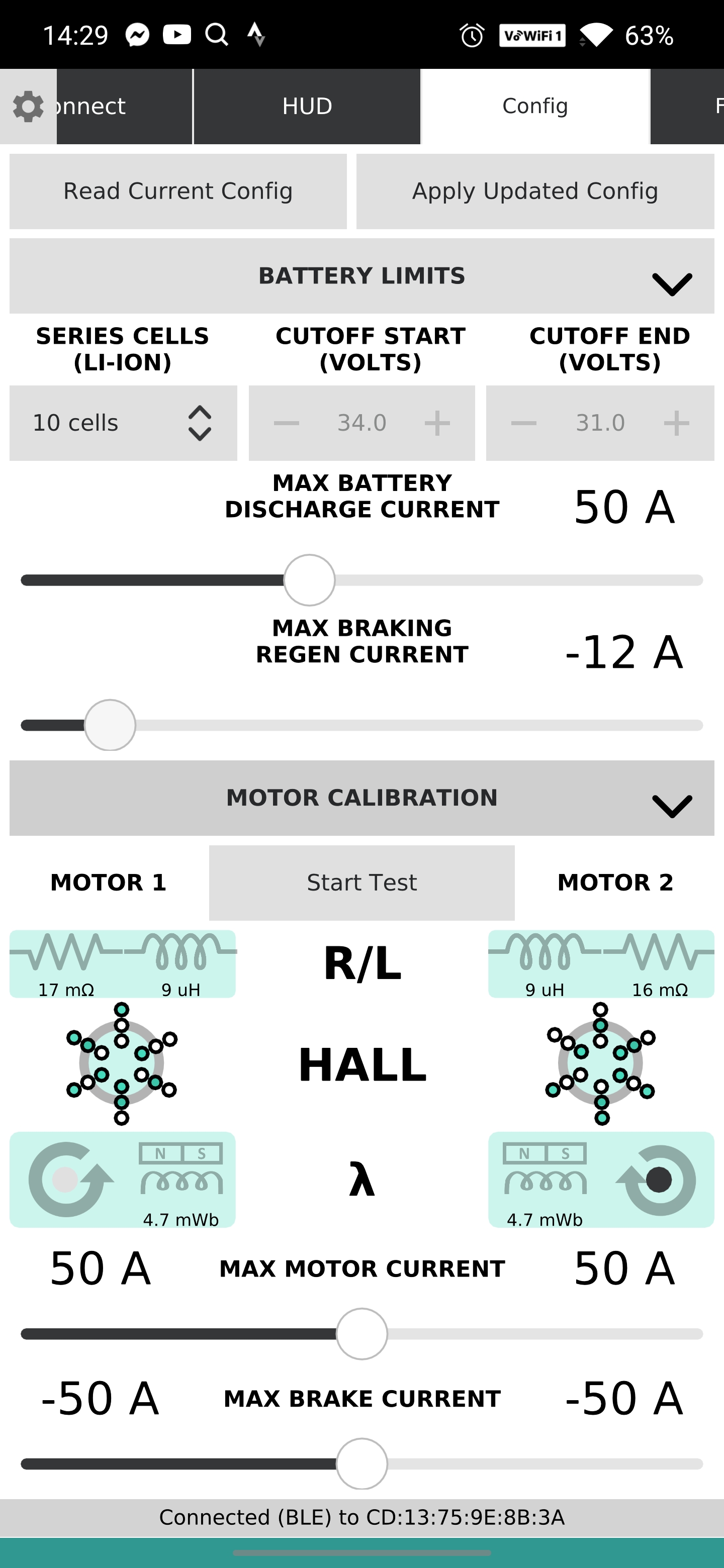

Need help diagnosing this stuttering behavior shown in this video:

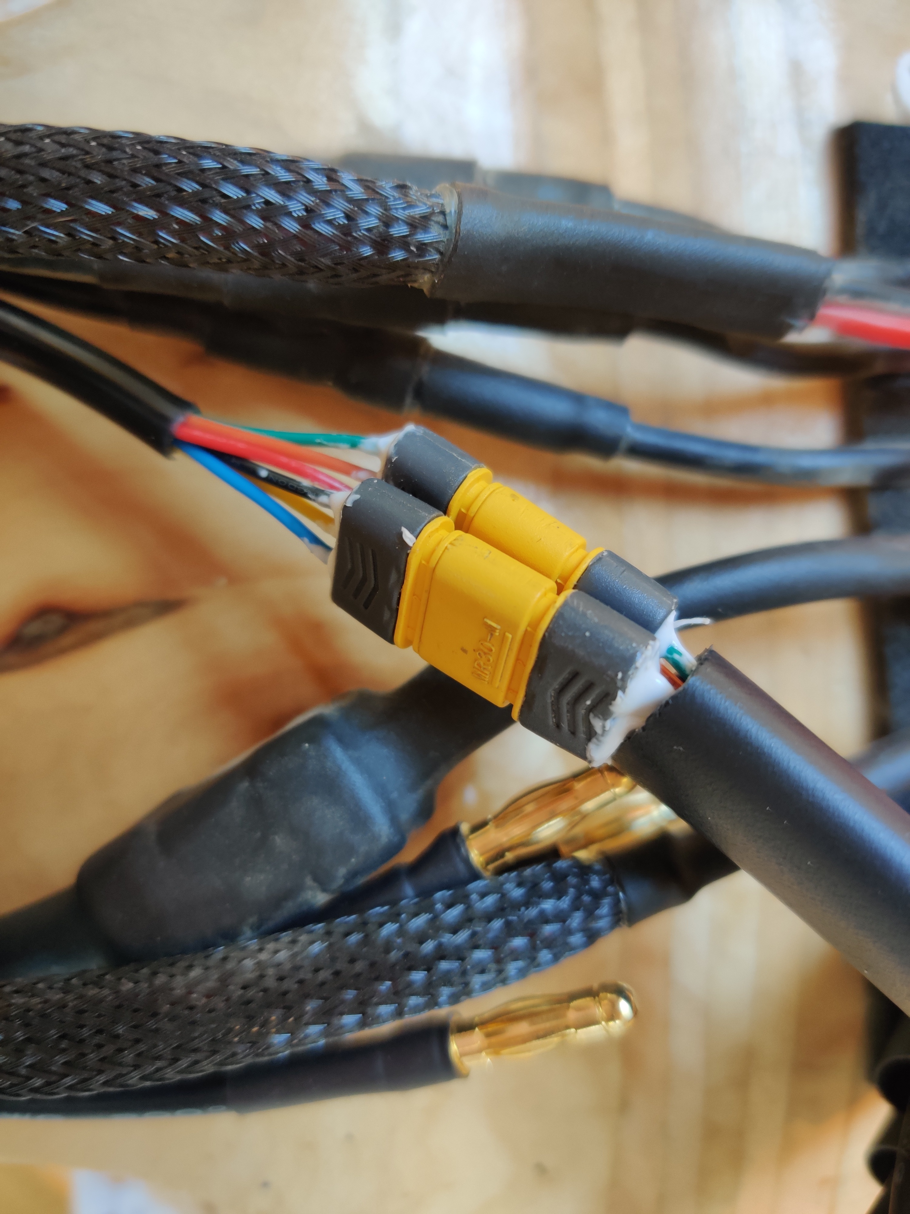

I started with single drive and that side is working fine. I just added a second motor and that is where the stuttering at low speed happens. Before installing the second motor I noticed it had a little more resistance when spinning it in hand. 3kmh and faster runs fine. I soldered MR30 on the sensor cables, will open this up and check the connections:
However when redoing the guided Unity set up it reads the sensors fine as far as I can tell:
Any ideas?
Specs
10S4P 40T, charge only BMS, Unity 23:46, Flipsky VX1 PPM on highest setting, maytech sealed sensored 6374 170kv, 62T 15T, idler mounts with pretty close kinda loose belt tension on both sides.

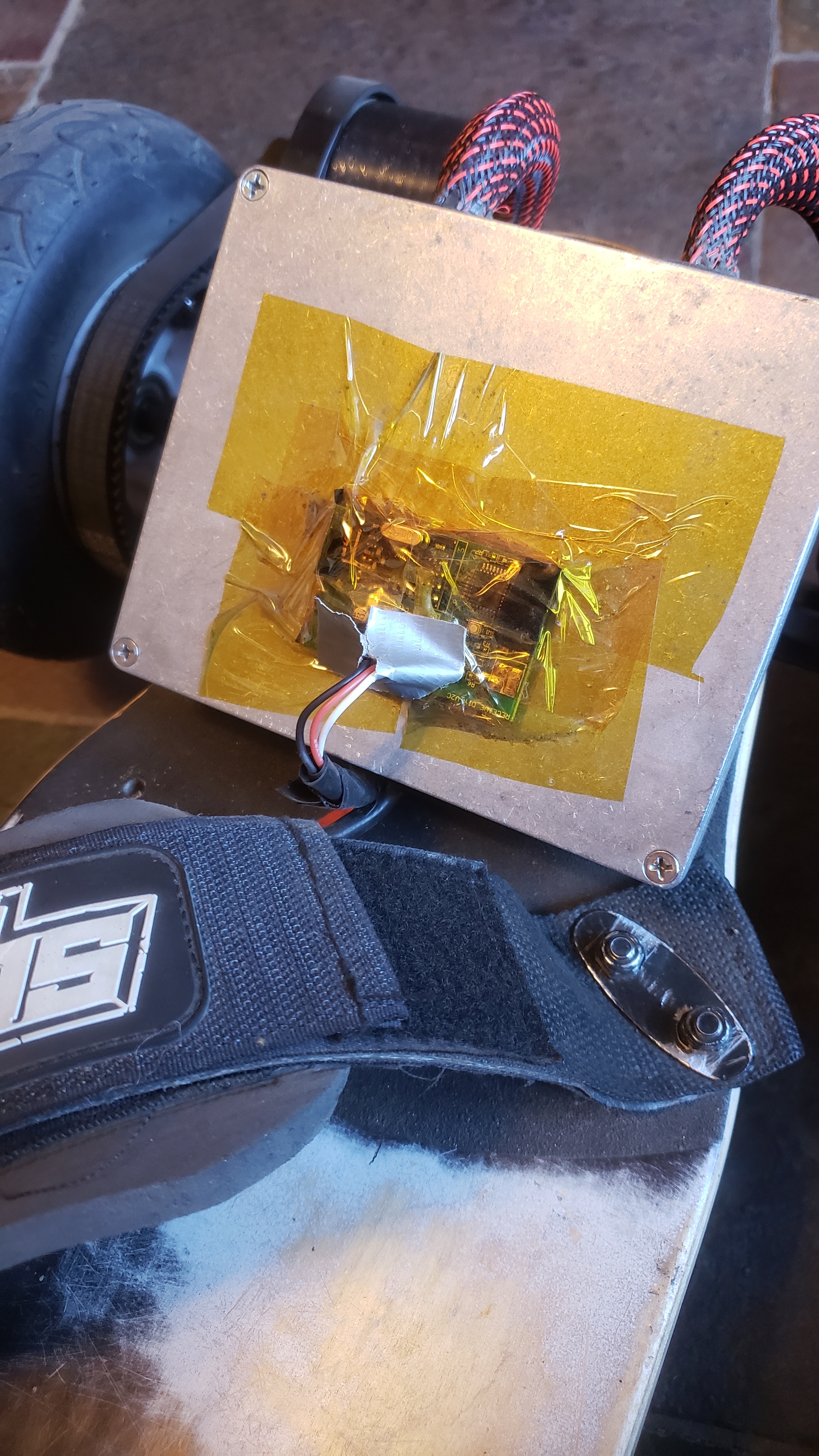

Has anyone figured out how to add an antenna to the benchwheel reciver? It wont get a signal when it is inside the enclosure so I currently have it taped on top.

Those values look normal. Swap your motor cables and sensors side to side on the unity and see if the issue follows the motor or stays on the same side.
