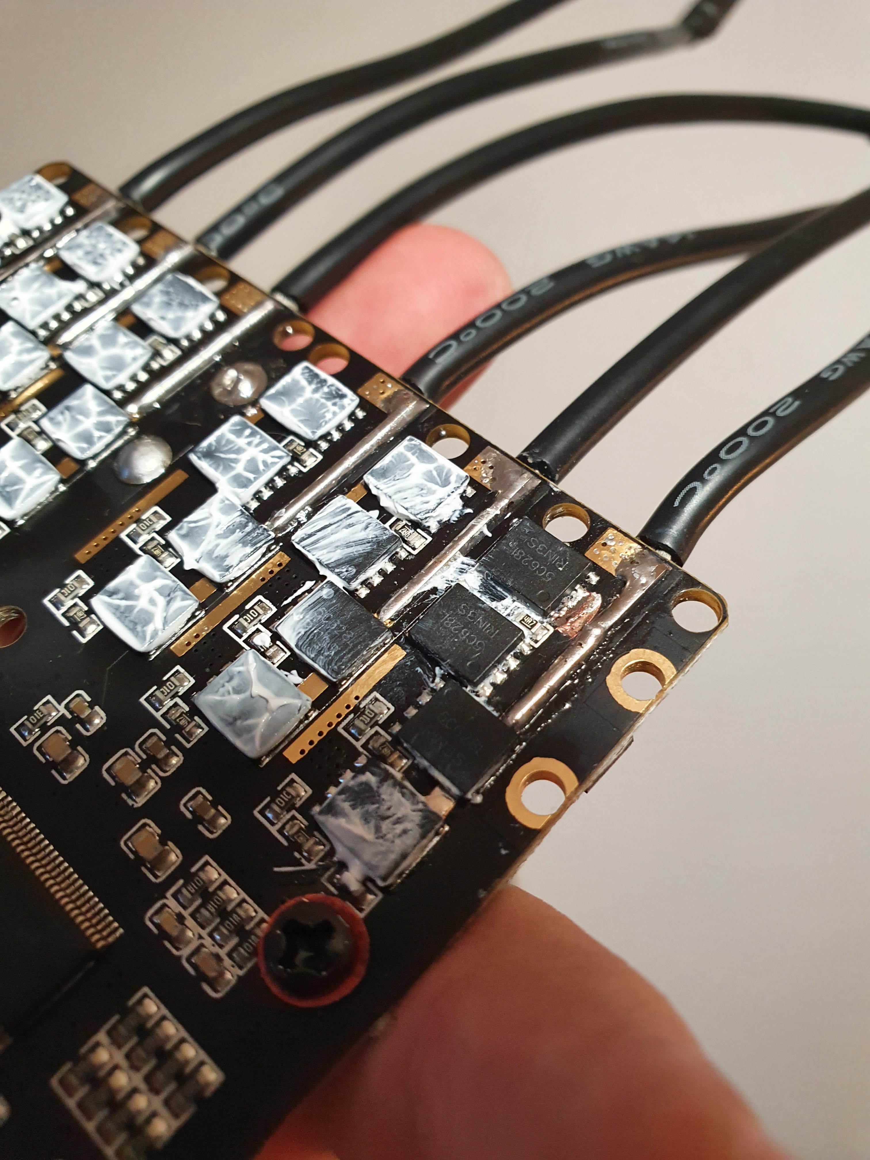

Same pictures again. You see what i see. And what voltage can possibly spike at 0rpm on a test bench?
I think sparking can produce a voltage at 0 rpm :wink:
Yeah I see a blown mosfet although not sure what could have caused it though. That’s a bummer though. Luckily my makerX still looks fine
Did you ever figure out what went wrong?
Still no idea. The whole line of mosfets is blown and i think the drv with it. I got 2 trampa vescs now to mount

For the maker-x esc, the design is somewhat smart. Mosfets and most ā€œload bearingā€ components are on the bottom pcb that screws on the heatsink, and small smd components and stm chips (the expensive part) are on the top pcb along with connector ports. The seller has sent me the bottom pcb part at shipping cost to me in hopes that the drv is not bust. We’ll see how it plays out. For now i have a fried antispark and an unusable dual esc. For the price i’m not even too mad. I knew it was a gamble :frowning:
