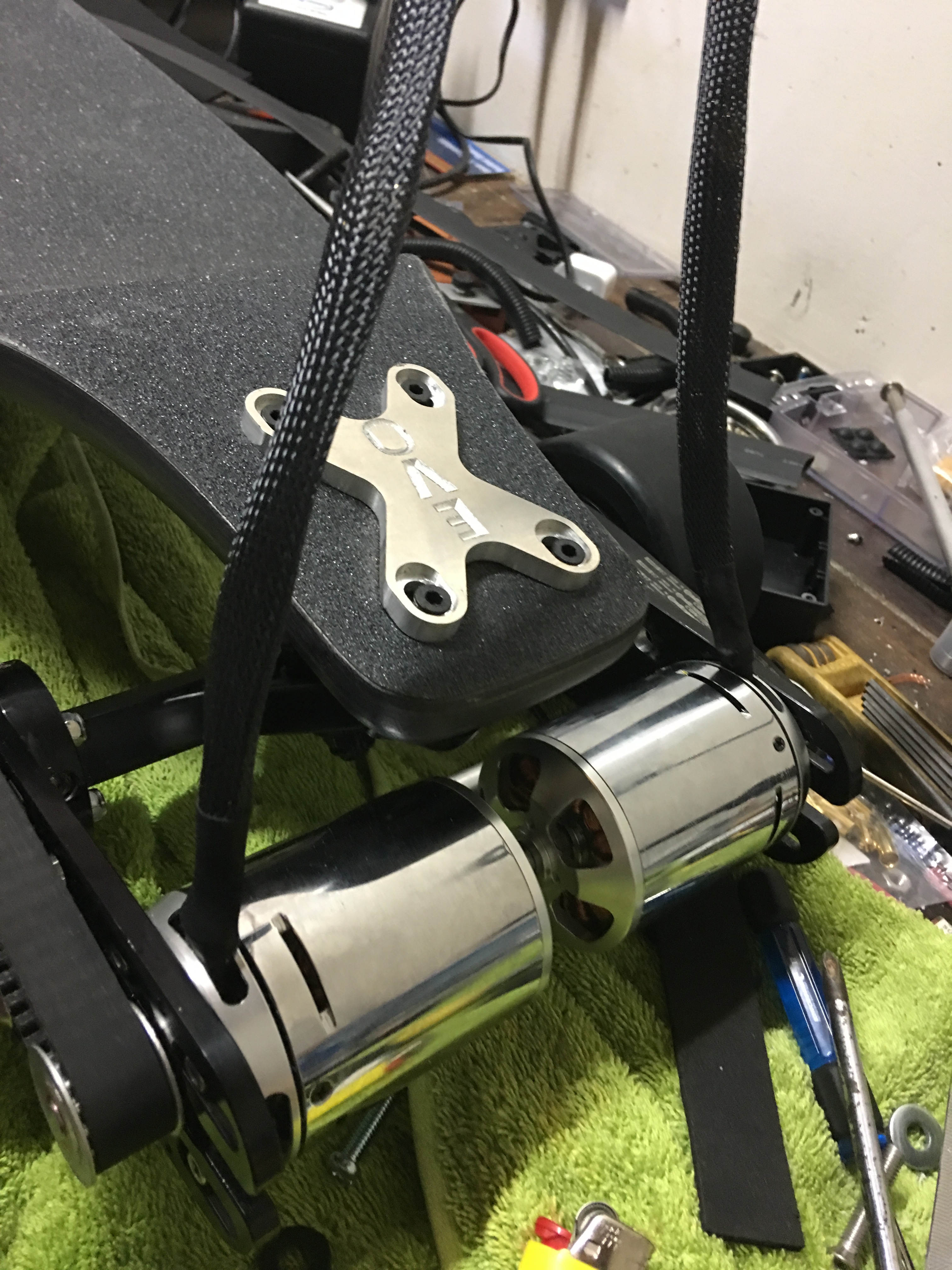

Not sure what that would do. I soldered silicone wires to the phases so I could have the stress off into the inside of my case. You’d probably have to tie a string or something to the phase wire to pull it through without disconnecting the bullets. Or put locking connectors…
I was more worried about the flex of the tubing eventually disconnecting a bullet. I have only re soldered phases once because it was such a massive pain in the arse. Sanding off the coating on all the strands.
I’d imagine only irl testing could answer that. Since its @Zach idea, I vote for him to try it XD
Yes, me too :+1:
How did you prevent the sheathing from unwinding? My sheathing always frays and unwinds. Did you burn the ends together?
I burn the ends to keep them from unraveling while working with it, and then use a zip tie right at the end to keep it all tidy.
2 layers of shrink tubing or 1 of the heavy duty stuff keeps it all tidy
Waterproof heat shrink is what I had in mind (maybe healthy doses of liquid electrical tape
Would there be more flex than there would be with the wires just exposed? I would think there would be less was given the added rigidity of the pipes
If they are rigid then fine. The ones I used were very flexible so wanted to be straight like a spring. That spring effect was something I worried about when connecting to the motors without a gland. If you can actually shape the tubing you are using then there won’t be a problem
What all these guys said. I used a lighter on the edges to stop fray and then used some massive heavy duty heat shrink.
