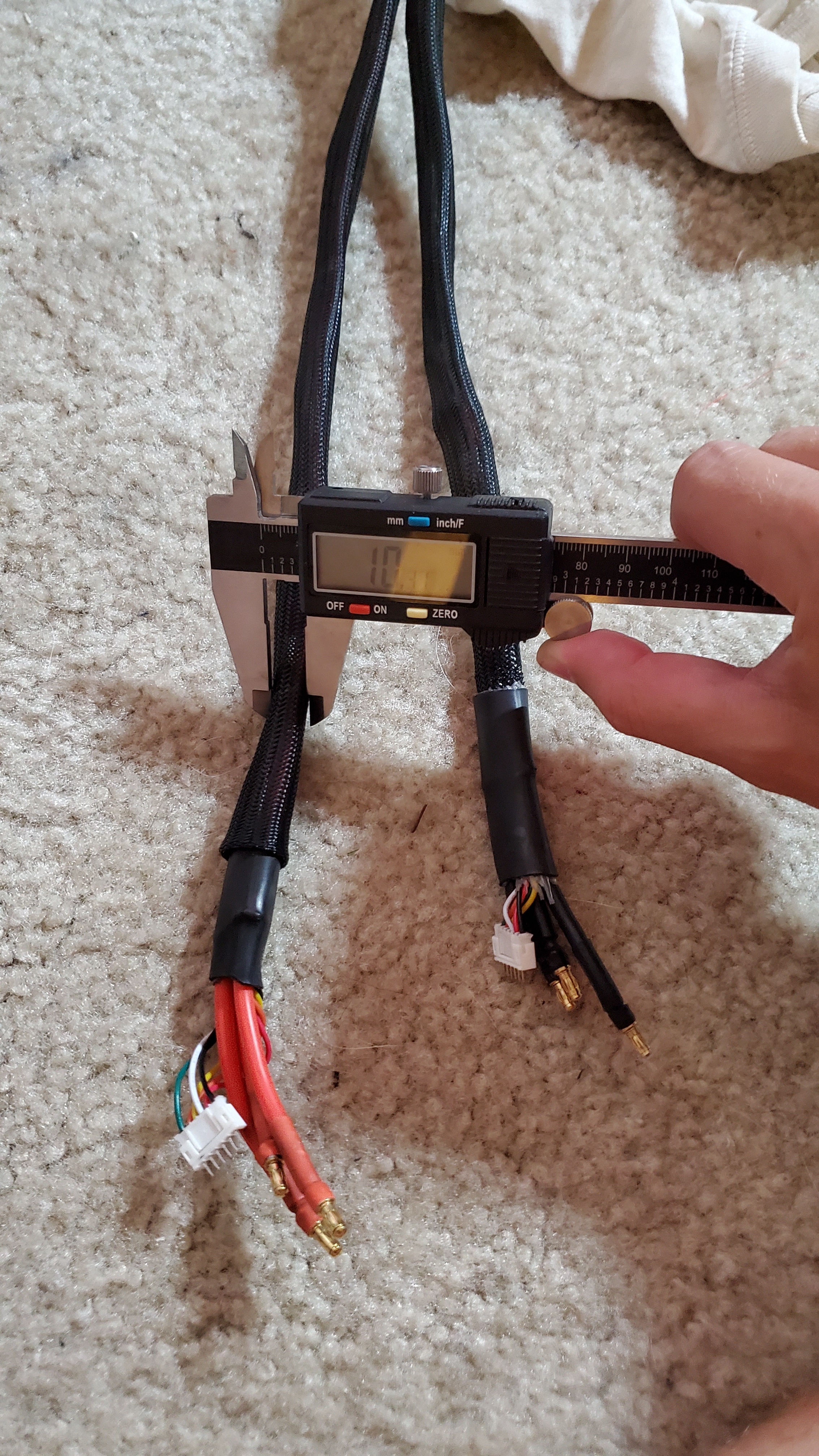

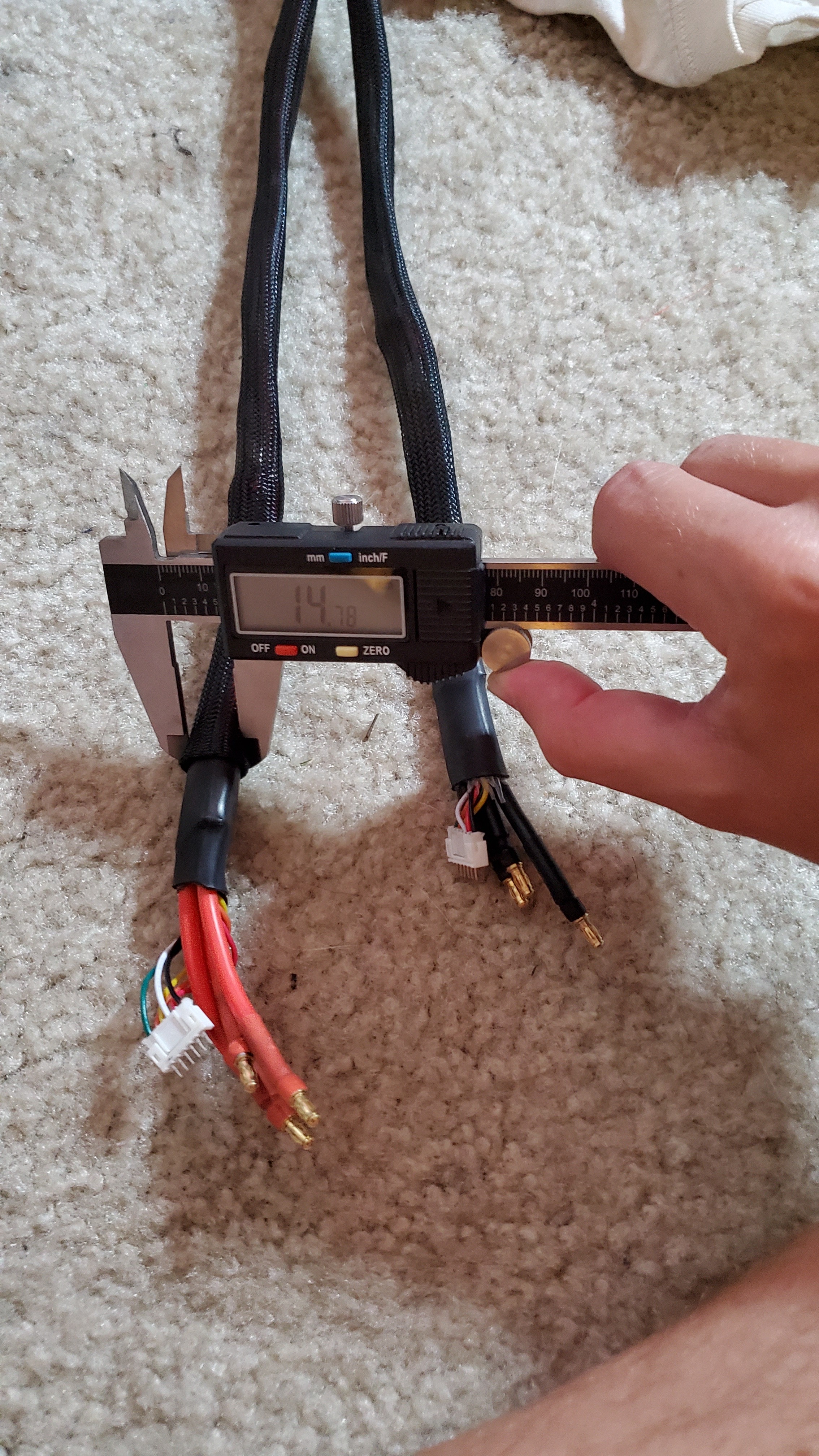

Around what circumference are the 3 phase wires and the sensor wire that comes from the motor?
All together, or each one?
All together, for sheathing purposes
You can probably fit them in a 1cm diameter circle if they are 12AWG

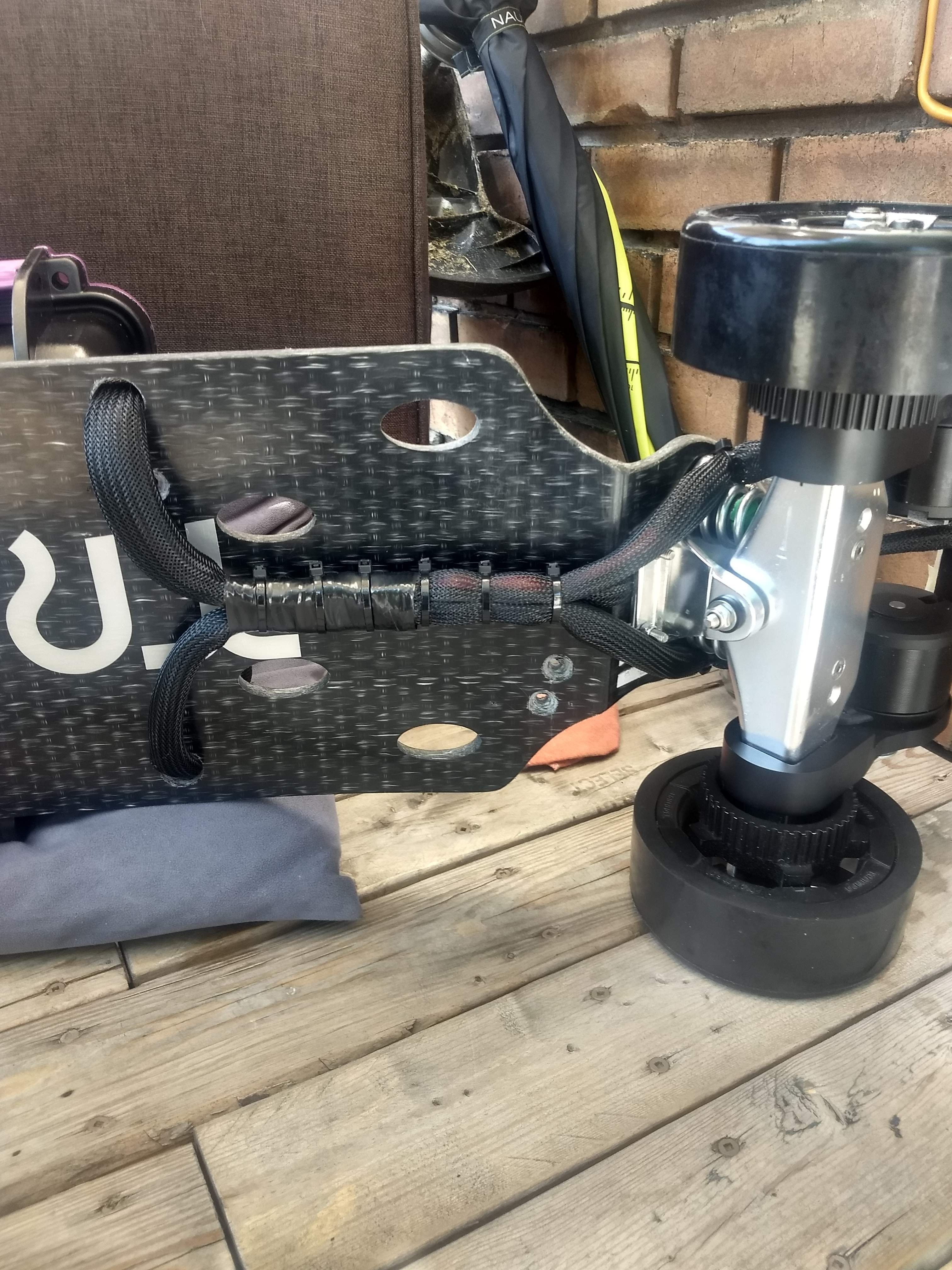

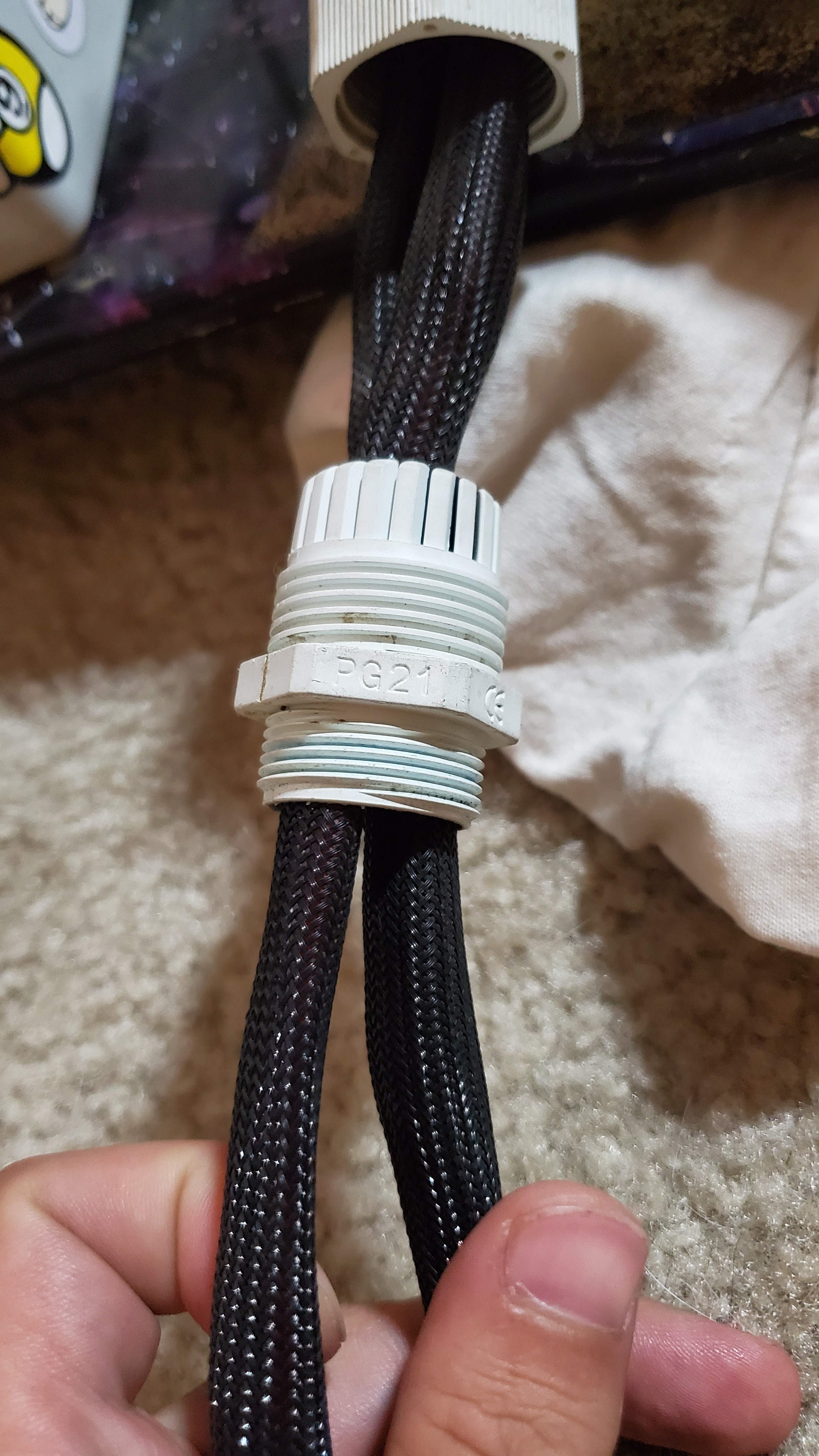

1/2" cable braid worked perfectly for me. Don’t mind that it’s alextech haha not sure if you’re familiar with that scheme. The waterproof cable junction is a pg21 gland just FYI and BARELY fit them both.

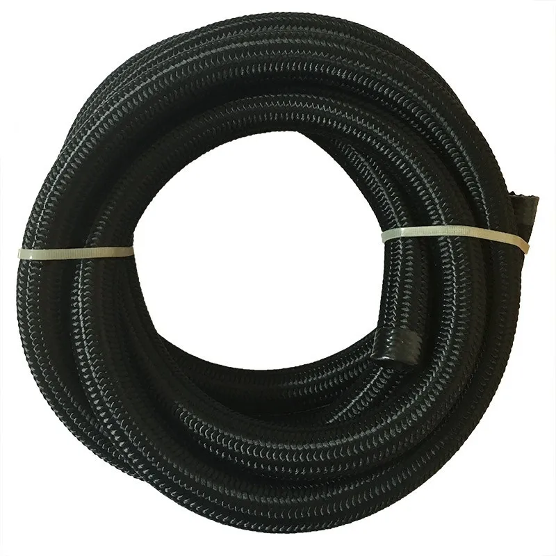

I appreciate the concise measurements. And ofcourse, how could anyone forget the alextech situation. The reason i was asking is because i was looking at AN-8 hose-ing for the wires. Way overkill, but proper waterproof with a gland and would provide strain relief + protection on the wires in the case they were snagged

This kinda hose is normally used in the automotive industry for high pressure fuel, oil, etc

I love that idea but how would you do the connection to the motor?
Are you asking how to route wires through hose? You really are getting old :kissing_heart:
How to make it pretty is all. Glanding the enclosure works. I do that but the motor connection with a very stiff rubber and stainless hose will be problematic. Just wondered what ideas the young fella had that I might not have thought of. Some sort of right angled bracket between the motor and plate so you could attach a gland etc…
ps I’m not getting old son. Its already happened. :joy:
Those hoses still have some flex to em to bend . When I used them on a car I heated them up with a torch and bent them how I needed
I tried to use some plumbing flexi connectors on a build and the motors were a problem. All the flex transferred to the connection and put pressure on the wiring which would over time then put pressure on the bullet connectors within. Wasn’t comfy with it so shelved the idea. Still like the idea though so just shooting shit out to see if a genius has some solution. Like the heat idea though.
