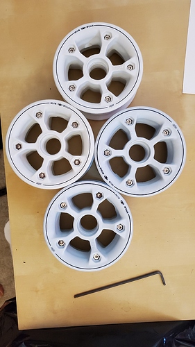

Is it just me or are these white hubs 2 different colors?
:thinking:
Right-Bottom are more grayish/icy
Left-Up are white
Adelson’s Checker-Shadow Illusion ???

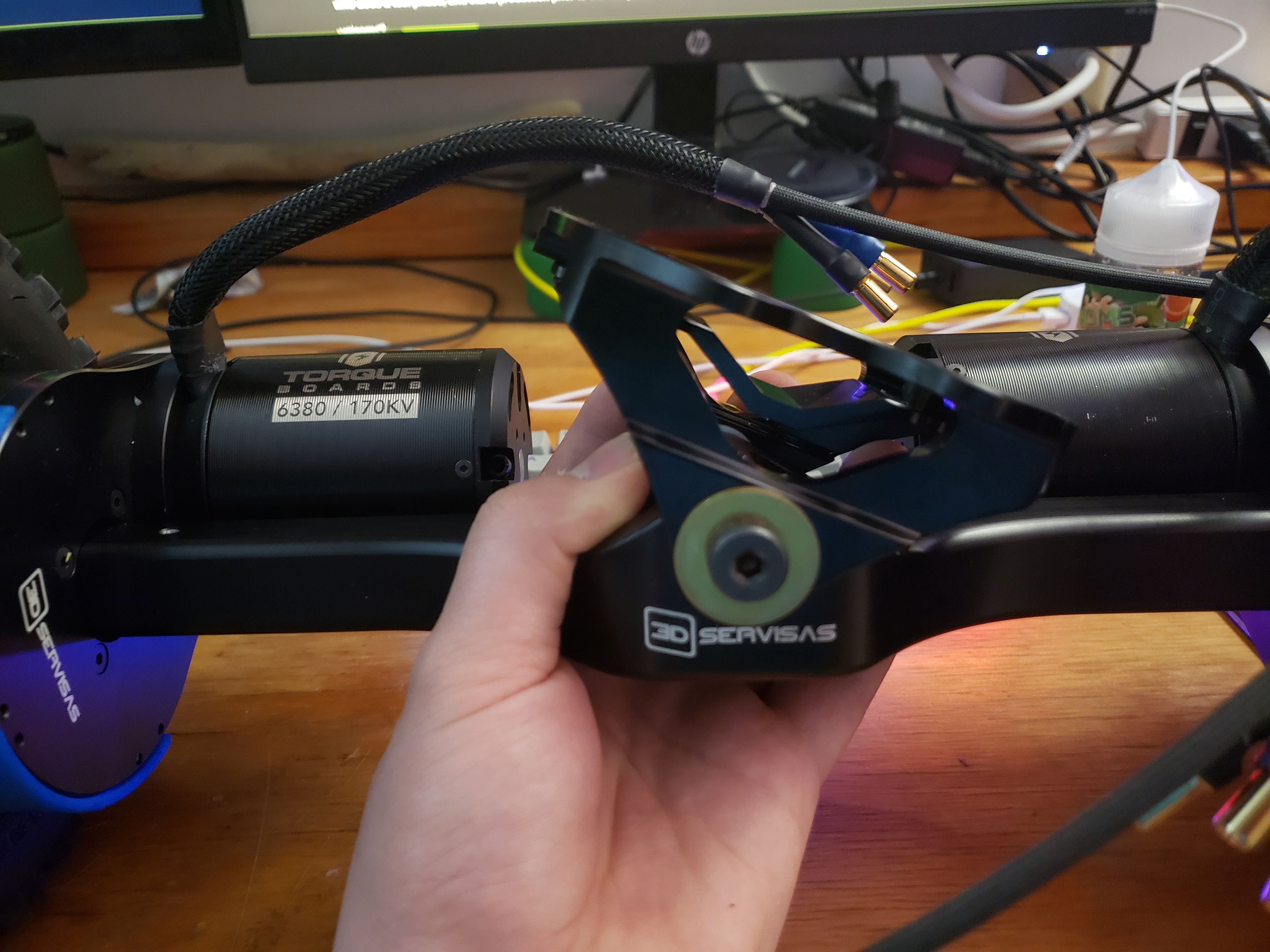

Should I suck it up and adjust my gear drive angles?
At 26° of lean my matrix 2 baseplates contact the motors.
Do you guys ever see matrix 2 trucks leaning past 25°? This is just far enough to not touch…
@MBS
That’s close to max imo
Depends how you like to ride - fast (stiff trucks) or carvy (loose trucks). I’d test as is. Keep the back truck stiff with harder shockblocks (or soft just cranked down a bit). Then loosen the front truck like crazy if you want more turnability. That’s the best set-up if you want to balance stability (speed) with carvability in my opinion (even if there wasn’t a conflict).
Thanks, having never ridden these the suggestion helps me feel better about probably not destroying my motors first go now… I’ll be trying out initially with the rear de-wedged a bit with red shock blocks and a bit tightened down, with yellows on the front… Stability at speed with carvability is just what I’m going for. If the red shock blocks will provide enough resistance to never reach greater than this lean angle than I am confident in how it’s set up now.
The reds cranked down will DEFINITELY prevent that much turn. You’ll barely be able to turn them at all. So I’d say you’re safe in that regard. You’ll probably need to loosen things up eventually. But it sounds like you’re starting from a good spot. Speed wobbles almost entirely come from the back in my experience.

Perfect! This is exactly what I was hoping to hear, I appreciate your help man!
PS, good YT vids too, they have been very helpful getting familiar with all this stuff.
