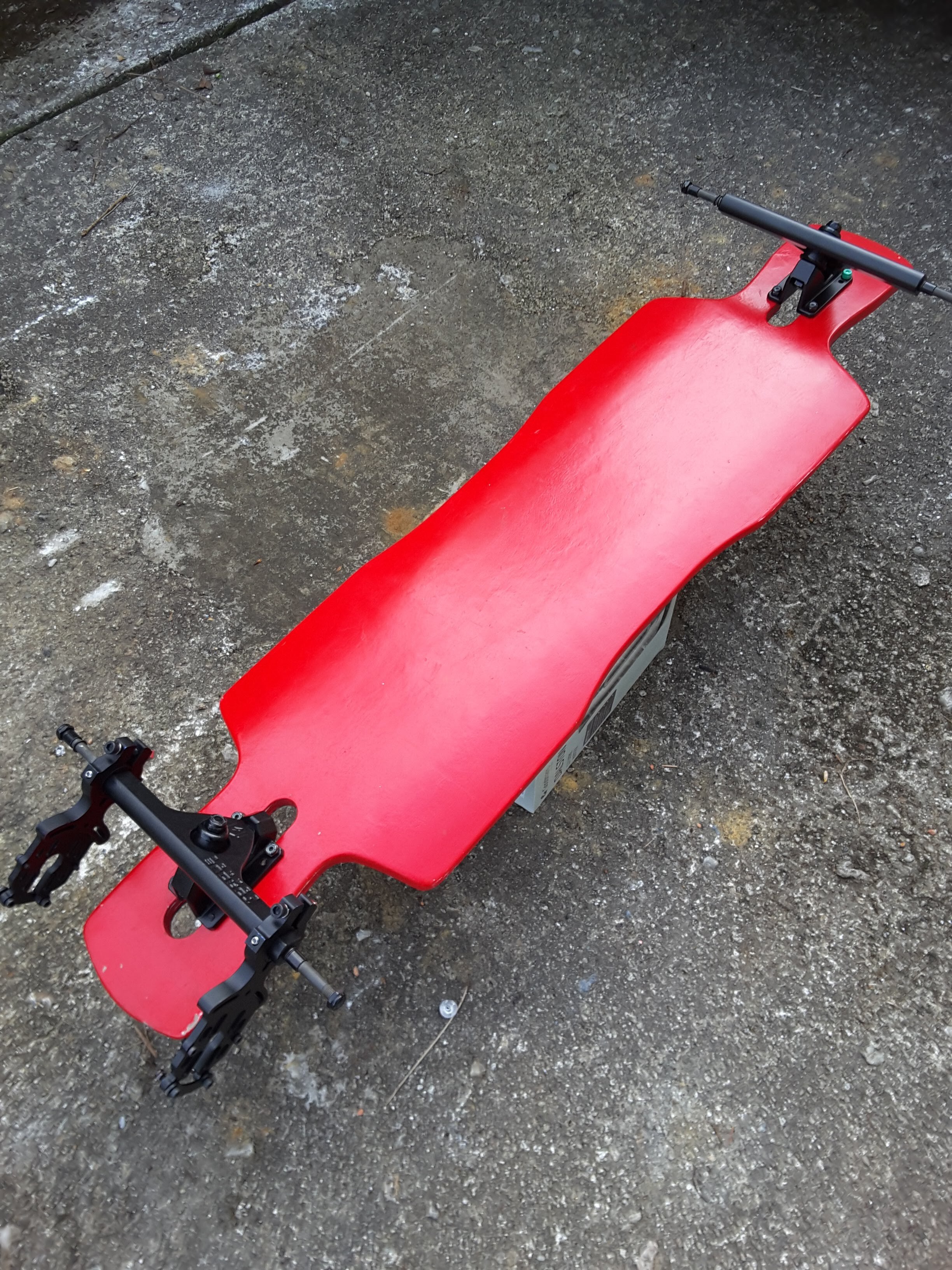

can someone please tell me if i have mounted my trucks correctly

The ones with the mounts are backwards :joy:

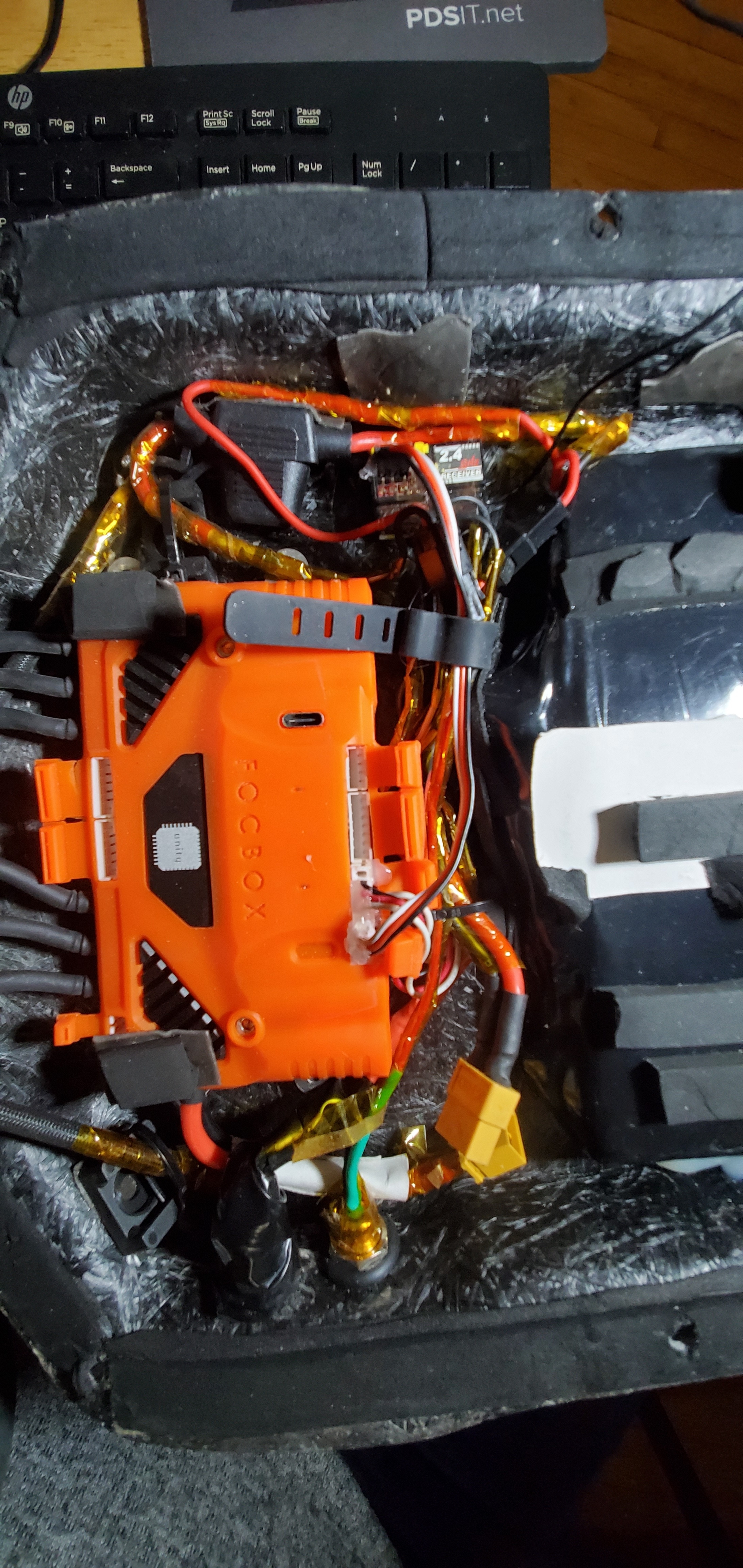

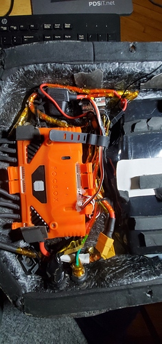

Is this a good location for the the receiver. Trouble shooting micro braking/cutouts. I tried everything. The only thing thats not new is the receiver.
I’m not an expert on placing receivers in skateboards but I know antennas. Minimize the metallics, including graphite fiber laminates, between the receiver and the remote. Keep the receiver as far away from strong flowing currents as possible. I know. That doesn’t leave a lot of good options in a skateboard.
