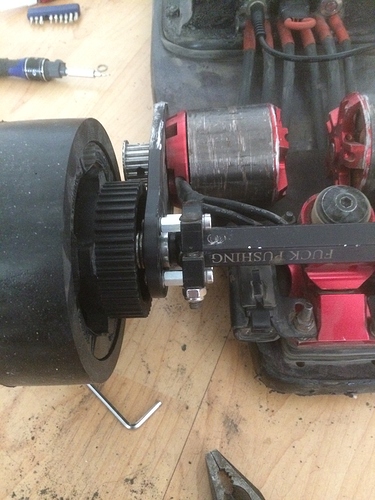

what do you guys think, is it ok to use these 5mm standoffs on boardnamics mounts ? the alternative is to use them on the hubs themselves, but i would assume its more efficient to line up the pulleys with the mounts?
i am considering this because it seems the wheel pulleys allready stand off quite enough to cover distance for either gummies or the evolve tires not to rub on belts
sorry to tag for this trivial matter, but what do you think @Boardnamics?
I’m really confused by your setup here. Can you give us a picture of the wheel/pulley setup without the mount in the way?
on the last picture you see the distance i have to cover to align belts, i approached it with moving the mount further out on the hangar, and then adding those standoffs because it still couldnt align
what you see is the untreated side btw
I guess those standoffs could work? I think you’ll lose some rigidity from them, but not sure how much.
I’m still confused as to exactly why you’ve got your wheels spaced so far out from the hanger.
tbh its just to not have the board look completely stupid, avoid wheelbite and get some more stability at speed :see_no_evil:
the pics make it look more drastic than it really is too i think
edit: well maybe not :joy:
Honestly if it were me and I wanted a wider stance, I’d just get some wider trucks and do away with all the spacers and the issues caused by them.
I’d either run the rear end a bit narrower, or fukk with the front truck spacing, before I’d use those silly spacers
i will see how it works out with the standoffs for now, i know its not ideal and probably will change depending how it goes…
regarding the spacers on the shoulderbolts, these are just for proof of concept and will be replaced with these once i know the final dimensions
@MysticalDork
i just found out that trampa uses up to 17mm standoffs for their hubs, since im staying below that i will most likely end up not fucking around with my mounts needlessly and just space the pulleys out
seems like the more sensible approach afterall
