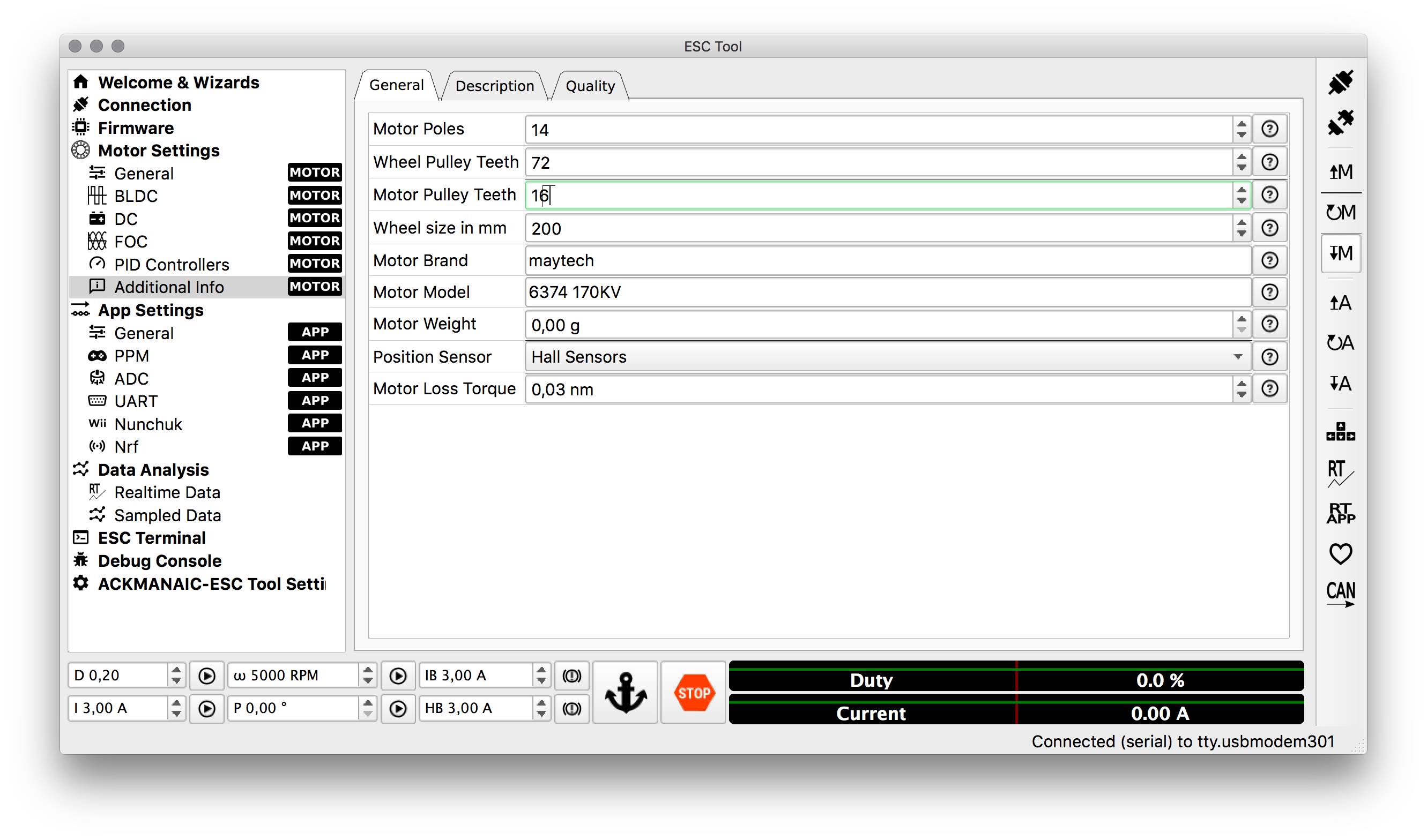

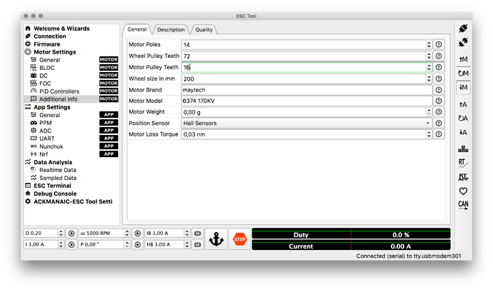

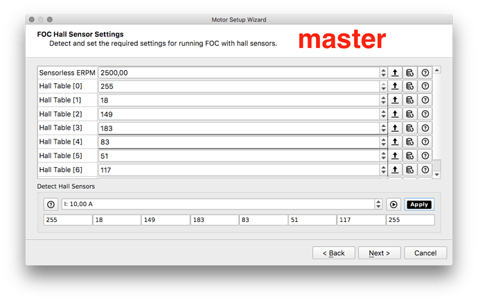

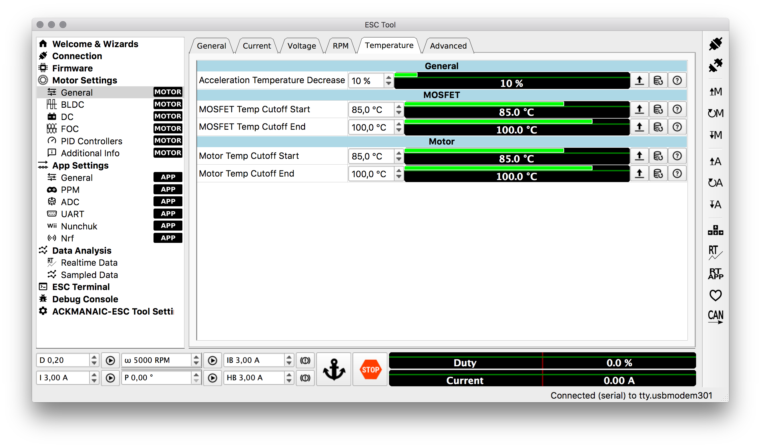

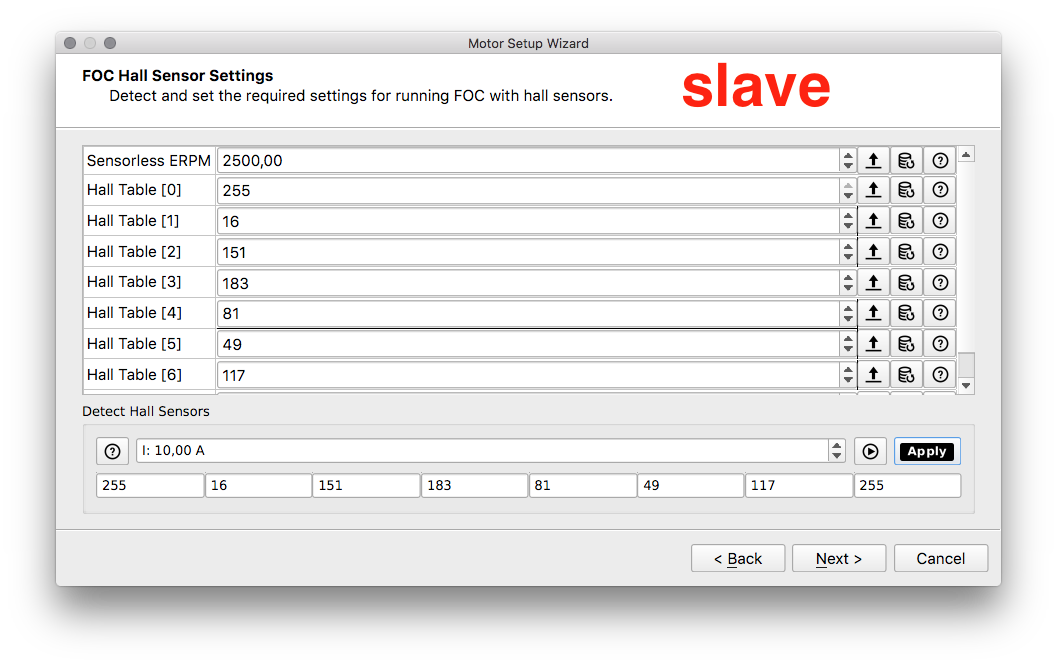

Hey guys, Im on my first build as some of you may have noticed :wink: I have everything running, but want to walk through my settings and optimize things, so I won’t blow things.
Some pictures to tackle any “NOOP mistakes”

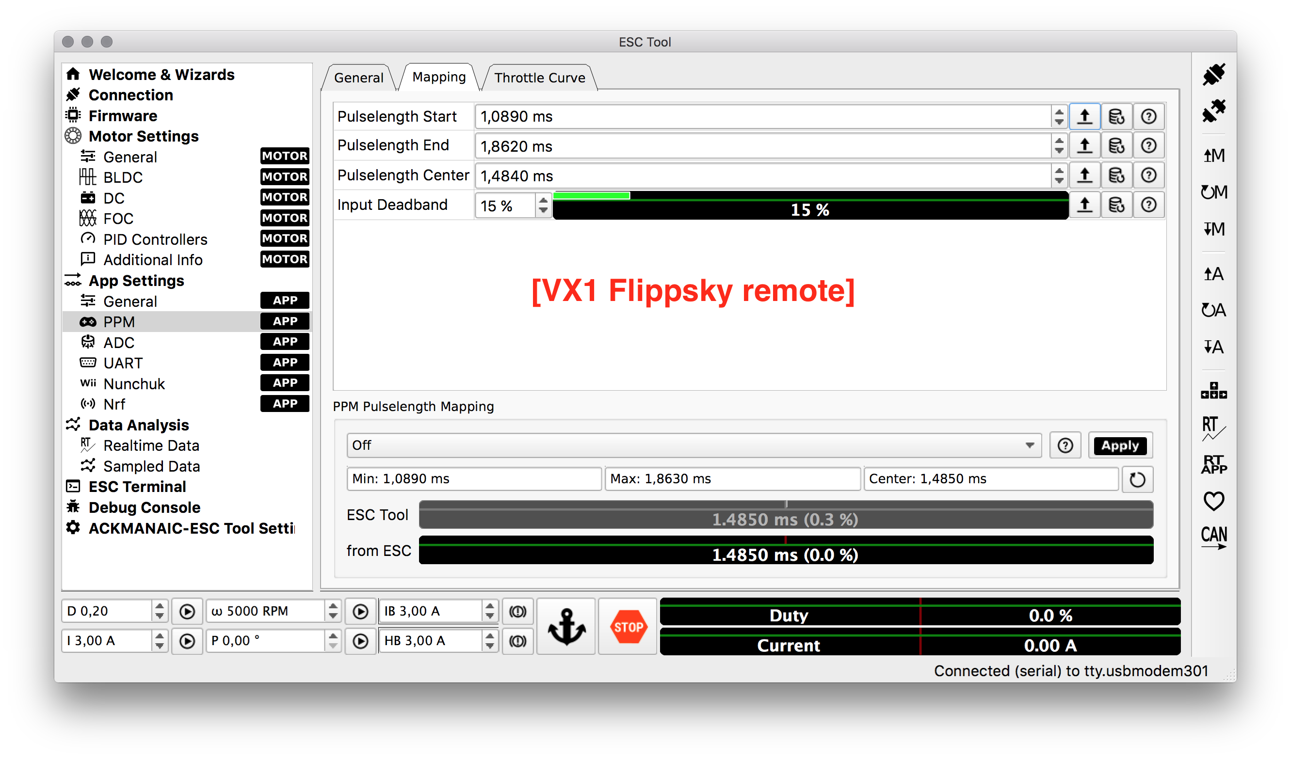

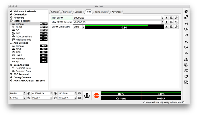

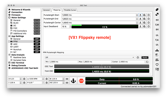

  • My first concern is: It looks like my throttle gives not many steps between full speed and not moving.

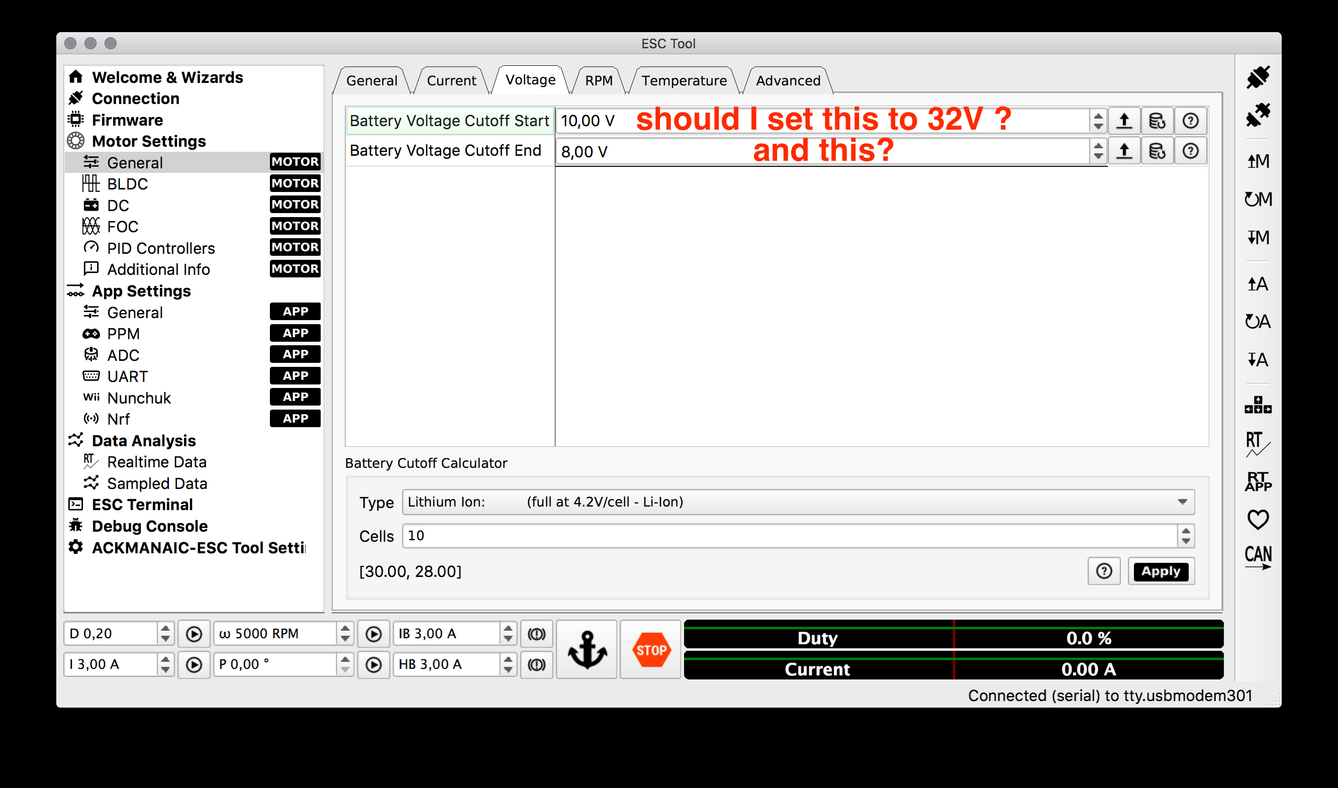

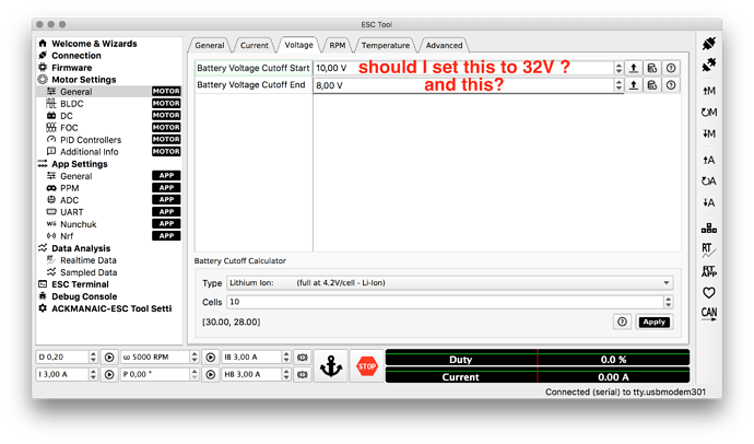

  • My 2nd: what about Battery Voltage Cutoff Start?

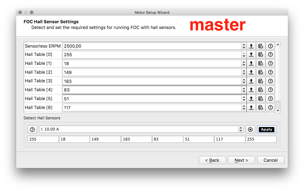

Is it necessary to fill in motor poles? How to know how many?

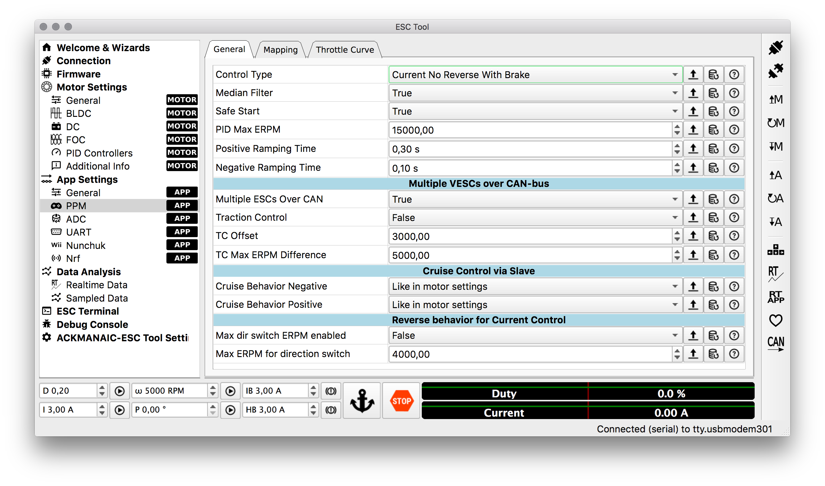

PPM settings:

Just hit the “apply” button here.
I was thinking that lol
So 10V cutoff start and 8V cutoff end is a good value, Bill?!
Edit: no I see now it is 30V and 28V
Noooo. But I see you edited. If you click the “apply” button, it fills in the values for you.

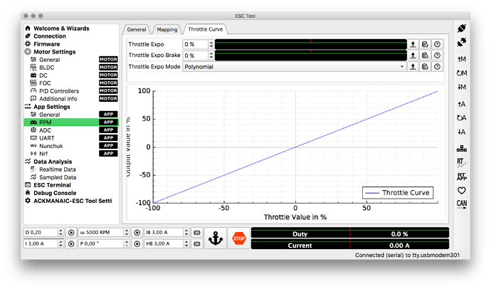

now throttle curve is probably interesting for me, @BillGordon ?
Not necessarily. I wouldn’t mess with it unless you feel you’re really missing something.
@BillGordon :see_no_evil: why did one of my motors decide to not turn anymore after editing some of the above … I see a slight move when I hit the remote trigger, but only slave is turning (CANBUS)

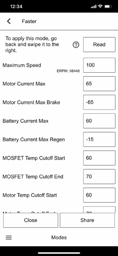

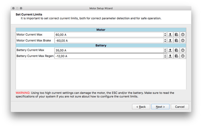

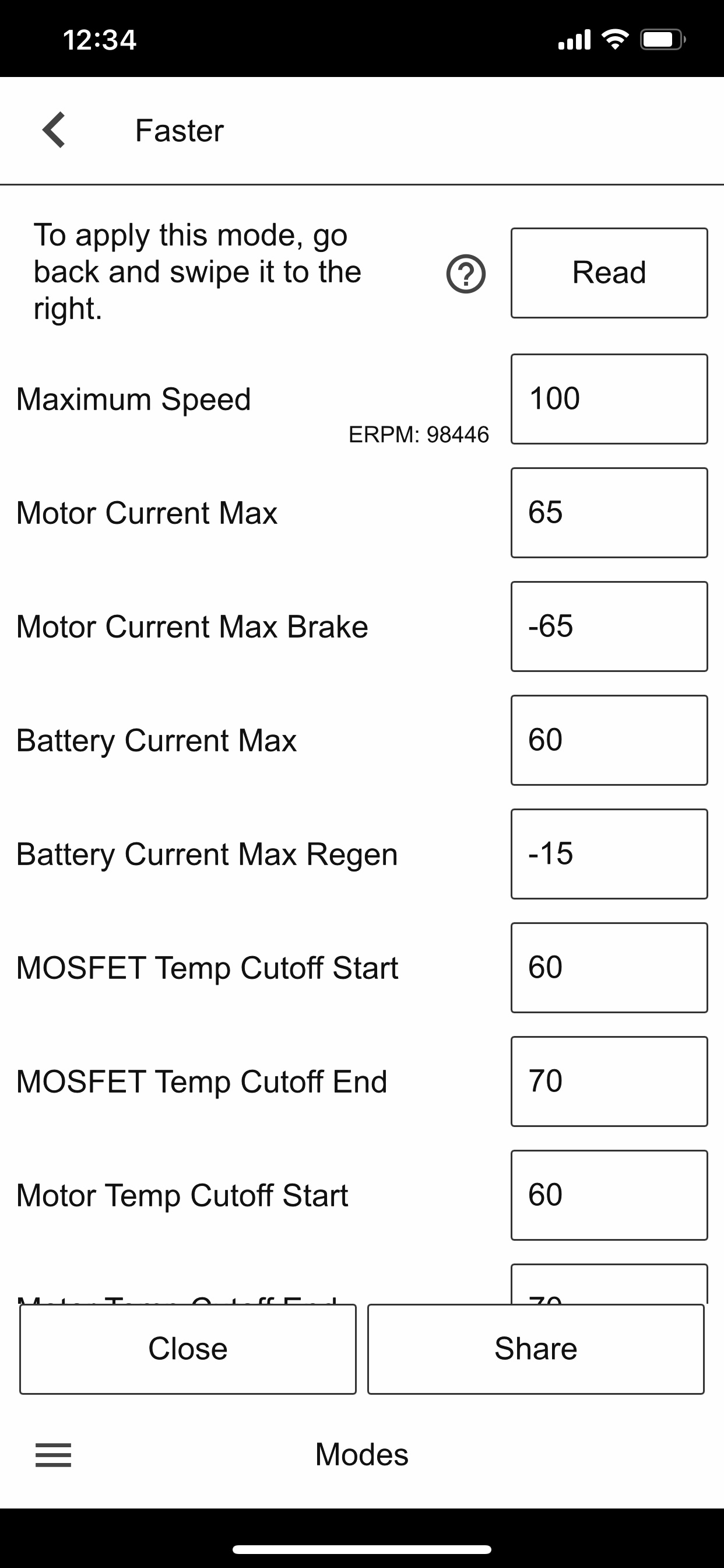

Hi, Ive got a 12s5p Q30 pack. And my motors can take 65Amps. Can my battery handle the 65Amps current? Or should i leave it on 60amps? Could someone explain the math to me aswell.
Posted a pic of my metr pro mode, and im also using the unity.
if you bought it from someone who knows what he’s doing “don’t fix it if it ant broke.” otherwise
suppose your battery cell can handle 20a (only for a short while)
then 100a is the max you should have going out. (to be somewhat safe)
So I’d set battery max at 50 and motor max at like 65a (per vesc)
That’s just how I’d run mine.
12s = 12(4.2v) = 50.4Volts
5p = 5(20a) = 100amps
other limitations may include wiring and cell welding for those reasons it’s good to play it safe.
It looks like my board does the same max speed on all three speed settings (VX1) :thinking: (video is not really showing that, just to illustrate the speed it says)
the vx1 doesn’t limit max speed, it changes the acceleration curve
Ahaaaah … my other board does speed limit with the settings
Additionally with no load on the board all settings will look the same.
Once you hop on it you will be able to tell the difference.

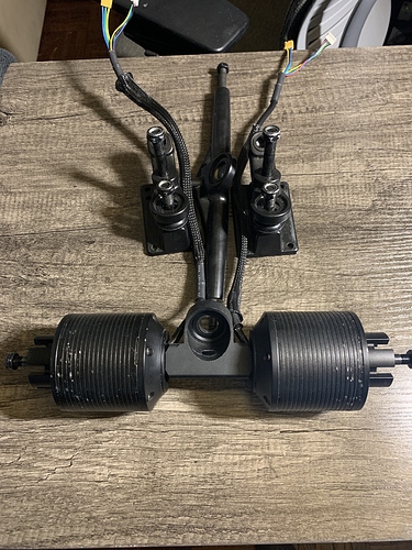

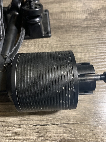

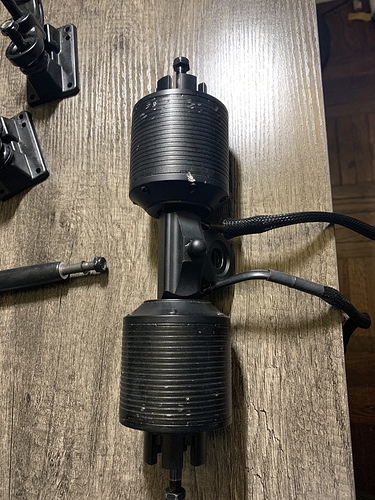

Can someone let me know if these are eLofy DDs. Took them off a Oneboard (I think that’s the name) a while back. Been sitting around, just wanted to be sure.
@BillGordon taking you because I have a feeling you might now for sure since I think you have some?
Thanks.
