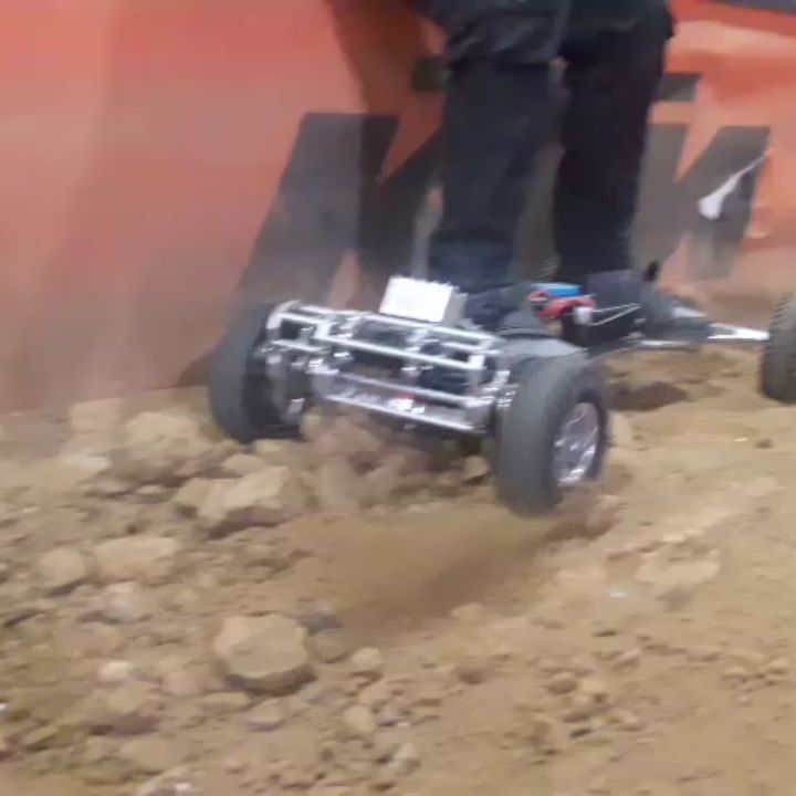

so then, my quest for wheelies on take-off has finally begun :smirk:
Number 4 :slight_smile:
in his defense - he already hat a cut after 200m through the sharp pulley
aww cmon, its still fiiine :innocent:
is it?
