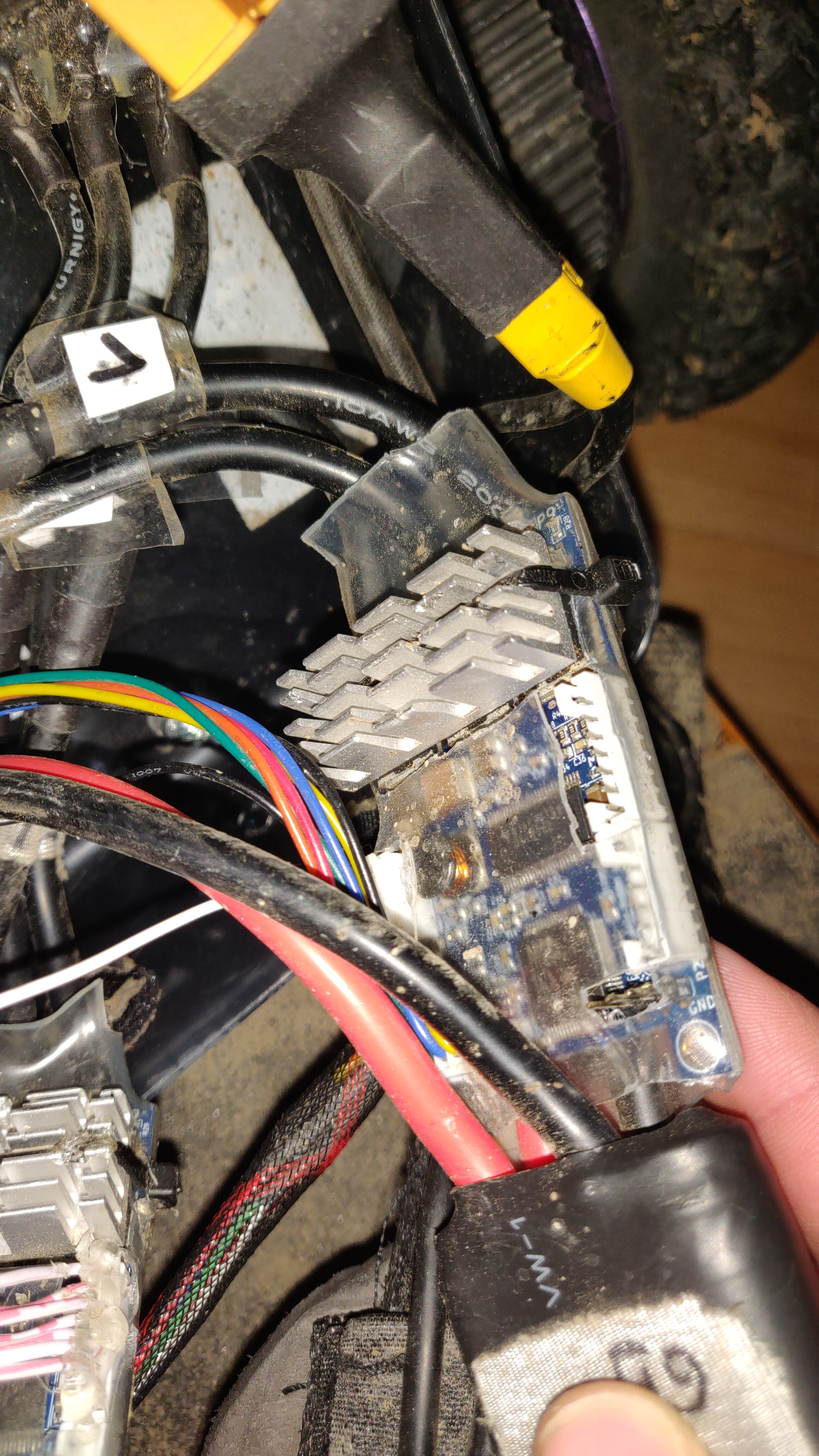

guys, any hints where i should look if i want to buy alu cases / heatsinks for flipsky 4.12 controllers in eu ? doesnt matter if 2 single or one double

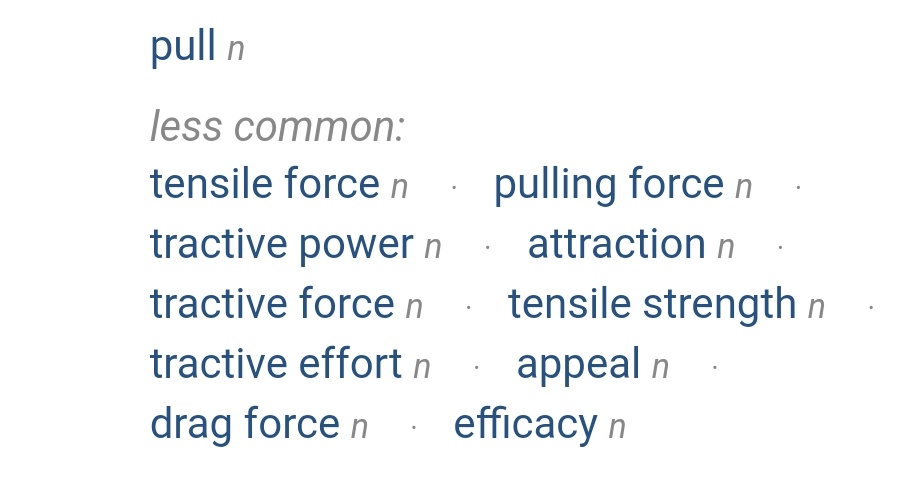

Does anybody know how to calculate the “Zugkraft” that the belts are dealing with?
In this case 15/72t 100kg 480mm belt (might have to ignore the wheels in this case)
Zugkraft = ?
if you’re trying to google english language resources, search for allowable working tension @xsynatic
yeah that didn’t help me finding what i need. :smiley:
I need a quick and dirty way of telling somebody what tension/strength/force whatever my belts are dealing with. Much like our esk8 calc.

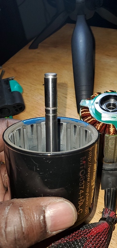

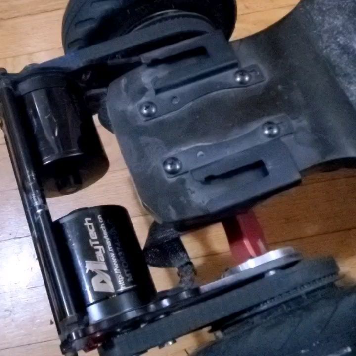

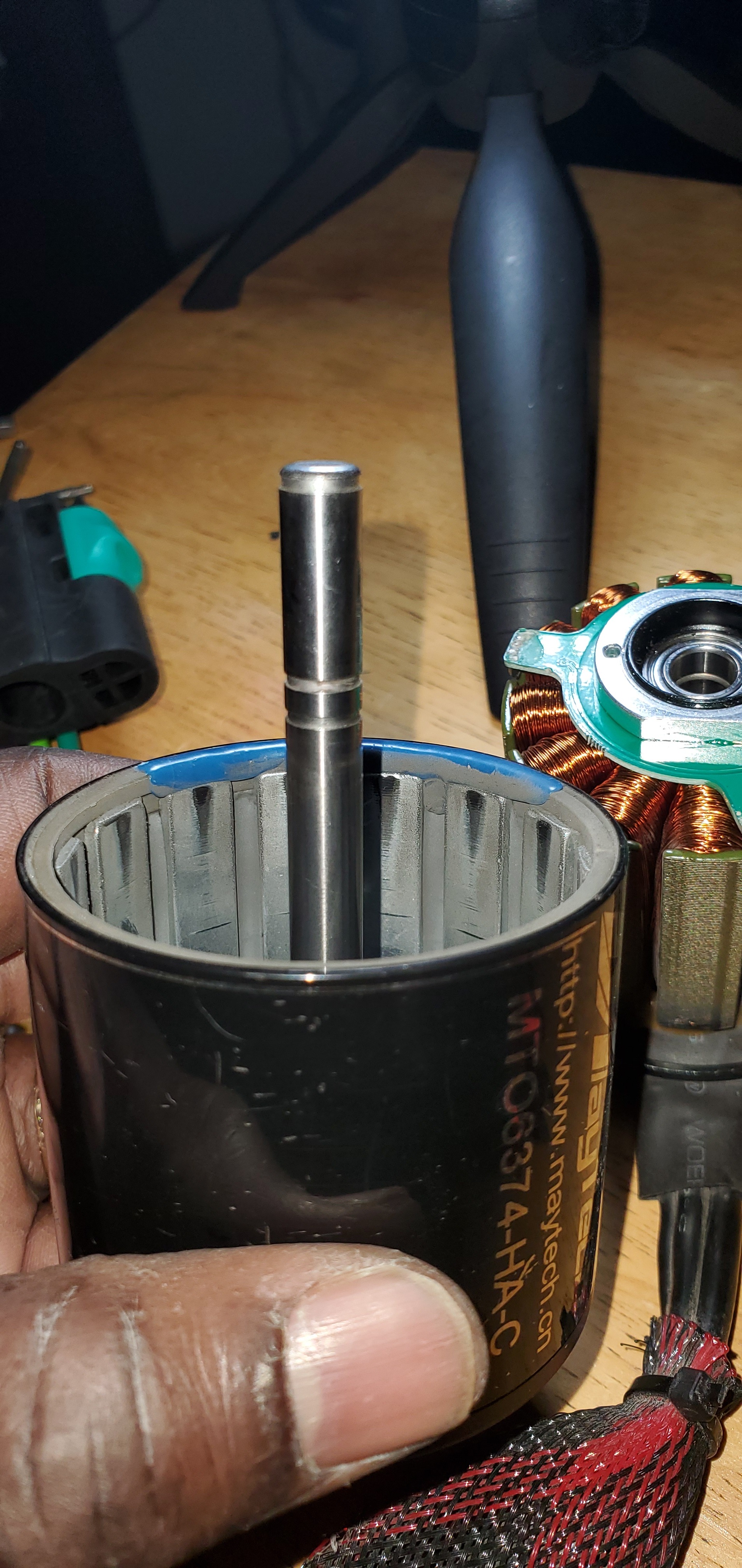

I’m getting the same noise @Coreywolf has from Maytech MTO6374-HA-C. The scratch was from a while back (support bar). I just started hearing this noise maybe a week ago thought it was Idlers/bearing swapped those out…no joy

My dictionary gave me “tractive force” for “Zugkraft”

Reference-design 4.12 controllers have no good place to put heatsinks for good effect. They dump heat right into the pcb from both sides, and no matter what kind of heat sink you put on, no matter where, you won’t get much of an improvement. It’s just how they were made.
I’d suggest looking for motors that have a skirt bearing to support that end of the can, such as the Turnigy SK3 and SK8, as well as some other “long and skinny” motors like the 5095s I saw floating around a while back.
If not that, it might be worth trying to go more for a “pancake” motor - Basically you want the can to either be supported, or not need support due to being shorter.
It’s one of the flaws of the outrunner motors we mostly use: On most, the rotor/can is only supported by on one side, and only then by a fairly skinny shaft. There’s a lot of mass there on the end of a significant lever. Serious bumps/impact or poor balancing can easily overstress that single support point.
