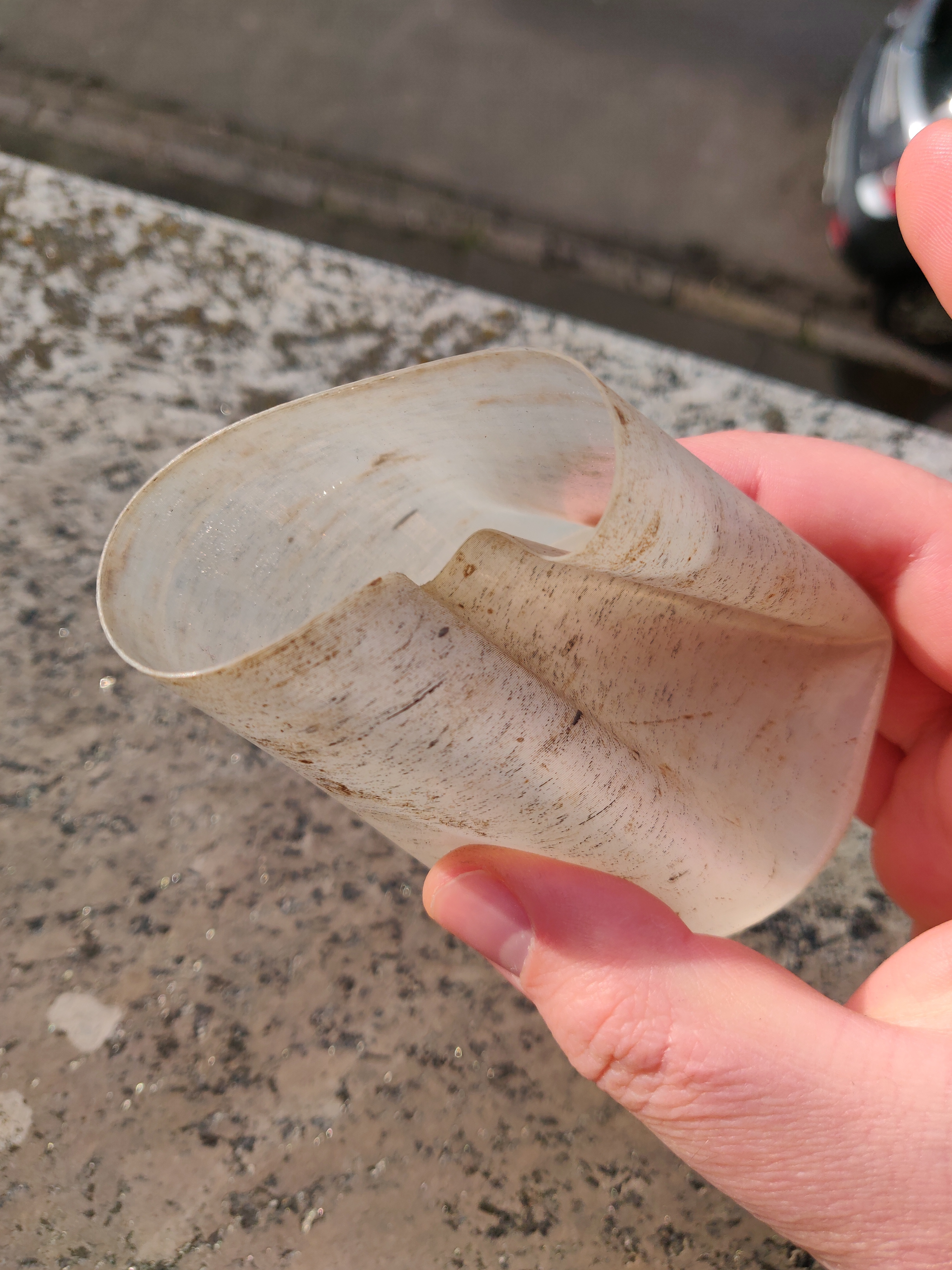

I want to 3d print sleeves that go completely over my motor (to prevent debris and water from getting in)
I’m concerned about the slots that are in the motors, would this mess up cooling?
I printed myself sleeves a year ago, thats still the first set, no cuts or anything broken. Printed with flexible TPU in the mode ā€œSpiralise outer contourā€ (Vase mode) The motors definitely see an increase in temps but thats by all means not a huge margin.
Color is black because i only had white at that time.
I usually put them on if i know it gets dirty,muddy,wet or rocky. They just slide on and off.
What tolerance did you use? I’m thinking just making the diameter 51mm for my 50mm motor so it slides on easily
the torqueboard motors (6374) have a outer diameter of roughly 63.80mm The file i have from the sleeve is 64.14mm with a line width of 0.4mm, so technically 16mm per side (but somehow that sounds a bit much).
Can’t say 100% because i used different slicer settings back then.
I printed several prototypes to get the best fit.
