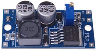

Anyone here know of small buck converters that step down 60v to 12v @~15A?
Depends on your definition of “small”, and what your budget is, I’d say. I know of several converters that will handle well in excess of 60v, but the output current is significantly different between the different models.
This ridiculous thing, for example, far exceeds all your requirements (except maybe minimum input voltage), but it costs $400+.
What do you need 180 watts of 12v power for?
I assume 60v is your maximum input voltage. What’s your minimum?
Not 15A but if it’s discrete loads you could use one of these for each light/whatever/thing you’re trying to drive
CV only with mount holes: (14S max)
CC/CV wrap in foam and toss in there (no mount holes): (14S max)
I use both of these for all my board lighting needs
CV = constant voltage
CC/CV = constant current until set voltage is reached, then constant voltage
