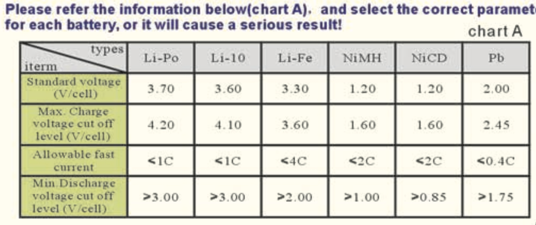

The user manual for for a tenergy TB6B had the following chart in it:
I’m confused about the Li-IO max charge cutoff of 4.1v/cell. I thought Lithium Ion batteries were charged to 4.2v cell. and further that some BMS don’t start balancing until above 4.1v/cell.
what am I missing?

Also LiFePO4 charge cutoff should be 3.65V not 3.60V
