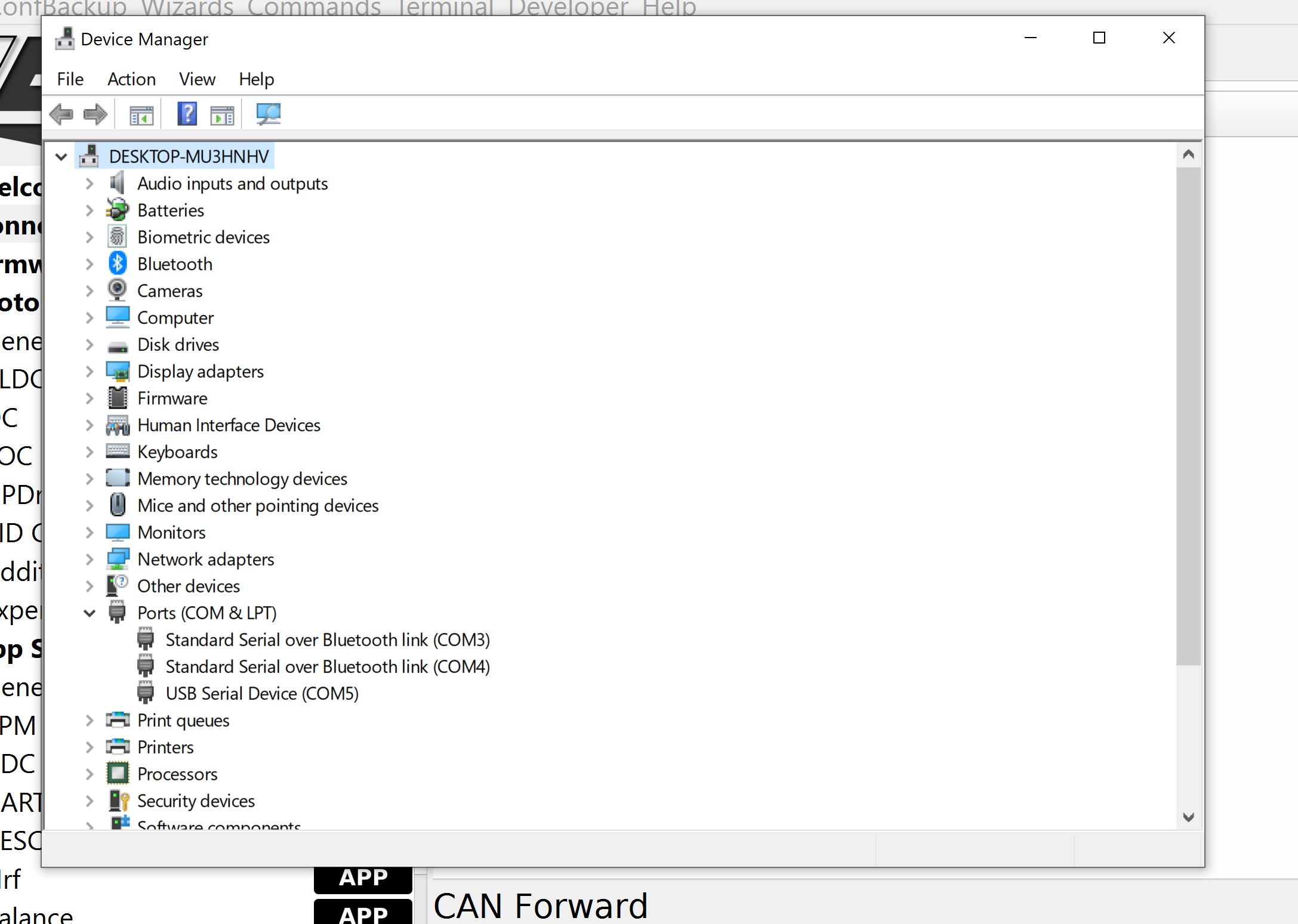

Is it the one that says “no firmware read response”
and then says “Could not read firmware version. Make sure that the selected port really belongs to the VESC.”?
I am attempting to connect over COM3 on a tb vesc
This has been causing me problems for a few days now and I still cannot figure it out.
I reflashed the firmware with VESC_default.bin successfully using an st link v2.

did you try uninstalling the com port via the device manager?

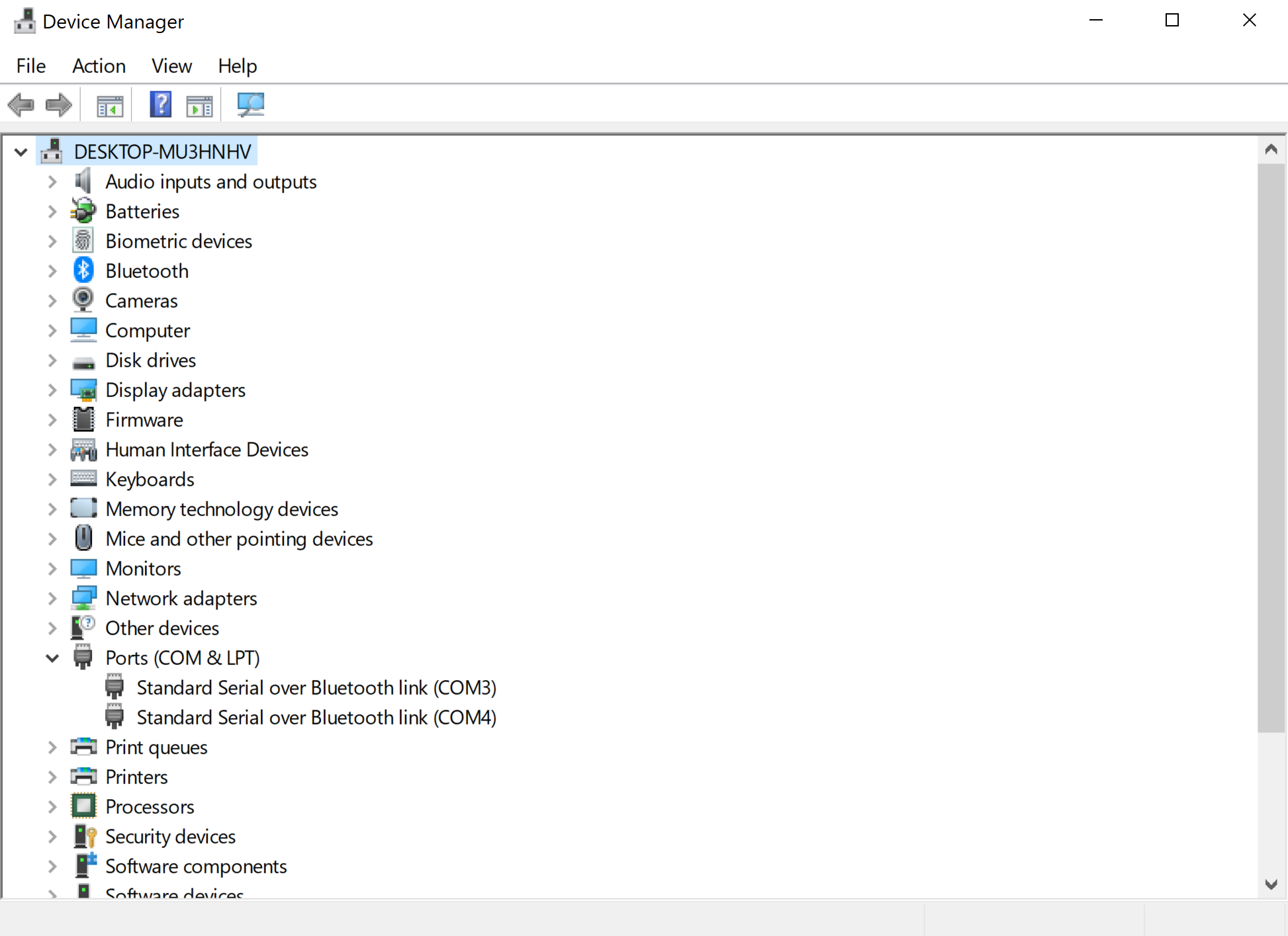

which com port should I try uninstalling?
Currently in my device manager (while plugged into the VESC) I have:
While not plugged in I have:
What should I try deleting?

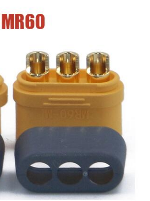

MT60 or MR60 or keeping 5.5mm
MR60
MT60
Keep 5.5mm bullet

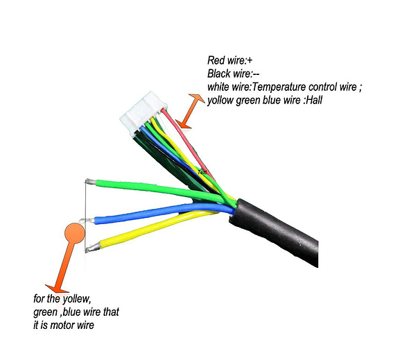

Just wanted to check but the sensor port is backwards right?
This is how my motor sensor plug is on my motors but it looks like it’s flipped the other way?
Edit: Got it confirmed by someone else too but yeah motor sensors are backwards haha

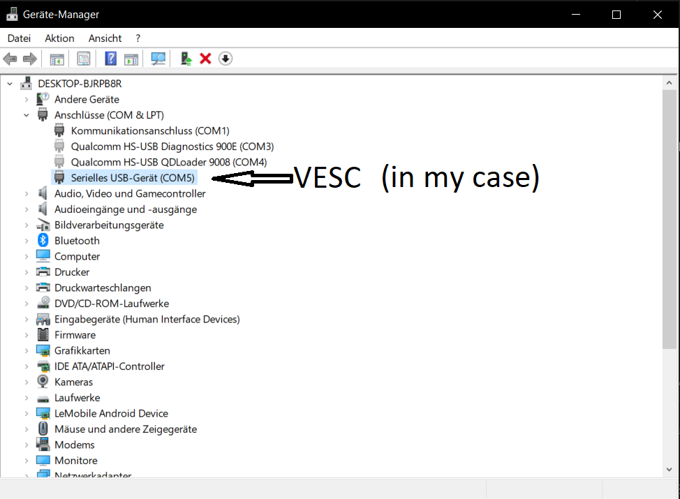

Do you know if you usually use com3 or com4? if you always have used com4, you should try uninstalling that.
I always use com5 but have com1 too (uninstalled com5)

I do not remember which one I normally used as I have not used the tool in awhile.
Should I try uninstalling all 3 of them?

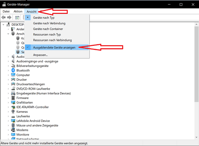

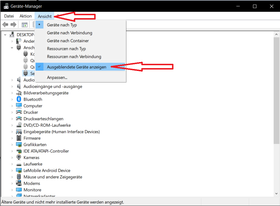

before uninstalling, go into your device manager and click the tab “View?” and choose “show hidden devices”
after refreshing, open the COM tab again and look for serial USB device. That COULD be your vesc.
russoa20
February 14, 2020, 11:18pm
10277
I think you may be right, I believe that is it
It will only appear when the vesc is plugged in.

Alright so this is something I would have never expected…
What I did was go into bluetooth on my laptop.
I uninstalled my airpods and wireless speaker from my known devices.
Restarted my laptop.
When I rebooted vesc tool, I now had the option to connect over COM 5, and now all is running smoothly.
Thank you so much for your help!

I just added sensor wire to my board, I ran and applied the detection, and changed to “hybrid mode” on bldc.
Would there be any reason I am not getting any motor temperature information?
xsynatic
February 15, 2020, 12:22am
10286
What Motor do you have? It’s possible that your sensor doesn’t contain a temp sensor (my TB 6374’s don’t have them for example)
russoa20
February 15, 2020, 12:23am
10287
oh no kidding, I am running a TB 6374… I thought the motor had temp sensors
