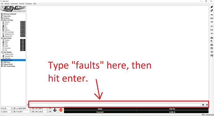

In the small input box above the anchor if you type faults and hit enter does it give any feedback? Also if you hit the RT app button on the right then go into the application tabs using the left nav do you see control input values?

i dont find the box to type

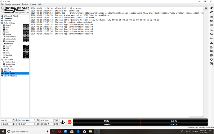

My bad on left nav go to terminal you were looking at debug panel there
this is the fault she give ,me
i think , the problem is the remote , the settings is ok , i donā€™t find another solution
i try in the ppm , and nothing , i think the receiver
is dead or the remote
