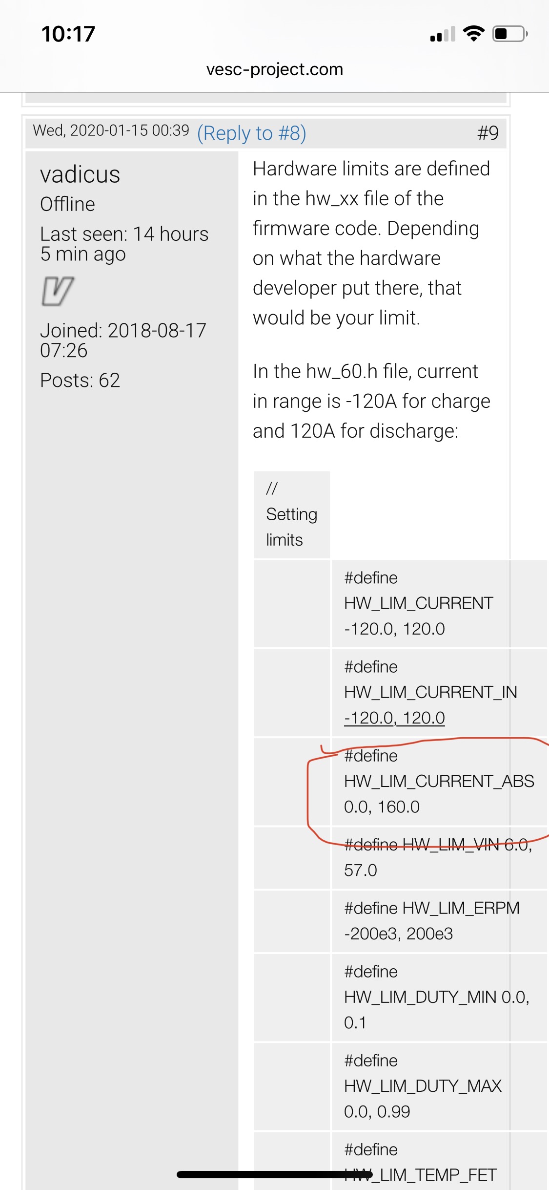

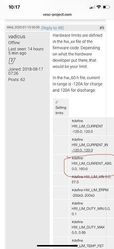

To be clear, I am using mini VESC 4.2 from Flipsky
I will try an older version of ack and see if that makes a difference
Actually, is there a way I can simply bypass the limit?
to be clear i’m talking about the circled parameter which typically isn’t user accessible unless you modify the firmware:

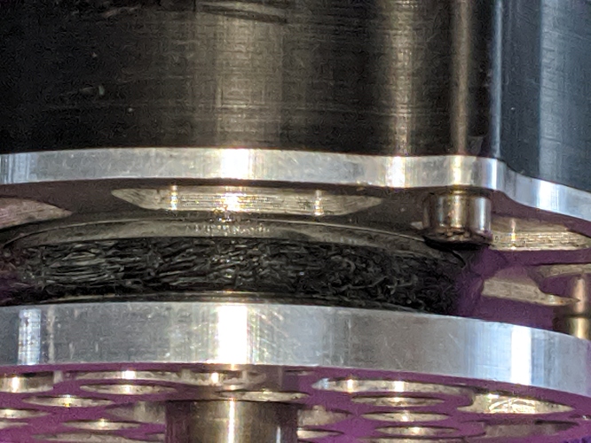

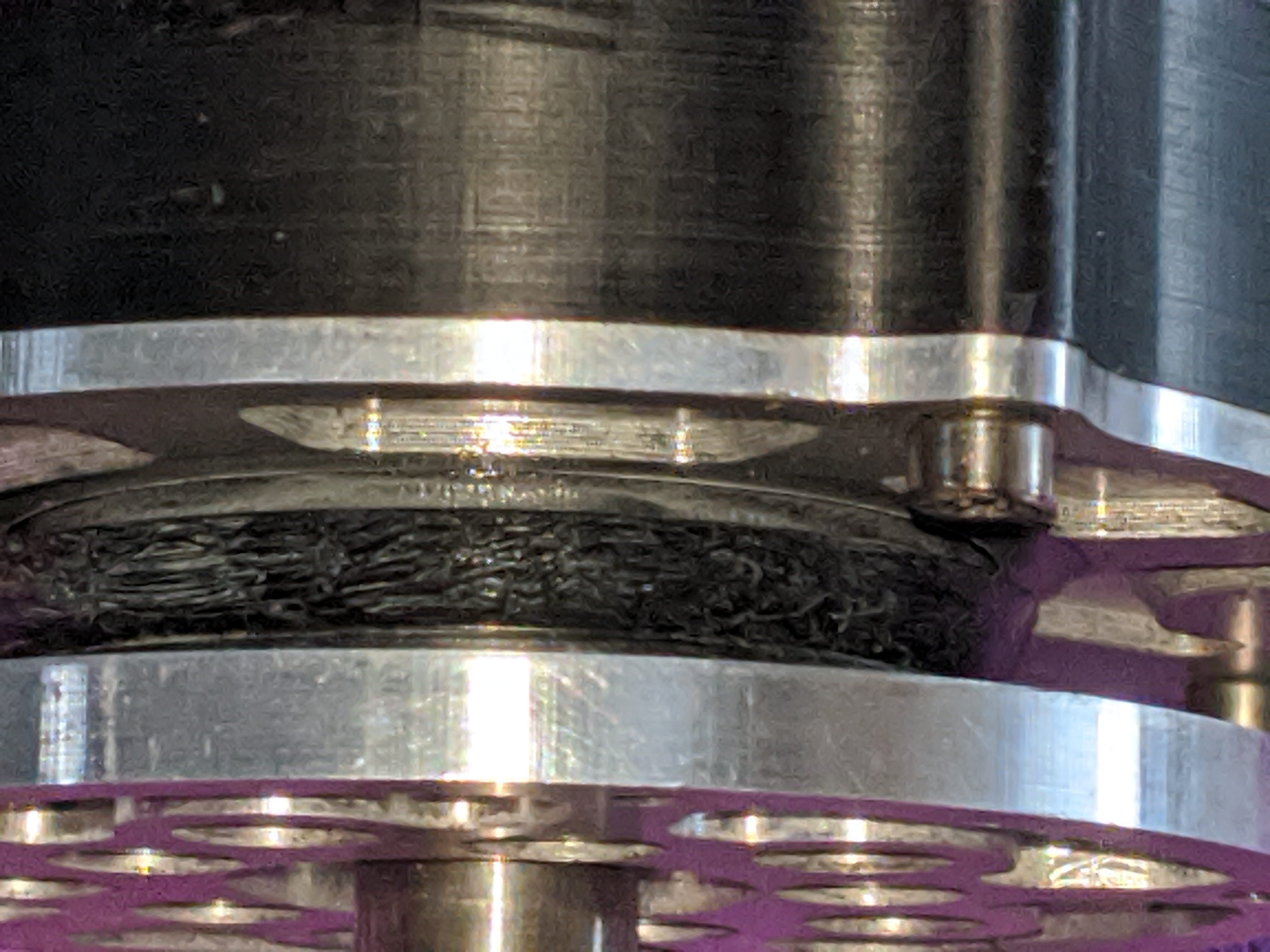

Is this v-ring the wrong way 'round? Is the narrower edge supposed to face the gear drive, or face the wheel?
